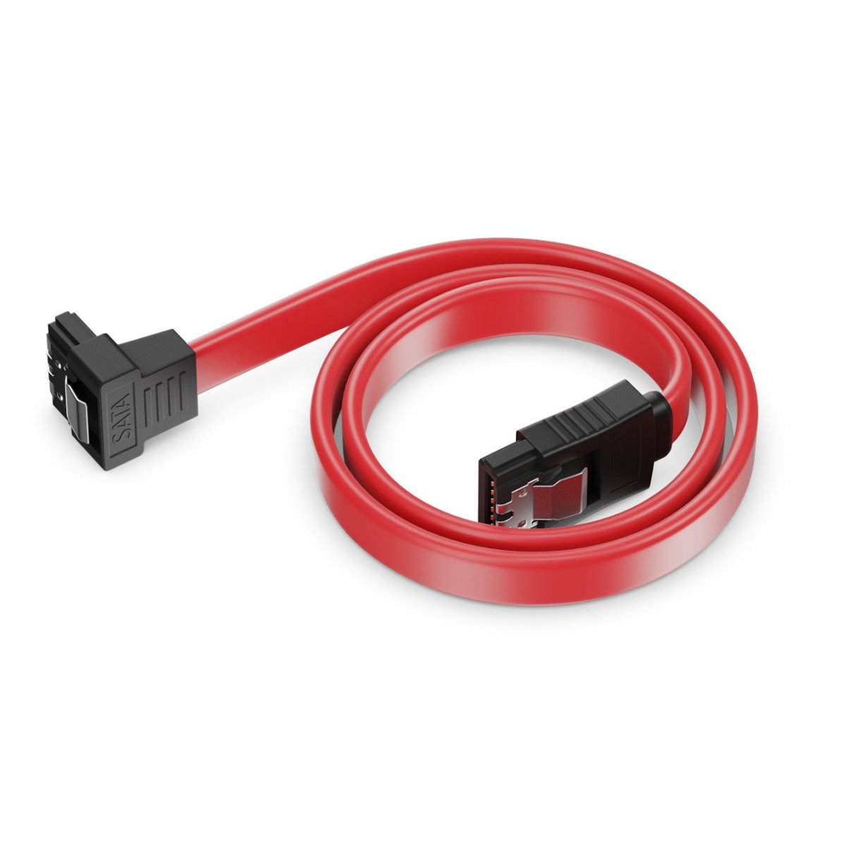

I'm running cables like the one attached.
blkid doesn't return anything. Maybe because I'm running long SMART tests on all drives?

Those cables should be fine but you never know. So if you have a replacement on hand just for testing I would swap them at least on the failing drive.
blkid result is empty or you getting message that command does not exist? I just realized that you are on Core and blkid is usually available on Linux systems (like Scale) although there is FreeBSD version. I don't have Core system to check anymore so sorry for the confusion. You can try 'gpart list' but I'm not sure right now if it will return the value you got from the allert.
