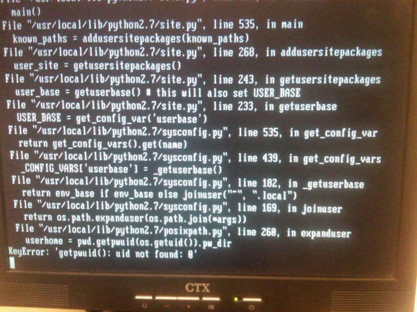

Hello All,
I installed Freenas 8 on a retired desktop PC to tinker with. I had no intention of placing production data on it. Well it failed today and I find that there are a few items stored on it that I would rather not lose. Any assistance in recovery would be greatly appreciated.
I was in the process of copying data to the device when it became unresponsive. I could not access via the web interface. I plugged in a local monitor & keyboard to find that the machine was locked up. I cycled power and upon restart the boot process moves so quickly that I cannot read all that goes by. I did observe the following:
A message refering to beginning of partition 4 not alligned with???
Multiple: Disk Database Malformed.
And finally I see the screen below and it cycles to the same screen repeatedly.
ProtoSD
Jul 1, 2011
3,348
This is a normal message.
It's possible your Flash disk is corrupt or is failing. I'd just reflash and/or use another flash drive and then do an Auto Import. Your data on your disks should be fine.
