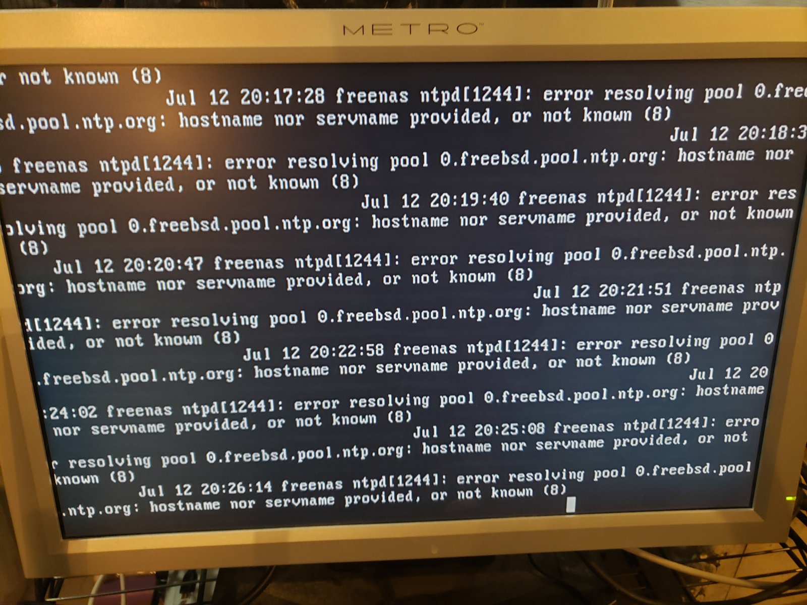

I was able to create a new bootable 11.3 usb and boot into freenas on the system but I end up getting an error. It sits at trying to mount root from zfs: freenas-boot/root/default []...
I went to mow and ended up with this error.
Any idea what I am doing wrong?
Thank you
Samuel Tai
Apr 24, 2020
5,399
It mounted, and needs networking to set the system time. Hit Enter to bring up the 11.3 console menu.

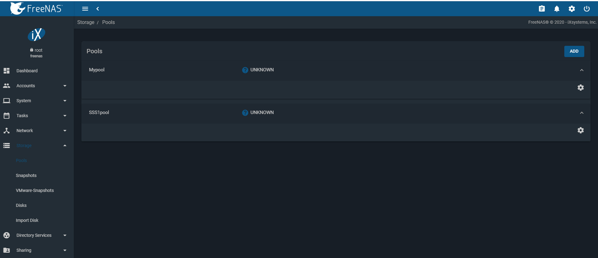

ok
so I am getting that sometimes reported error/issue where the web gui is not immediately accessible after boot.
but that aside, when I go to my pools my pool for my jails and my main pool both say "unknown" and when I go to status it is empty.
Do I need to reimport the pools?
If I go to disks there are there and are "unused"
I go to import pool but there is nothing listed. I assume this is because I did not export the pool.
Is there a guide somewhere to do this (Sorry I googled)
Samuel Tai
Apr 24, 2020
5,399
Did you upgrade ZFS features or version in TrueNAS beta? That's non-reversible.

here is what the pools look like booting from the freenas on the new boot stick, just for clarity (not from what you suggested I do)

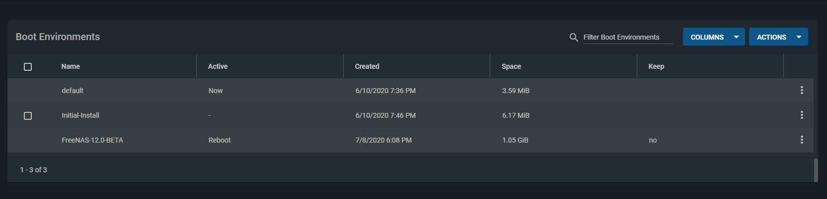

johny3
Jun 10, 2020
26
ok
Looks like we have:
default - active (now)
initial install
freenas 12 beta
if you look it appears that I can do this:
delete the initial install
for the default (active) - i assume this is the one I am using now since it is active - I can chose to keep it.
for the freenas 12 beta - I cannot delete but under keep it says no.
Samuel Tai
Apr 24, 2020
5,399
Yes, click the 3 dots next to your default, and set it to be active at the next reboot. Then you'll be able to delete the 12 beta environment.
