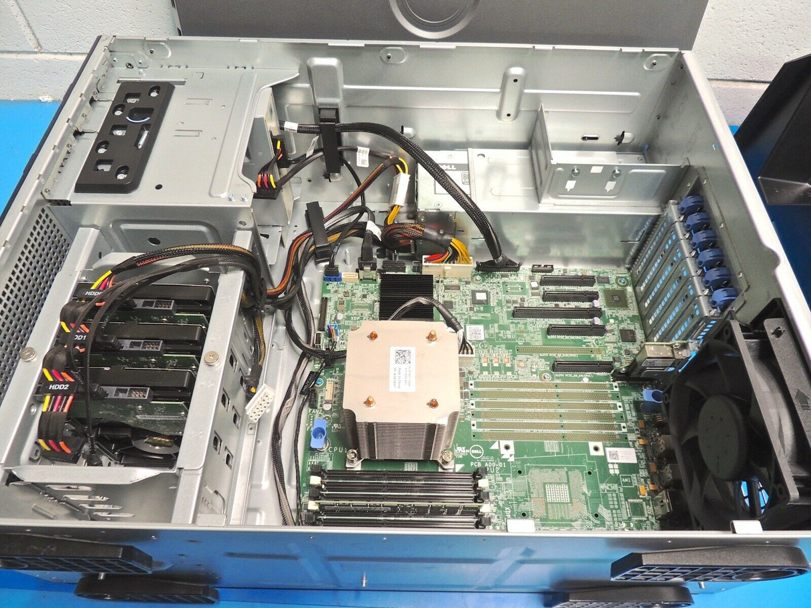

1) I first considered and rejected the idea of running Truenas in a VM on my development system and doing PCI passthrough to the VM so Truenas could manage the disks directly. The development PC has massive memory and cores, but I rejected this idea because of my development uses a bunch of sketchy SW packages running inside docker and somehow these manage to hard crash the host a few times over the past 2 years. Uncontrolled crashes of the host for Truenas is just asking for trouble. Is this reasonable logic or is Truenas resilient with uncontrolled crashes of the host? A single monster server would be really nice.
2) I purchased a used Dell PowerEdge T320 Server Intel Xeon E5-2430 2.20GHz 3x500GB 16GB RAM Win 10 and qty 5 of WL 4TB 64MB Cache 7200RPM (Enterprise Grade) SATA 6Gb/s 3.5" Internal Hard Drive. Is it as simple as swapping out the HD and boot with the installer for Truenas or am I missing anything?
I am assuming I can disable the built-in raid and let Truenas deal with the disks directly.
I am assuming this dinosaur PC has at least 1G ethernet.
I am assuming that Truenas can be configured to backup to dropbox and/or google drive.
Anything else likely to be missing or troublesome?
3) A bulk of the files I will now consider the truenas copy as master and push these to the development PC and to Dropbox/Google Drive. These are safe from corruption because of ZFS build-in checksum. Other files that are mastered on the development pc and backup to Truenas may get corrupted over time by the development system. So I need to develop an integrity check in my app, for timely detection of corruption. When corruption is detected by my app, I need to back up to the previous versions. The millions of files may make this less timely than I like. Does Truenas offer a way to pick a file and view its versions or checksum over time? For example: I know files /a/b/c/d/e/f.data is corrupt, do I need to check snapshot by snapshot or does Truenas offer a way to jump to the snapshot with the previous changed version of a specific file?
I am a complete newbie to Truenas, so please feel free to correct my terminology and offer any insight that may help me.

Welcome to the forums, and sorry for your problems.
We do not recommend running FreeNAS or TrueNAS as a VM for production purposes. While it is much less risky to do so now than it was eight years ago, this is still an area where you are introducing unnecessary risk and ambiguity. Please do read the linked article.
However, virtualization still has a lot going for it, and there may be cases where it is acceptable or even prudent to do so. This article discusses some of that.
As the author of both articles, and also the person who's probably provided the most help to would-be virtualizers on these forums, you can read something into the setups here, which are for business. We do have most front-line FreeNAS as virtual instances with PCIe passthru. Anything important is at a minimum replicated to another instance, which may be a bare metal install in some cases.
TrueNAS is "resilient" to certain kinds of uncontrolled crashes, especially where such appears to be similar to a bare metal failure, but there are other virtualization failure modes which can just result in strange crap, lockups, etc.
No, If it has built-in RAID, that needs to be removed, and replaced with an HBA. See this article. Absolutely nonoptional for critical data.
I didn't see mention of anything for boot media in there. TrueNAS expects you to have a separate boot device, preferably SSD or SATA-DOM.
That's not a dinosaur. It'll be fine.
I don't know about the Dropbox or Google Drive stuff. Generally, those are VERY small storage spaces.
It's probably best to back up to an offsite FreeNAS/TrueNAS host if you can manage it, perhaps at a family member's house. Alternatively, commercial services like rsync.net and Backblaze have been reported to be viable options.
No. ZFS checksums are built into ZFS itself. On a properly designed system, it is not possible for ZFS to return corrupted data ("bitrot"). Each block written to the filesystem includes a checksum, and upon a read failure, ZFS automatically fetches the redundancy (from the other side of the mirror, or other disks in RAIDZ) and rebuilds the block, and writes it back to disk.
There are arguable edge cases such as on systems without ECC memory, where corruption can happen in memory, so for full data protection, ECC is required. Some people desperately wish for this not to be the case.
ZFS offers the ability to snapshot a dataset or pool, which locks the contents at that point in time. If you do not have a lot of chaos in your stored files (such as constantly rewriting, recompiling, etc), it is very possible and practical to create a robust snapshot strategy. Some of our datasets snapshot every fifteen minutes for six hours, every hour for two weeks, every day for two months, and every week for ten years.
TrueNAS does not offer any significant interface to interact with snapshots on a file level, but you can manually go into the filesystem, where the snapshots appear under the '.zfs' hidden directory, and do whatever you need.
I just want to add that ZFS checksums blocks, not files, so there is no shortcut to getting a checksum of a file, even though all the underlying metadata and data is known to be good because it passes the checksum validation.

Make sure your T320 doesn't already have a HBA or PERC controller. If it does you may be able to make use of it, just not the RAID functionality. The common T320 config is 8 x 3.5 inch hot swap drives in front, and these are almost certainly some kind of universal SAS/SATA backplane.
On the SATA drives comment... Understand SAS & SATA drives share an electrically compatible interface, but they speak a different protocol or "language". The difference most people notice is the SATA drives have an open space between the power a data connection on the drives, and SAS drives do not. If you look at the backplane on your T320 you should see that the drives plug into a socket that will accept either. A proper SAS HBA will interface with both SATA & SAS drives. A SATA controller will only talk to SATA devices. If you're planning on using the 8 x 3.5" backplane on the T320, you'll need an HBA that supports the cabling standards Dell used.

The T320 is still in transit, but based on the pictures, looks like cables plug into the back of the drives. The generic description says "Up to four 3.5 inch, internal, cabled SATA, nearline SAS, or SAS hard drives.".
Question 1: From the internet, it said the HBA SAS controllers automatically detect SATA and switch protocol/electrical signal. Is this correct?
Question 2: From the internet, I saw the drive side is different between SATA and SAS. On the cable side, are they the same or different?
Question 3: If the T320 does not have a HBA, does this mean it has a raid controller or is there other options?
Question 4: Assuming the T320 dies, and I replace it with another different server, will the hard-drive be transferable to another server and retain their truenas data?

Ok... I had to do a little digging. I've never seen a 4-drive T320 before. That is in fact a 8087 SAS/SATA port on the MB those drives are connected to. The T320 apparently has a PERC S110 RAID controller embedded on the motherboard, which is an Intel X79 PCH controller. Those are going to be 3Gb/sec SATA 2. The solo SATA ports on the MB are 6Gb/sec SATA 3, and there's probably some boot limitations.
To your questions:
The signals are electrically identical. It's more like speaking a different language. SAS is formal Latin as spoken in the Roman Senate. SATA is a bit less eloquent, more like the communications you might expect at a McDonalds drive thru lane. However, I'm not sure the X79 PCH will actually talk SAS. The spec's imply it, but it seems to be implementation dependent.
They are slightly different, but with a purpose. The SATA drives have a open notch between the data and power connector. SAS drives have this filled in. This is done so you can't plug a SAS drive into a SATA cable. They're electrically identical, no damage would occur, but the SATA controller doesn't talk SAS, so the notch prevents the combination. All SAS controllers will speak SATA, so their cables & back planes allow either to be inserted.
The Intel X79 PCH / PERC S110 is not a true RAID controller. It implements RAID with software help I believe, but some of that will be implemented in the Dell HII/BIOS. I suspect if configured correctly TruNAS will view it as a simple SATA controller, with direct access to the disks. But I'd like to hear one of the other's chime in and confirm. @jgreco or @danb35 any experience?
As for other options: This server was also sold with the PERC H310. You can source one of those for $30 - 50 on eBay, flash it to IT mode, pop that 8087 cable off the MB and plug it directly in to the H310. I use the H310 myself.
The data will be in a ZFS pool implemented on the hard drives. That pool will be able to be imported into any OpenZFS v2 supporting OS, including Linux, FreeBSD, and probably even a Raspberry Pi if you wanted that kind of trouble... But the way you're posing the question makes me want to add the comment: RAID, even ZFS RAIDz2 is no substitute for a back up. If you're contemplating moving pools between machines with data, you're accepting risk. If you're expecting RAIDz2 to save you from anything more than a disk failure, you're accepting a lot of risk.
Thank you for the answers and for spending time to look up the T320.
Clarification: My confidence that a 200$ server will continue to operate reliably is low. So if it works and I get comfortable with Truenas, then I would like to transfer the new disks to newer hardware, possibly the TrueNAS Mini XL. Hence my questions about disk transferable between Truenas hardware. My server data is currently backed up to Google Drive, Dropbox, and a rotation of 3 other detached hard drives. Once Truenas becomes the master, then Truesnas will be back up to these sources.
Follow-up question 1: When the T320 arrives, assuming the Truenas sees the drives, any chances it will still manipulate the disk content so the disks are not transferable to another system with a different hw like the TrueNAS Mini XL?
Depends on implementation, see
I'm too lazy to find the specifics for the server in question, sorry.
The X79 PCH SCU should show up as an isci driver powered device. These work just fine, if slightly limited by the 3Gbps limit. They are known to be fine with PCIe passthru at least on common Supermicro boards.
isci0: <Intel(R) C600 Series Chipset SAS Controller (SATA mode)> port 0x4000-0x40ff mem 0xe7afc000-0xe7afffff,0xe7400000-0xe77fffff irq 18 at device 0.0 on pci3
Powers one of the main fileservers for the office here. One of the really interesting things is that on a 12-bay chassis, you can hook up the SCU to four bays, and an LSI HBA to the other eight bays, and run two FreeNAS instances next to each other doing completely separate tasks.

Actually no, SAS uses a higher voltage to allow for longer cable runs. There may be further differences, particularly for 12 and 24 Gb/s SAS.
True, but a minor difference... More correctly, they're "electrically compatible". It usually doesn't matter. I haven't looked at the 12Gb SAS spec in detail, I need to... I'm pretty sure there will be no SATA IV, so...

Well, "electrically compatible" is probably incorrect. That's a fairly broad term and the electrical engineer in me raises eyebrows and says "not so".
It's not entirely incompatible, and most of the incompatibility has to deal with once you get beyond the 1 meter SATA limitation. Once you get out there, then you do need the higher voltage SAS, and while 1.5M or 2M SATA might appear to work, it is likely to be somewhat fragile and more susceptible to noise and other issues. I would accept "electrically fraught with peril" though. ;-)
SATA beyond 6Gbps is pretty much a dead issue. SSD's rapidly outpaced that and NVMe is the heir apparent. Once the SATA Cabal failed to come out with any meaningful solution and NVMe overtook them, there's just not that much compelling about SATA to drive further development. It will remain as a cheap attachment protocol for awhile for hard drives, while flash storage continues with NVMe. This may spell doom for the 2.5" form factor, as hard drives continue their evolution towards being exclusively for slow mass storage -- the lack of meaningful capacities in the 2.5" world has been somewhat devastating.
