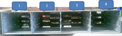

I tried to look up that rack model number, but I can't find a picture of the normally installed backplane. Can you provide a picture of what you have?

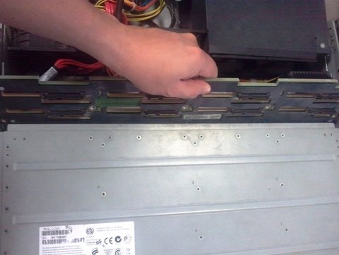

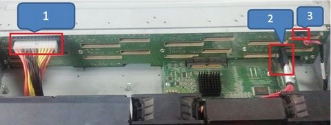

I believe you're all good. If you look at that midplane board, I believe you'll find an SFF-8087 connector on it which is intended to hook up to an HBA or RAID controller. I'm still downloading documents at a snail's pace but my memory suggests this is one of the storage servers that the ServeRAID M1015 was popular in; if one didn't come with your server, you'll want to acquire one, flash it to HBA IT mode, and hook it up with an internal SFF8087 cable and call it a day.
That midplane board should have an LSI SAS expander chip on it which is how 4 channels becomes 12.

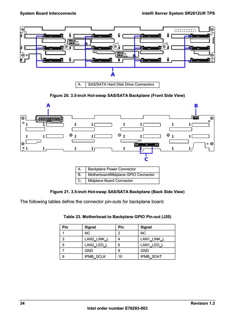

Found documentation for PMC8388, its attached. It is 4 sas chanels at 3gbps.
I've been reading up on sas expanders until my head hurt. It seems like its something standard not something goofy lintel was doing on there own like I ignorantly thought. I was completely unaware of this technology and it creeped me out, now that I understand it a bit more I'm more ok with it. Also if you are accessing three drives in the same arrogation you will be limited to a total of 3gbps not 12. Not a big fan of oversubscription like this if it was 6gbps it wouldn't matter so much, oh well going to have to live with it.
