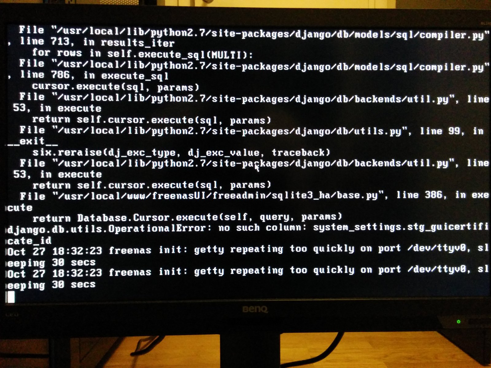

Now, after the system rebooted, it simply would not go any further. I got an error message which is just looping, it went like this:

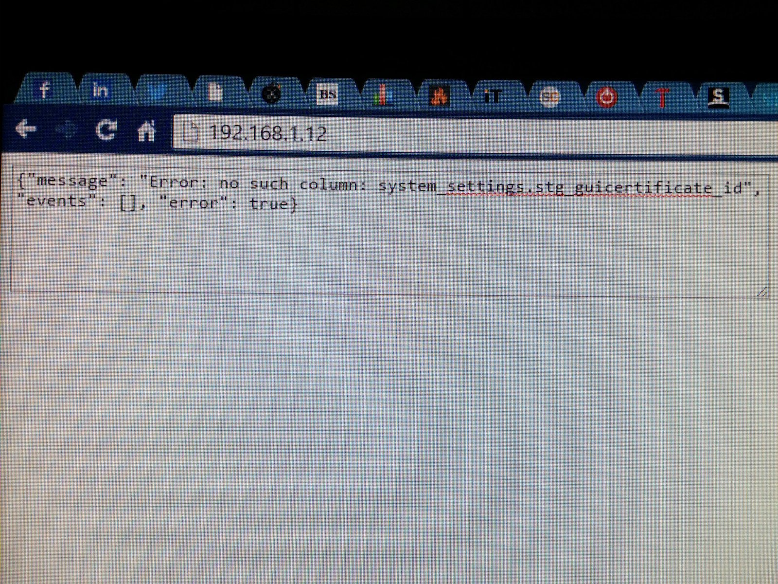

freenas init: getty repeating too quickly on port /dev/ttyv0, sleeping 30 secs (see pic1.jpg)
Over and over and over and over. So I had to read up on this error, someone said it's related to locale, some other people said it's related to the network. So i unplugged the network cable and tried again, but same problem. When trying to access the Web GUI with the network cable plugged in, all I see is some error message:
{"message": "Error: no such column: system_settings.stg_guicertificate_id", "events": [], "error": true} (see pic2.jpg)

Highly unlikely your data is gone. Try doing a clean install to a new USB stick, and see if it will import your pools (just cancel out of the wizard). If it will, then restore your saved backup of your config file (you do have a backup, right?)

The easiest and quickest way to get operational again is to perform a fresh installation and import your pool. You could go poking through the SQLite database, but that's not recommended at all. You might get lucky on the forums or in the chat room on Freenode (#freenas) who can guide you through the not so recommended way.
