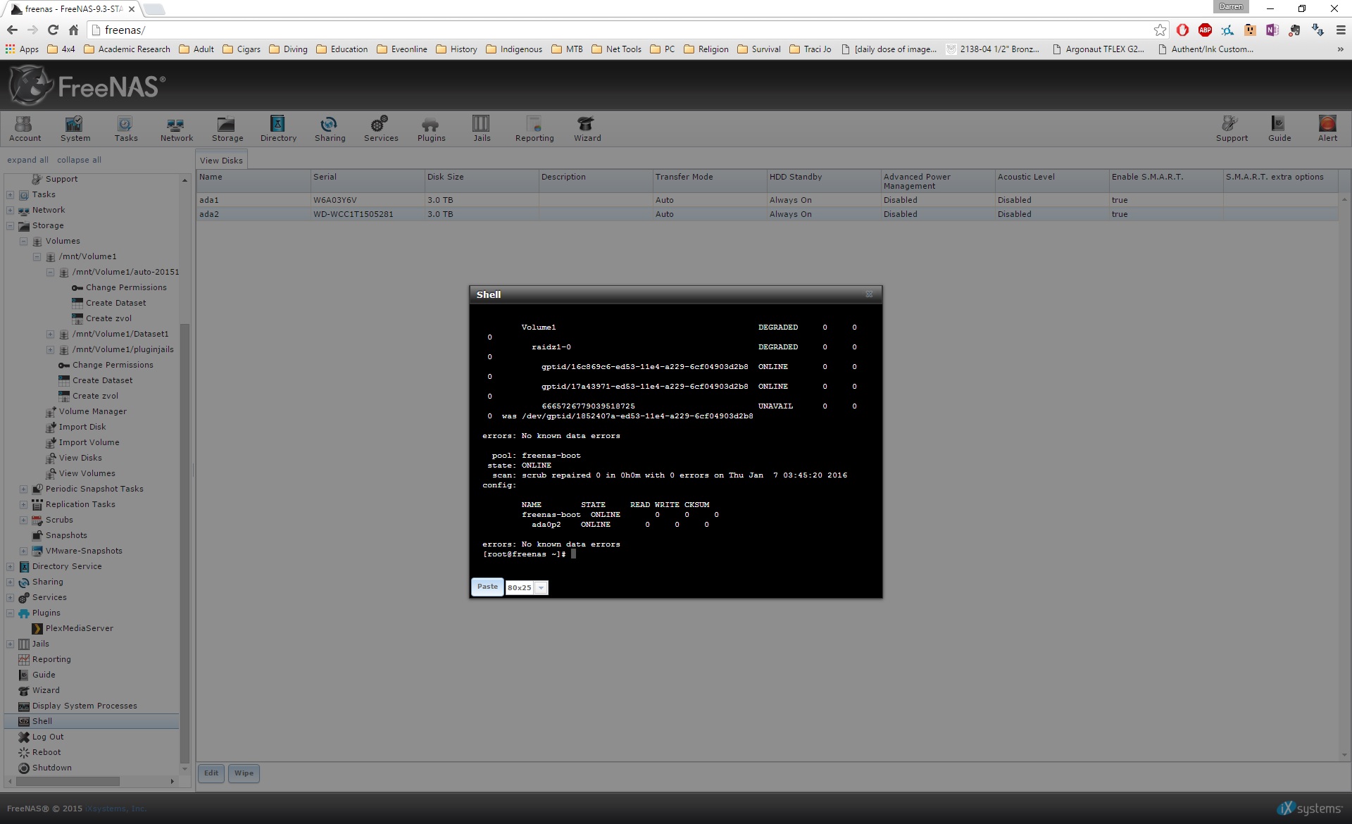

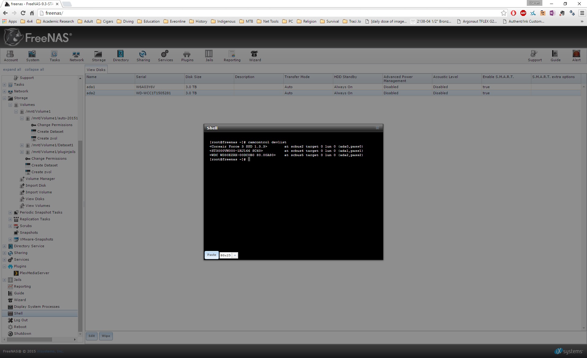

Really sir? That's odd. Please show us the output of
zpool status -v
as well as
camcontrol devlist

Actually I was wrong. I have only three drives attached.

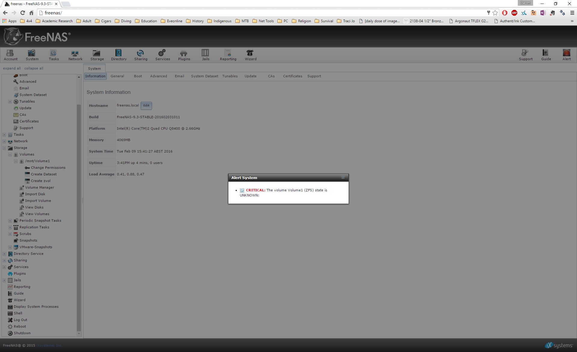

I am getting this message now and the GUI is reporting I have no jails or datasets.
Darren Yorston
Apr 26, 2015
28
After multiple reboots I can now access my share and the system alert is reporting the original error degraded message. Currently in the process of copying off data to a secondary backup.
