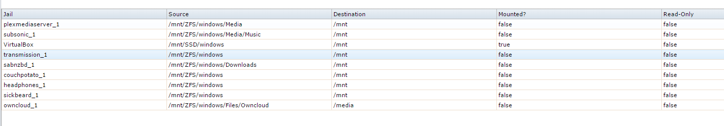

Not sure this is so true, I have just removed an old jail dataset and it nuked my new jail dataset..
To be clear I had set \mnt\SSD\Jails originally but after a complete reinstall I had configured to \mnt\SSD\Jails_2. After removal of \mnt\SSD\Jails folder everything inside \mnt\SSD\Jails_2 disappeared except virtualbox.
