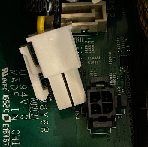

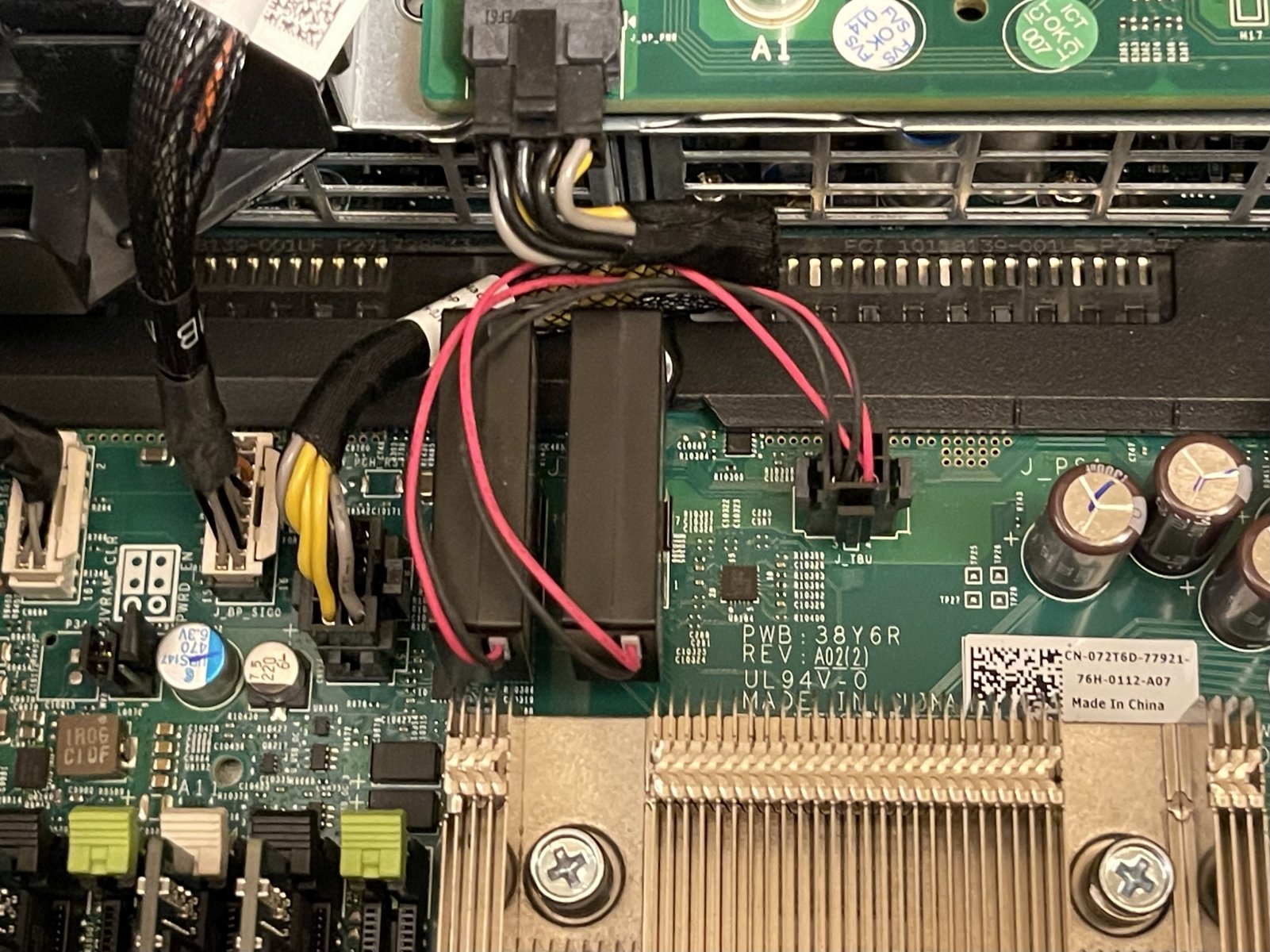

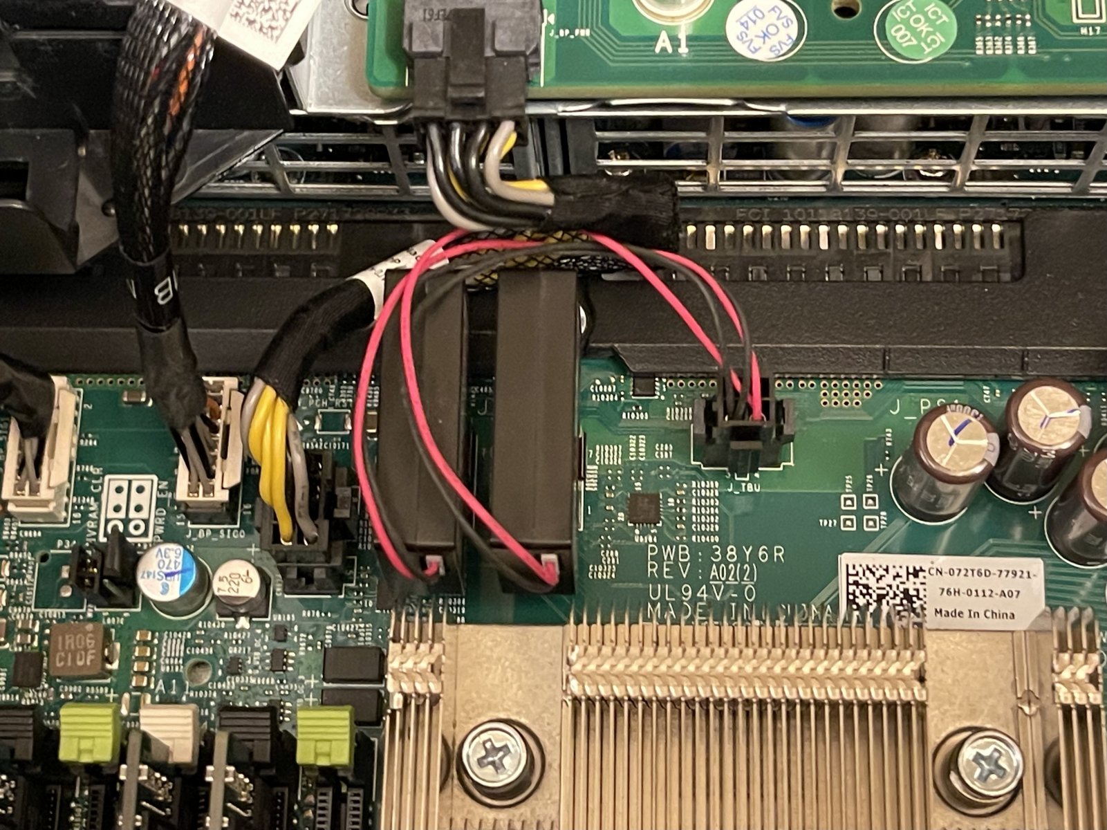

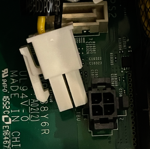

Not even sure how to get the pitch, this is an existing closer pic I took of the motherboard side next to the WRONG connector that doesn't fit(standard molex). but of course the sata doms have a very tiny 3 or 4 pin, thin white plug/connector on them as well. I should be able to get closer pics of both sides of that cable. What's most useful is what I have installed currently, ONE TBU motherboard side, and TWO connectors for satadom both coming out of the same connector. Those wires must be ~28awg, super tiny.
I couldn't find relevant information regarding the J_TBU connector. I doubt it is a standard Molex header. See if you can find any markings on the outside of the header.

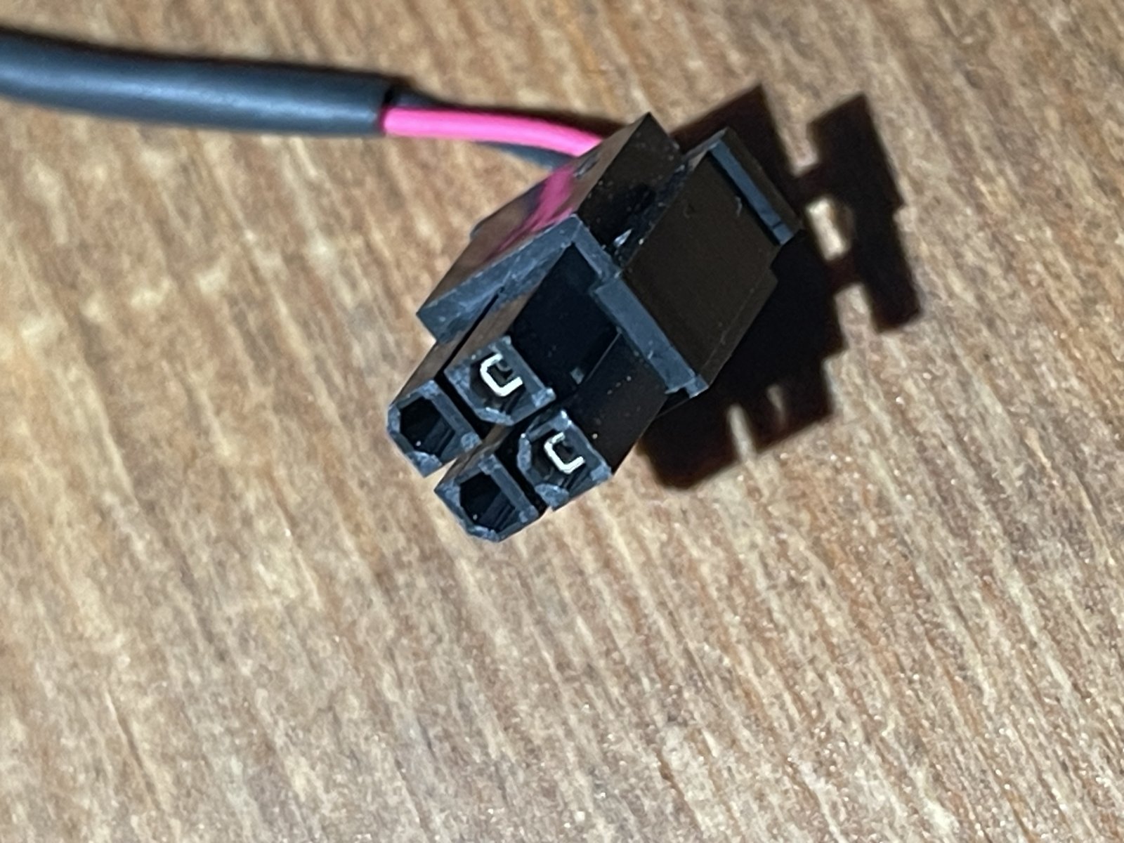

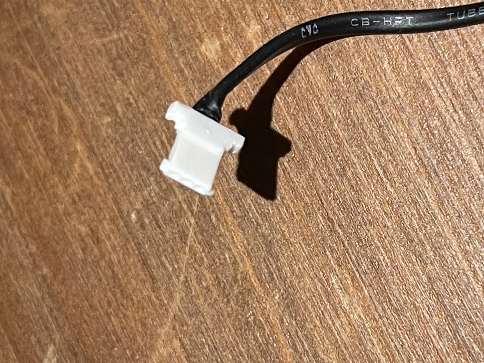

Took a few pics earlier, sorry for giant pics, posting from my phone. I didn’t see any markings. I know it can be used for an optical drive too
I think the following link could be a match:
Measuring the pitch (center pin to adjacent center pin distance) would help properly identify the series.
If you download the datasheet, you can compare with the dimensions of the part.
PS: The crimp contacts need to be added.
You could request free samples from Molex to try them out, for the connectors and crimps.
I will need to look up the white connector.
