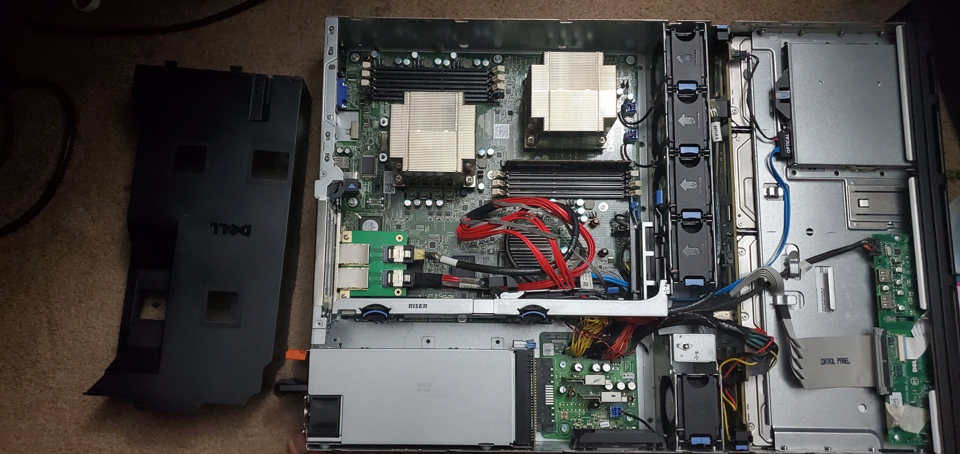

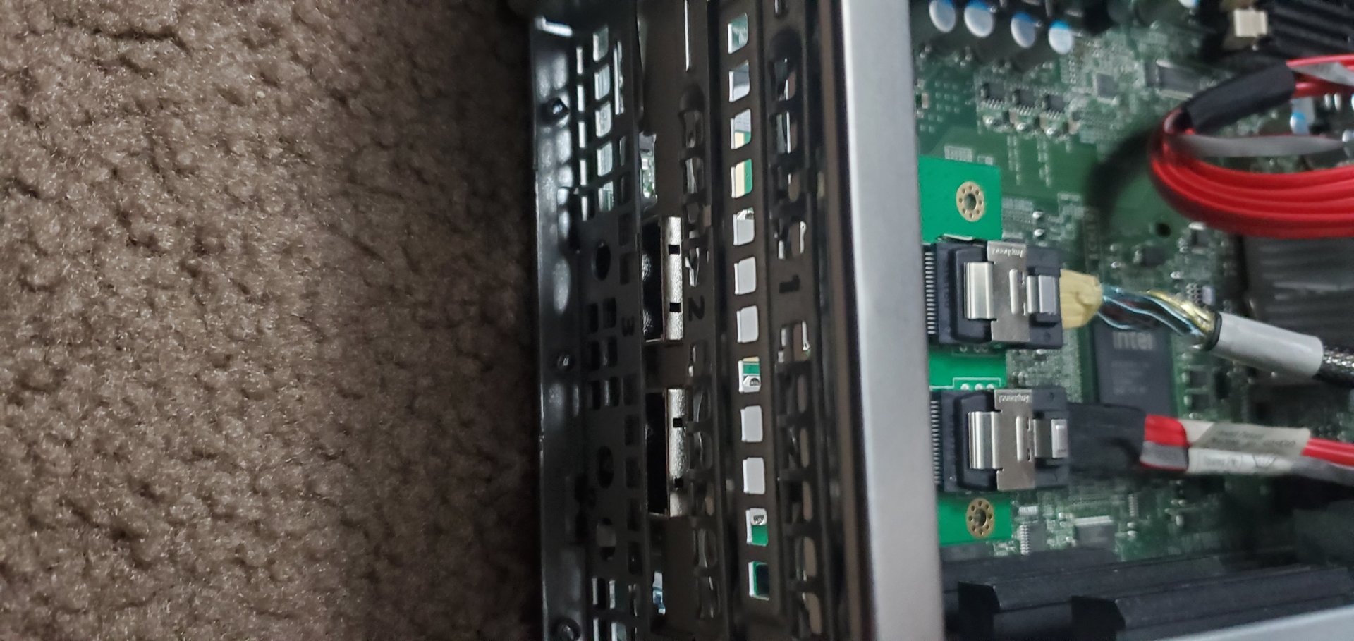

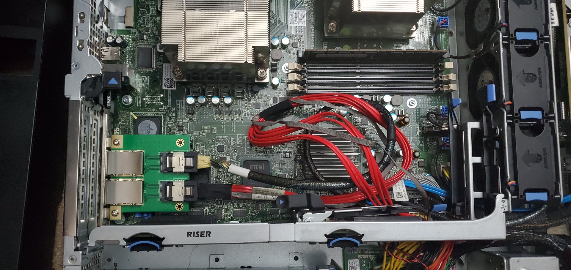

Well yes, this old servers are súper cheap, i got my r510 for $150 but it didn't came with disks or disk trays so I had to add another $300 just on 10 trays (so I can have 2 spares) and 8 2tb disks, plus another $200 trying to find a good option raid card and SPF optical 10gb network card, I had to buy several until I came with the right one. Then I find 2 EMC enclosures very cheap with their 2tb disks because they are format on 510 sector's and no body wants them, so I reformat then on 512 and I had another 2 enclosures with 15 2tb disks each for around $500. I thought after this I was done but I end up finding that r910 for just $275 with 120gb or ram, 4 xeons and comes with 16 bays for 2.5, I couldn't resist and spend that money lol.
So I took the ram on my r510 to end up with 184gb but then I had the problem of the disks that are 3.5 as I couldn't have in on the r910 chassis. So I came up with the idea of using the r510 as an enclosure, I just get 2 pretty long raid card cables, connect them on back plane of the r510 and in to another card that goes on a back tray like it was a raid, network or any other card but it doesn't hook to any pci socket. In the inside goes the regular cables of the back plane and the outside the cables that are use for enclosures, I did the same on the r910 but backwards, connect the cables from the r510 to the r910 and then from the inside of the r910 to a h200.

I want to show you how I turn the r510 in to a enclosure, I had to put a 2GB ram or the server wouldn't stop beeping lol
I am still new to all this server thinks so I want to make a dumb question, I image is not possible but, do you now if there is a way to unite 2 motherboards or 2 servers? So can use the 4 processors on the r910 and the 2 on the r510.
