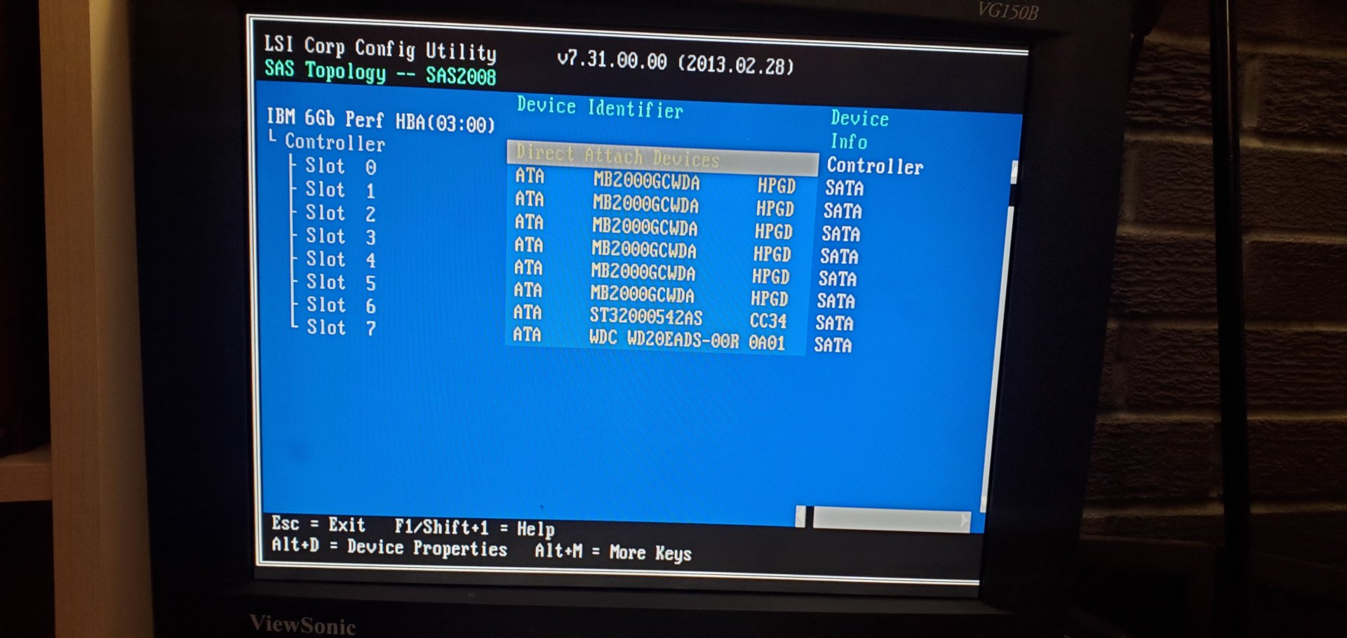

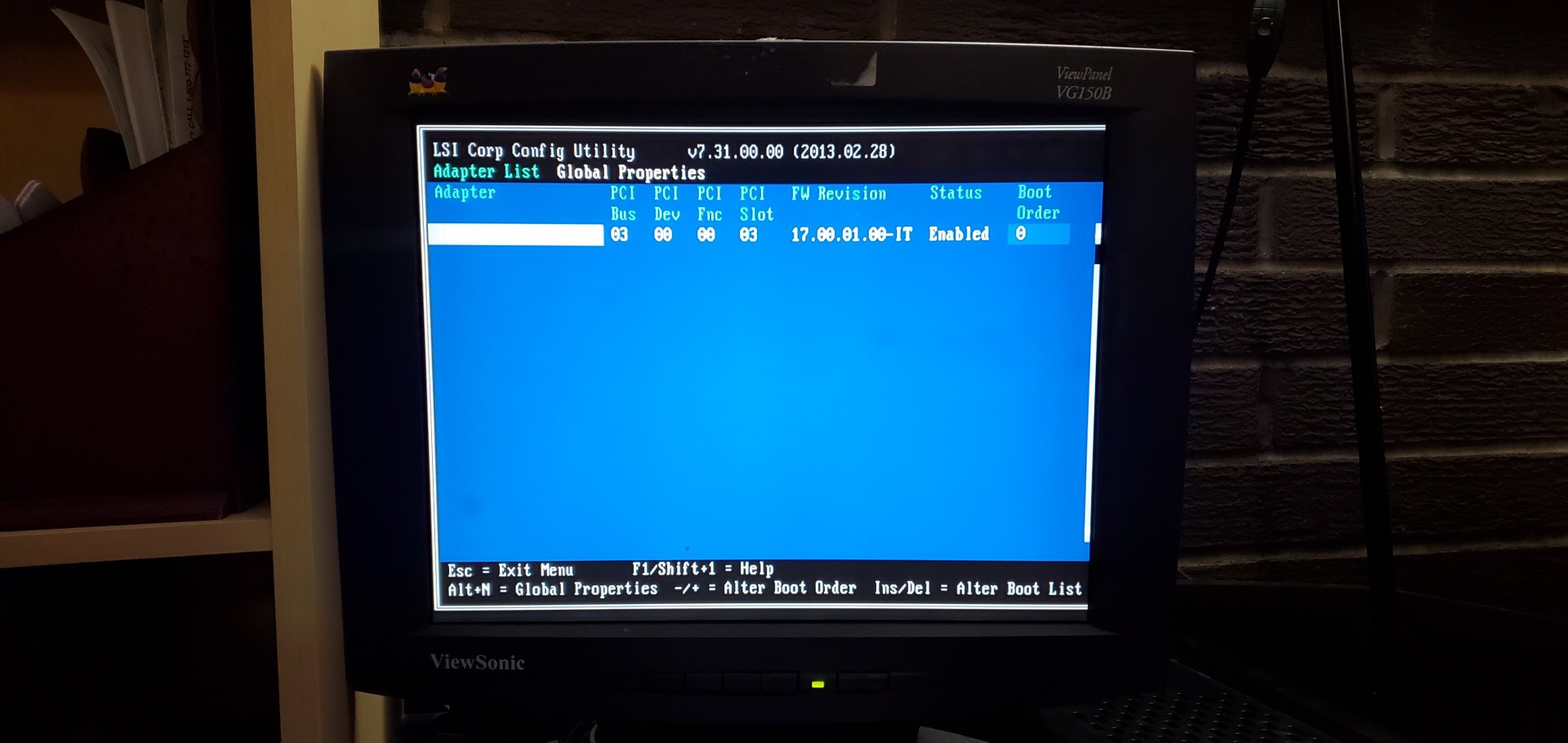

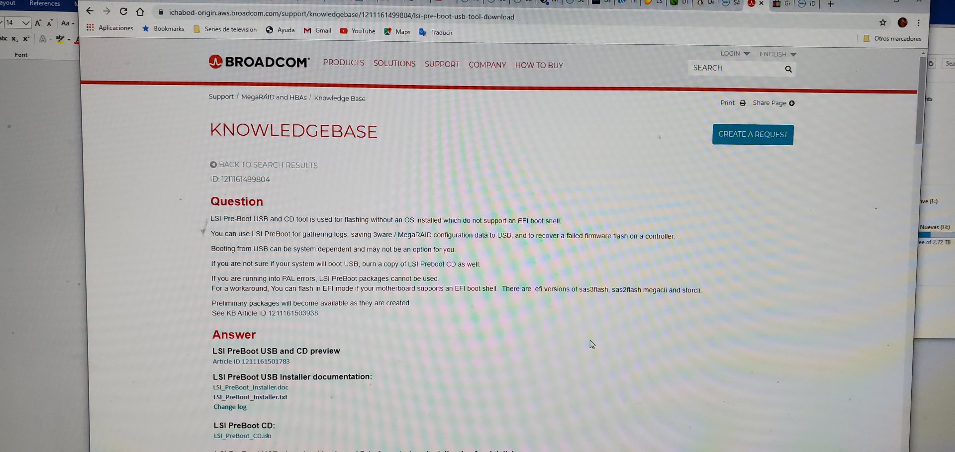

I just did the reflash on the controller, I found a bootable CD image at broadcom.com the LSI creators I think and did it for me, way easier that all the methods I have found over hear, that I pretty much didn't understand lol. The version of the bios of the controller was 10. Something and said 2011 and now is 17. Something and says 2013. I don't know if that will fix the issue but I did it any way.
I end up doing this way because even though I saw many videos and read a lot on how to do it, not even one person provide a link or a hint on where to get the files to do the flashing, so this was the only thing I found.
I feel pretty dumb as I am not able to find exactly what I need, I see every manual and video talking about the firmware version being 20. Something but I could only get 17. Something.
I leave some pictures that can mabe help.

Darklion
Oct 18, 2019
62

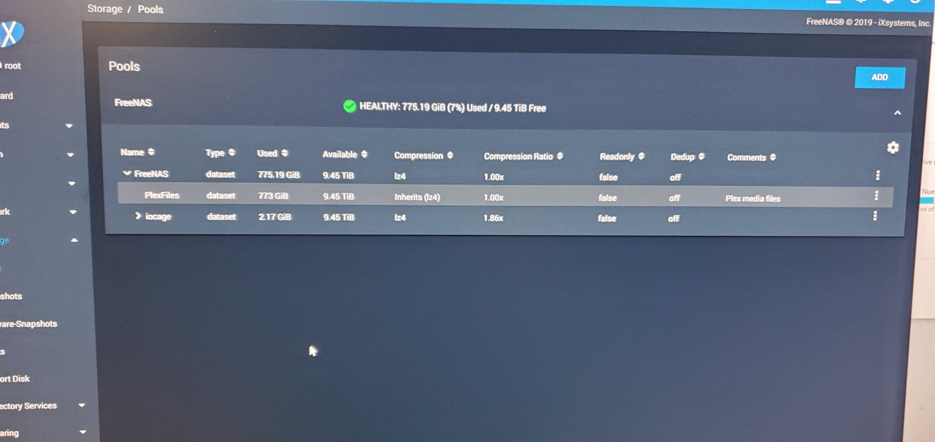

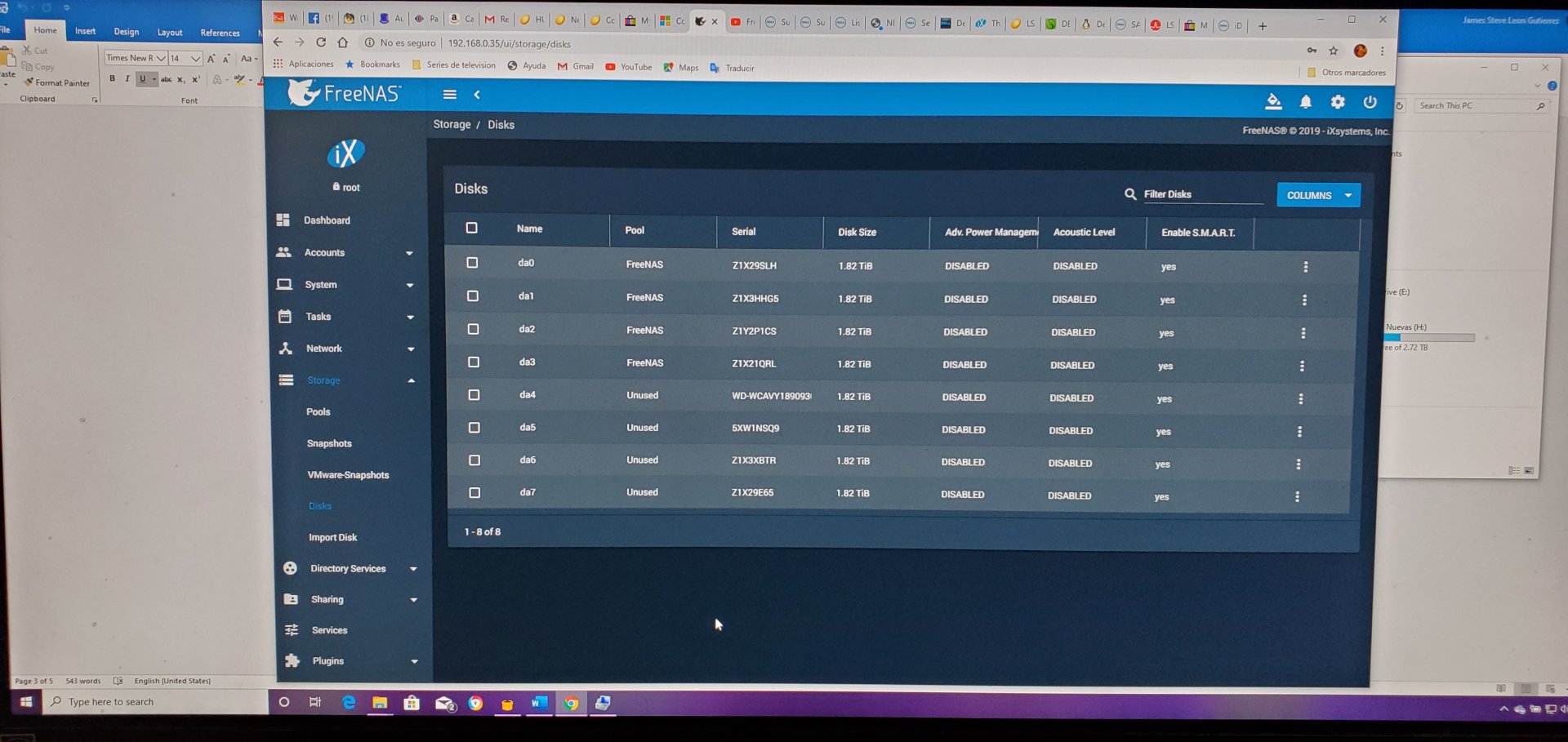

I feel like a genius lol. It worked.
Now I can see my 8 drives no problem, now I will see if I can add them to the pool I have already created.
I am leaving attachments of what do I have cuz it could help someone lol.
There is the web site where I got the bootable CD image.

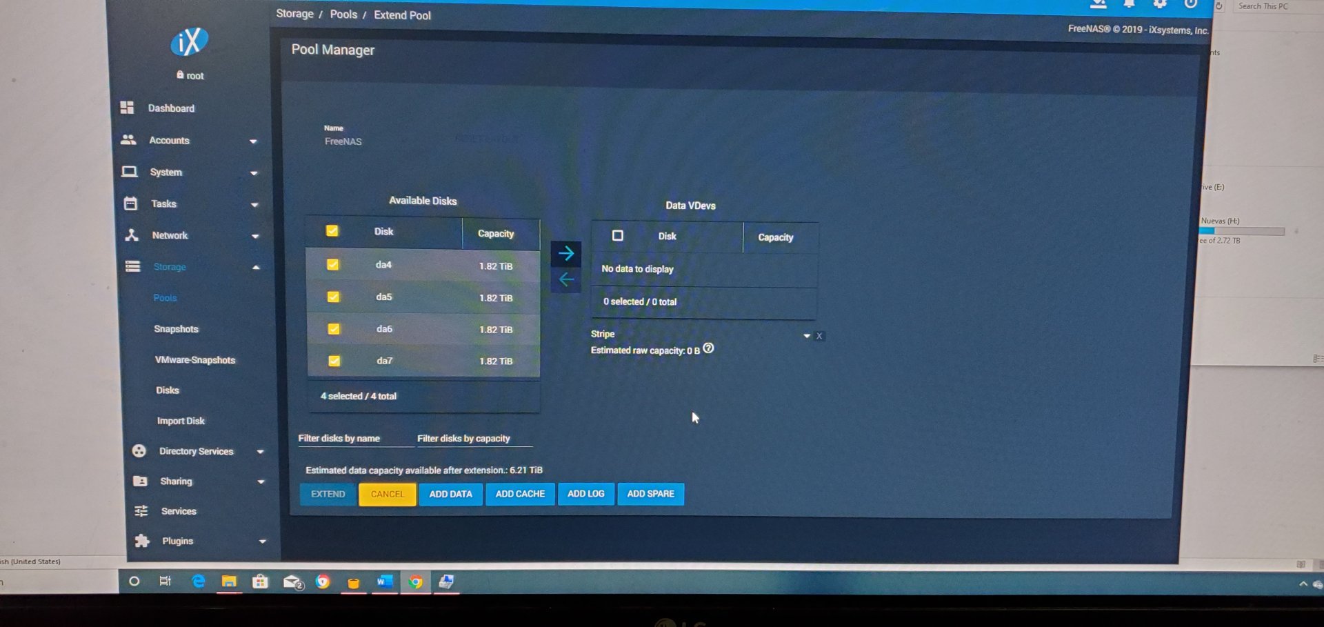

Darklion
Oct 18, 2019
62

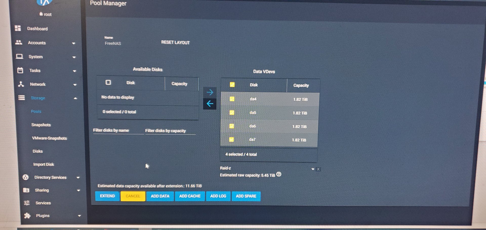

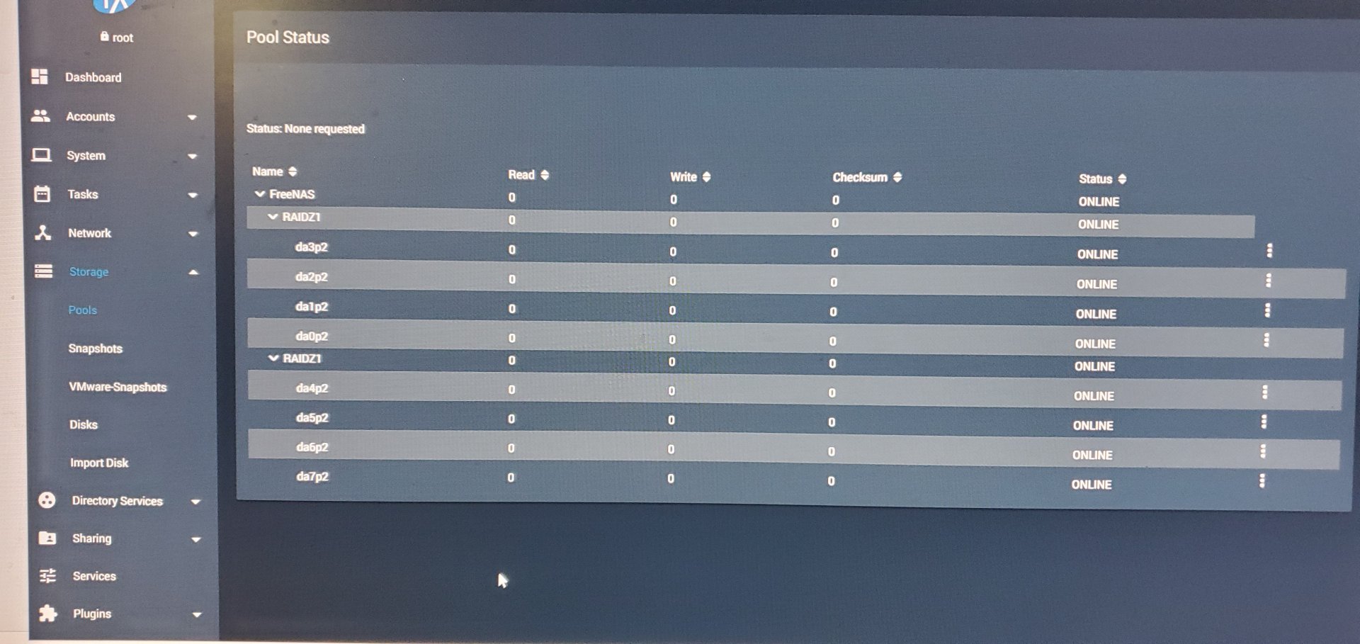

I added the other 4 drives at my existing pool of 4 as I was only able to use 4 before but it looks like I lose the capacity of 2 drives instead of just one, looks like I have 2 different raidz with 4 drives on each. I thought I could be adding more drives as I am getting more but it didn't work that way. Maybe I should add one drive at a time and not all the 4 at ones.
I am gonna have to erase everything I start from scratch again and lose all the movies I already copy in there, well now this is getting fun as I am leaning a lot now, glad this is not my definitely storage for now and can mess it up until I learn how it works. I never thought I could go all the way this far by my self just reading and viewing lol.
@Halintexas I feel like an expert now, you can ask me anything you want, if I don't know it, I will invented it lol.
