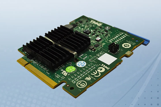

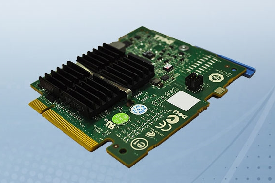

Does your H200 controller look like this:
Or like this:
Or like this:

The controller is the second of the two you posted, with the single silver heat sink.

According to the invoice when I ordered the server it's an H200 PERC Controller 6 Gbps (RAID 0,1,10) but I can't find any configuration "leftover" to remove.
I didn't configure anything in the BIOS/RAID controller for the first array. :/
As for the question of IT mode, I don't recall the exact part of the process that hung me up but I am sure I at least updated the firmware on the H200 to the latest available. I don't think I was able to get it into IT mode because of some impediment at the time... needing a longer cable, having to move the card to flash it... I can't remember, I read SOOO much on the topic at the time and tried to cobble together what was relevant to my particular hardware situation. Then I came across that post that said to leave the drives unconfigured and the controller would pass them through (a la JBOD) and so I tried that and it worked!
If the prevailing advice is indeed to flash the controller to IT mode, should I be worried about my existing 30TB RAIDZ1? I would very much like to keep that intact and if there is any potential for loss I would almost prefer to just stick a spacer in bay 5 and treat it like Chernobyl ;)
It is known to do odd things if you do not crossflash it to LSI IT mode. Note that I said *LSI* IT mode. Not Dell IT mode. The process is annoying and a bit finicky - I just finished doing a bunch a month ago - but definitely worth it.
As long as the drives are identifying in the OS (when you do a "camcontrol devlist") as the correct model numbers and not as virtual disks, your data should be safe, go ahead and flash to IT. I do personally prefer to unplug the drives while flashing and testing, but I'm paranoid. The main risk is that you brick the card and cannot figure out how to recover it, which leaves your data inaccessible. These things are pretty hard to permanently toast (trust me, I've tried) and someone can probably help if you manage that tough feat.
