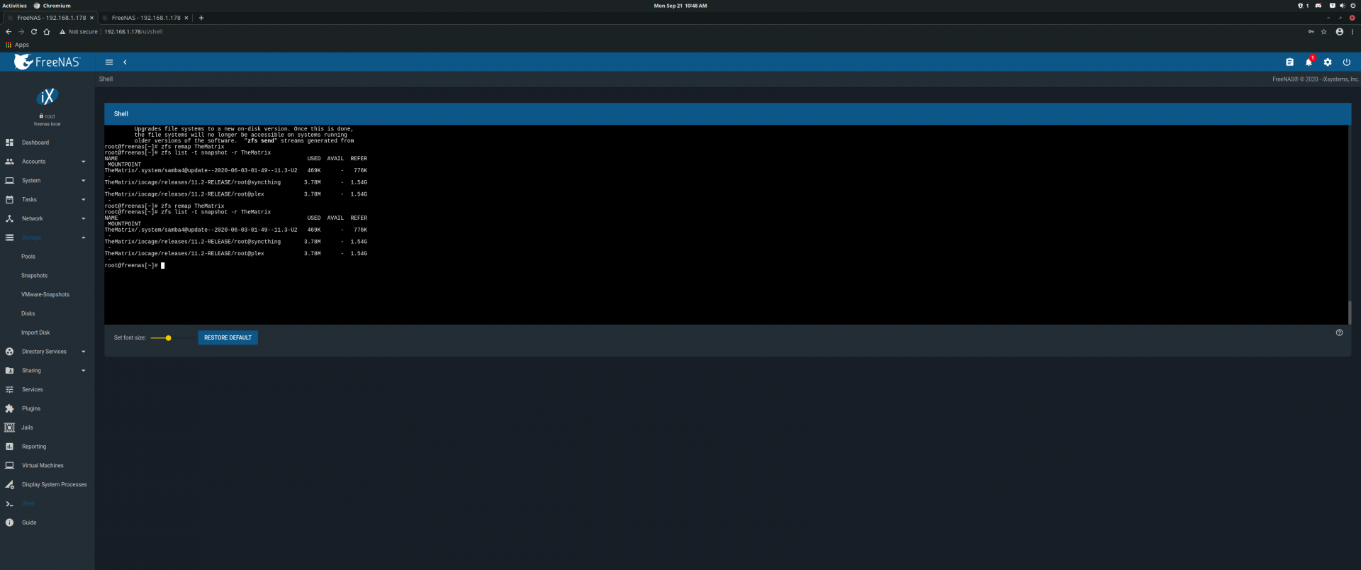

RhythmInk
Sep 20, 2020
5
Try zfs remap your_pool_name.
Unfortunately no change.
RhythmInk
Sep 20, 2020
5
