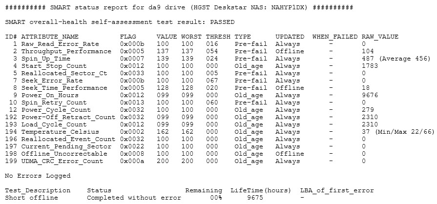

I have a perplexing issue where a ZPool Status Report / SMART Report show everything to be OK and then a few hours later I see read / write errors. Considering the SMART report showed the drive was OK, I tried to replace the disk with the same one, but it gave an error because an existing partition was found. Upon that erring, I tried to force it, but that didn't work. I ran a zpool detach which converted that mirror to a stripe. I ran a scrub and rebooted, now I need to figure out:

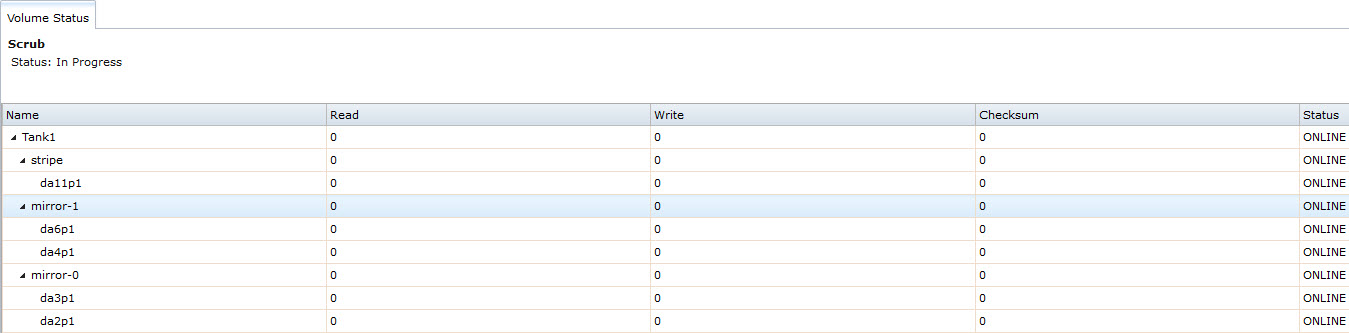

2. Volume Status: Scrub in Progress / Pre-Reboot
  • Tank1
    • stripe
      • da11p1
    • mirror-1
      • da6p1 / da4p1
    • mirror-0
      • da3p1 / da2p1

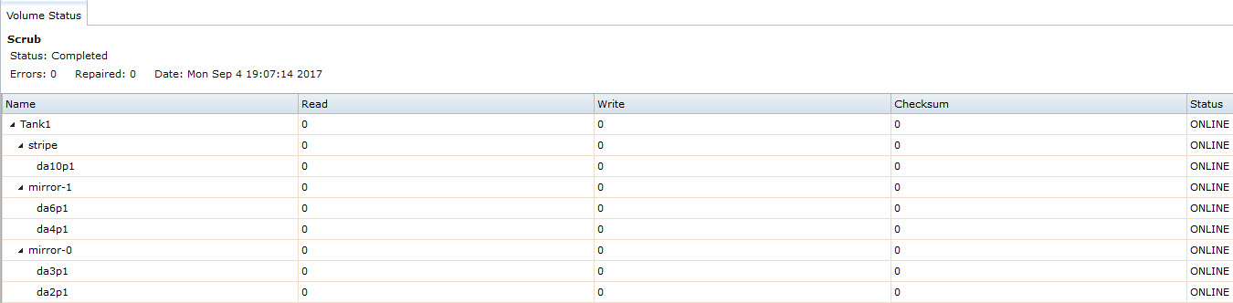

3. Volume Status: Post-Scrub / Post-Reboot
  • Tank1
    • stripe
      • da10p1
    • mirror-1
      • da6p1 / da4p1
    • mirror-0
      • da3p1 / da2p1

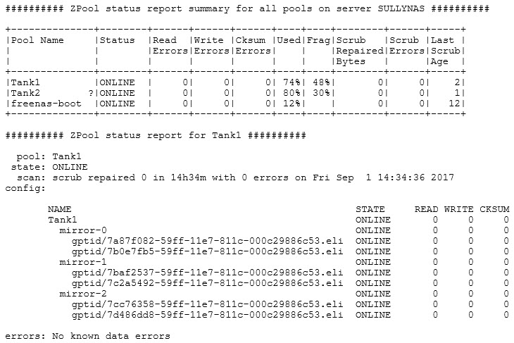

  • Monday @ 12:00 AM - ZPool Status Report
    • No Read / Write Errors
  • Monday @ 12:00 AM - SMART Status Report
    • No errors logged

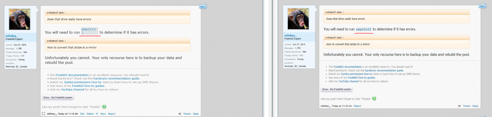

What a weird rendering bug:
Firefox on the left, Edge on the right.
Nope, 100%. Took me a week to get used to it some three years ago. Also happens when the window is shrunk down to mobile resolutions.
