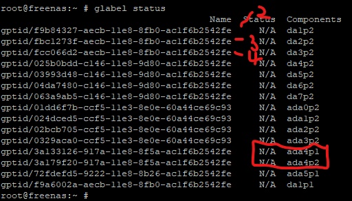

Using glabel status I cannot then find the drive listed (i.e., I'm missing "1" above):
I don't follow, why both ada4 and da1 appear twice - or am I reading something wrong?

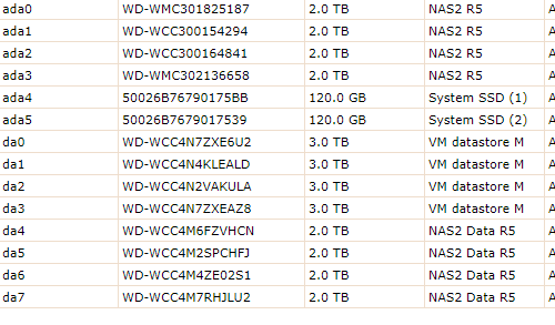

For clarity this is the GUI:
Since I can identify da1, da2 and da3 it seems da0 is potentially at fault. However is passes SMART.

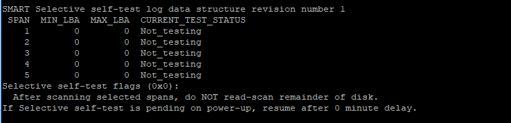

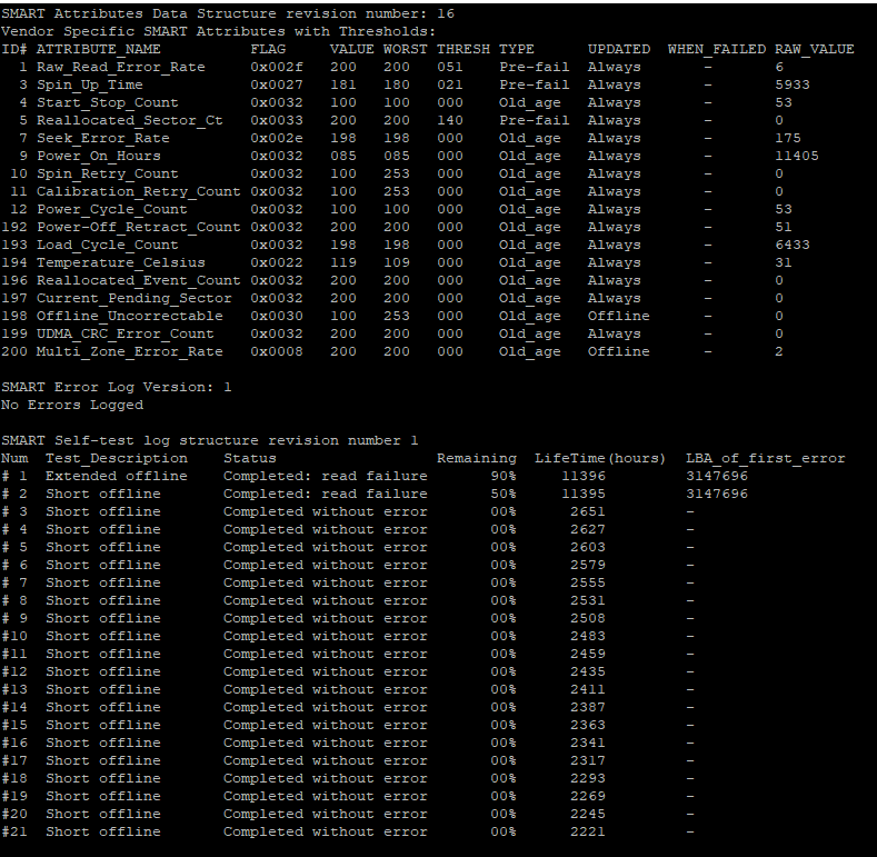

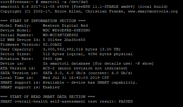

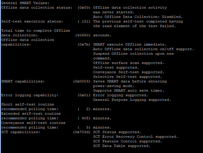

The drive is available for testing -- but I cannot find it as part of the pool.
SMART reports show an overall pass
General SMART values
Errors on drive
End of report

9,700
Your drive is dying, get it replaced.
You have read errors, seek errors and multi-zone errors. Unless you don't care about your data, waiting for those numbers to increase until the whole show is over is not productive.
