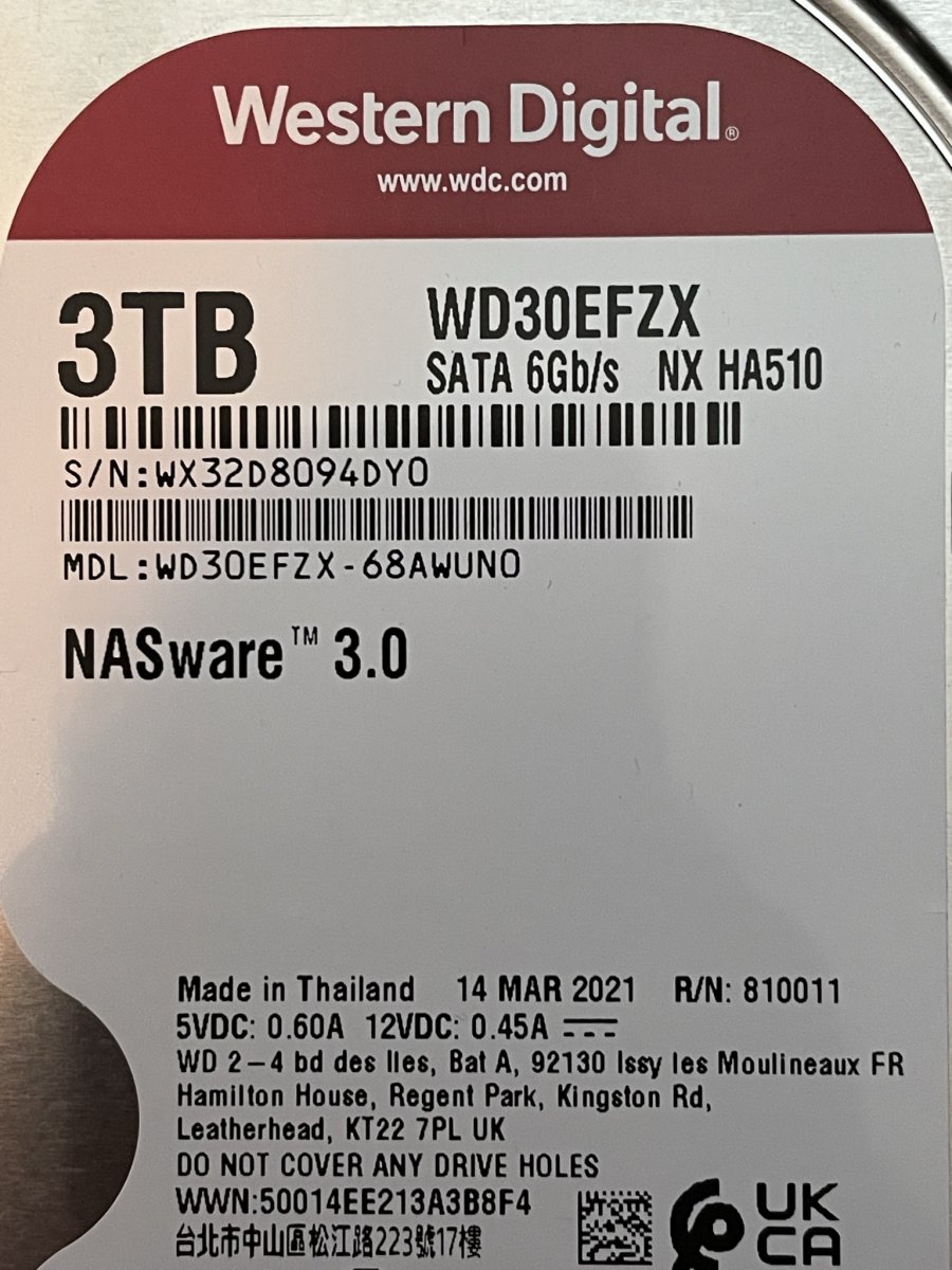

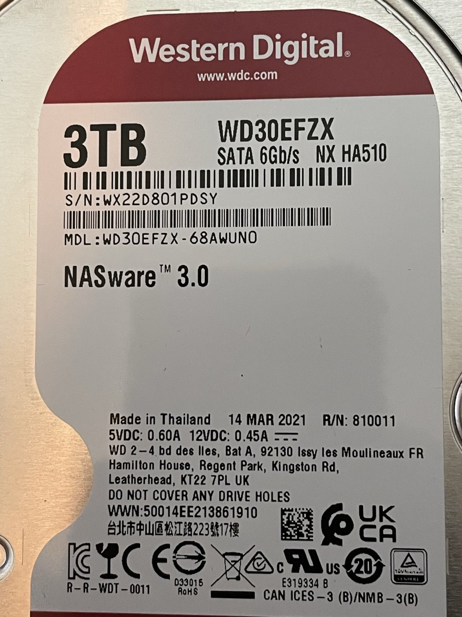

Didn't all the drive manufacturers stop making oddly sized HDD's awhile back?
I think a number got dropped somehow there, and it's intended to be written as '7 WD Red 3.5" X TB standard drives' where X is an even integer.
The 'WD Red' part was what caught my eye though, as adding SMR drives to the mix in a resilvering pool - especially WD Reds that might experience a firmware bug - is a caution point for sure.

bcolvin71
Mar 12, 2022
6
bcolvin71
Mar 12, 2022
6
Sorry. They are 3 TB, not 3.5. Took those prior to installing so I could easily see the serials
