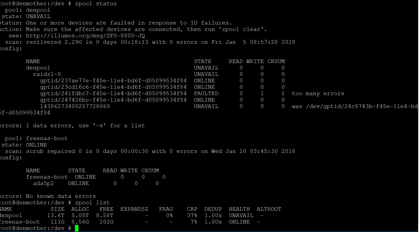

Am I correct see that status as being missing drive from the one I replaced and Faulted from another dieing on me after my prior exchange above?

well... i'm not sure what to think now. it's resilvering now and isn't showing any error flags... with the old drive.
zpool/vol still isn't showing imported/mounted in the webgui, but the zpool status shows it Online
UPDATE: oops. there it goes. faulted. again. only issue now is that I don't have the volume disks view to see the serial of the drive it shows faulted. is there a CLI i can use to return the serial of the drive from the gptid entry?
