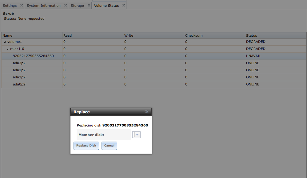

I had a disk go bad
I followed the instructions in the guide (detached the bad disk, shutdown, unplugged it, added the new disk, booted, resilvered the new disk, removed the old one from the list, etc.) but the new drive won't go online after running the zpool online command.
This is a zfs raidz1 pool with 5 disks in volume1
Here's a zpool status:

The first 4 disks listed above are in the raidz1 volume1 pool. My new disk is the 5th disk on the volume1 pool and the disk that went bad which i am trying to replace with this new one used to be ada4.
However since the new drive is not coming online as ada4, you can see the UFS Hitachi backup disk (an external esata drive) is currently ada4, and the SanDisk on da0 is my boot USB stick.
Running the zpool online command does this:
[root@freenas ~]# zpool online volume1 9205217750355284360
warning: device '9205217750355284360' onlined, but remains in faulted state
use 'zpool replace' to replace devices that are no longer present
which leaves me with the new drive still unavailable.
(i've rebooted tried again, re-run replace command, resilvered, and still can't get it to join the pool)
When trying to use the GUI to add the disk into the pool with the REPLACE button, I'm unable to do so because the member disks drop down list is empty (see attached image)
Any ideas at this point are appreciated

Any idea why the GUI's drop list for member disks is blank? (see attached pic) Or any idea how to add a 5th disk back into my 5 disk raidz1 pool?
There's a bunch of reasons. They range from FreeNAS thinking the disk is part of a pool already, the disk isn't detected, FreeNAS thinks the disk is not appropriate for the pool, or the disk already has a valid partition table and partitions. Those aren't all of the reasons either.
