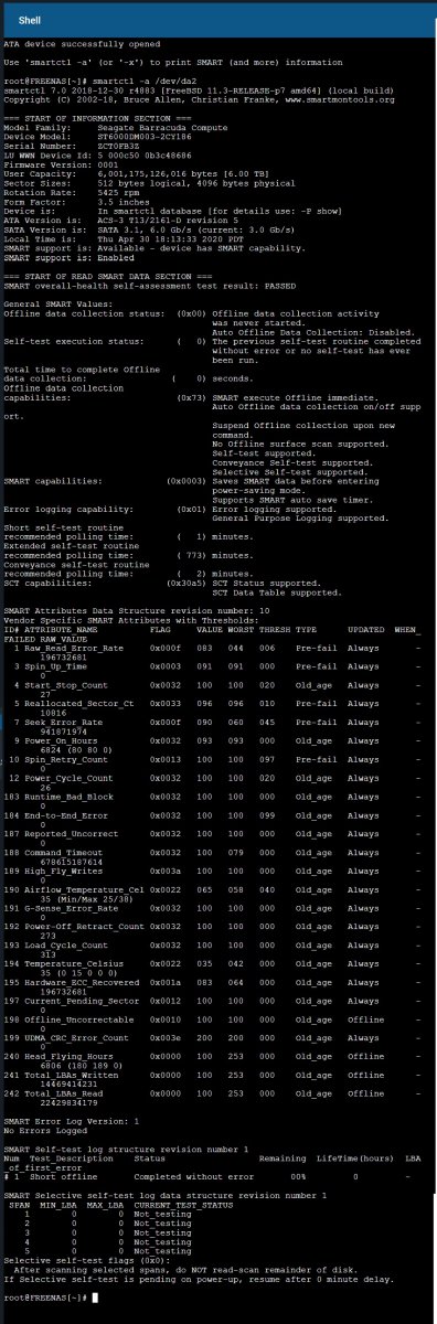

Looking for a little bit of help with this. Obviously stressing :/
Clicking on my pool on the dashboard shows that:
da2: UNAVAIL
RAIDZ2
CRITICAL
Pool tank6x6 state is DEGRADED: One or more devices could not be opened. Sufficient replicas exist for the pool to continue functioning in a degraded state..
Sat, 29 Apr 2020 05:47:42 PM (America/Los_Angeles)
I read
All I see is old_age everywhere. Is this just a case of a drive going bad (bought 1/17/19). Did this drive just not boot properly and it might actually be ok? what is my next step. Probably ordering a 6TB tonight, hopefully I can get a little bit of help before then if it isn't a "bad" drive?
Thanks for any help, let me know if there is something else I can post.
EDIT:
I Just ran this test on all 6 of my hard drives... they all say old_age. Am I screwed on all hard drives and need to replace all 6?

The "Type" isn't what matters so much as the raw value. You have TONS of reallocated sectors on this drive; unless there is something I am missing; you should replace it. Are you running regular SMART tests and do you have email alerts set up? Those will help notify you before a drive fully bites the dust that it is on its way out.

Don't worry about the Old-Age buzzword. It is only the type of test. Ex: counting how many stop / start the disk endured so far. After too many, the risk for it to fail increase. That is what an Old-Age type is about.

See ? All these settings are of the Old-Age type also for my own drives.
Look at test no5, re-allocated sector as pointed by @PhiloEpisteme : mine is at 0 and yours are over 10K. That is what you have to worry about.
So Yes, I would replace that drive. I would also look at all other drives to see how they look. Thanks to RaidZ2, you can not only loose a drive, but with a single drive missing, you still have redundancy.

I reran all the smartctl -a tests and that is the only drive with any reallocated sectors.
