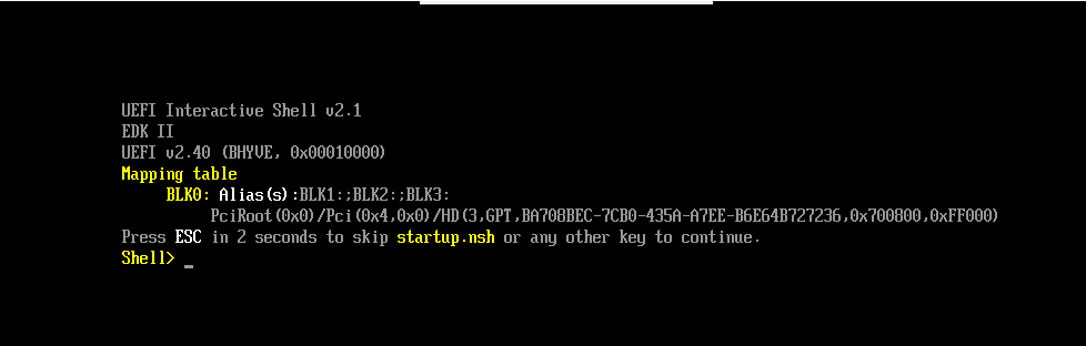

Hey,
I have created a Debian VM with the Webinterface, but after the first start after the installation, i will get this screen in the VNC (attached picture). How i can fix this?
The Boot Method is UEFI and i have tested the disk in the virtO and AHCI Mode.
The Version is FN11-U4.

Hey,
Go here: https://forums.freenas.org/index.php?threads/how-to-how-to-boot-linux-vms-using-uefi.54039/
Next time you install a Debian 9 VM, use "Expert Mode" and make sure you say "yes" to "Force grub-efi installation to the removable media path" option when you install GRUB2 boot loader, then you want need this fix.
