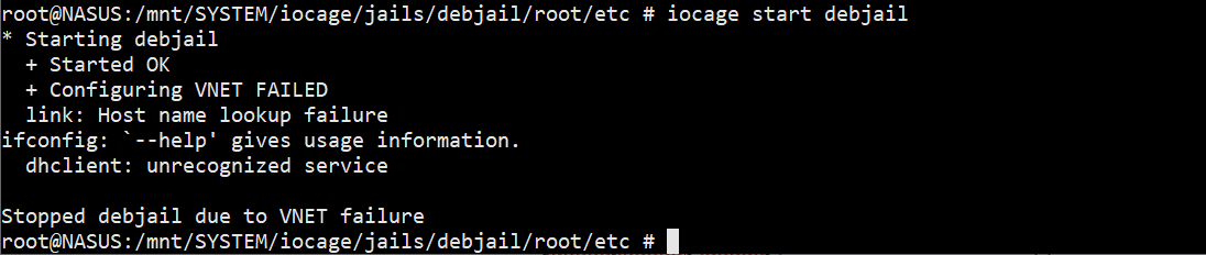

Ok, so I set bpf=yes (and vnet=on, required when setting bpf=yes I guess). I was able to start and log in to the jail, but now ifconfig returned nothing. Could it be that Devuan doesn't recognize the vnet interface? Seems to be some mismatch between what iocage is providing to the jail OS (devuan) and what the jail OS (devuan) is able to interpret....
Here's my output:

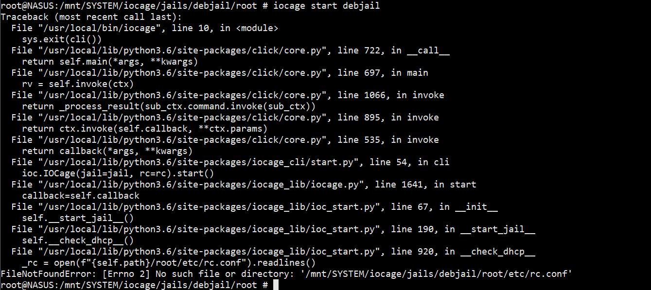

When dhcp=on the jail doesn't start. Seems like it is looking for /etc/rc.conf, which will of course result in an error when the jail is not FreeBSD. I guess it want to add ifconfig_epair0b="DHCP". Is there a way to direct iocage to use another file?
I tried to add a rc.conf (with 'debjail' as hostname) just to see what would happen

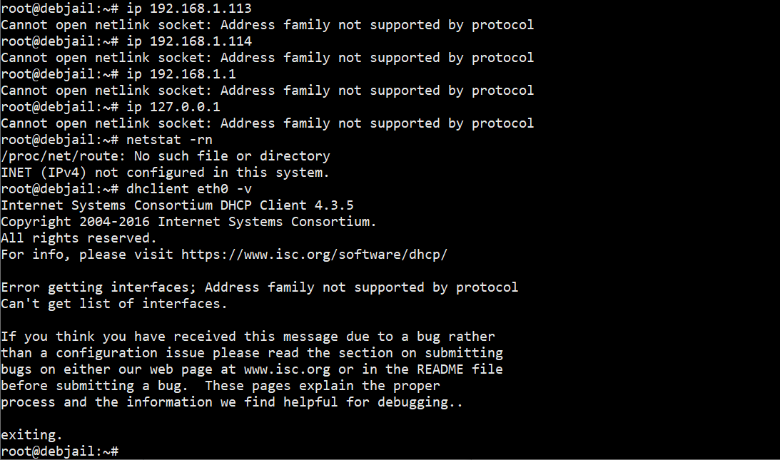

Since I'm not able to enter the jail when using DHCP, i was only able to try IP address and dhclient in a static-ip-configuration:
Seems like the network interfaces is not configured properly in the jail...?

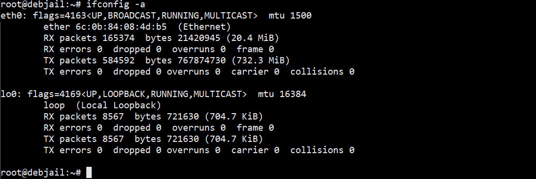

maybe the next thing to try is ifconfig -a (to see if there are any network interfaces at all, even if they may be inactive).
Also, ip address is intended to be the command, don't subsitute the actual address (I would have used ip <address> in that case).

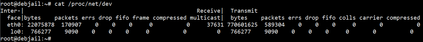

ifconfig -a shows that eth0 and lo0 are "active", so Devuan must somehow see a "network adapter".
Also, there are some statistics of the network adapter in /proc/net/dev
ip address produced the same error as when using ip 192.168.x.x.:

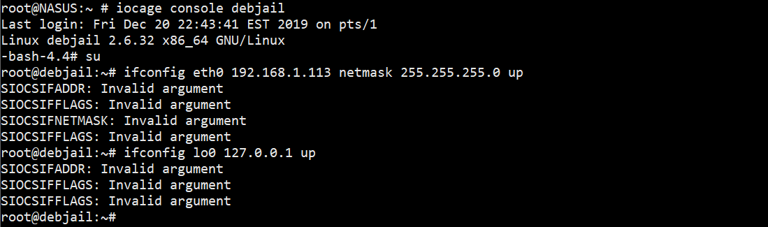

You could try ifconfig eth0 192.168.x.x netmask 255.255.255.0 up
That might work, but I'm not sure if you will then need to somehow specify a default gateway.
Possibly also useful to do ifconfig lo0 127.0.0.1 up

ifconfig eth0 192.168.1.113 netmask 255.255.255.0 up and ifconfig lo0 127.0.0.1 up gave error. I tried to google the errors but didn't find anything that made sense to me..

How about ifconfig eth0 up
I agree there's sufficient mysterious magic going on here to have me at a loss regarding how it all works.
Based on the last results, maybe the linux commands are the right ones rather than the FreeBSD ones.
