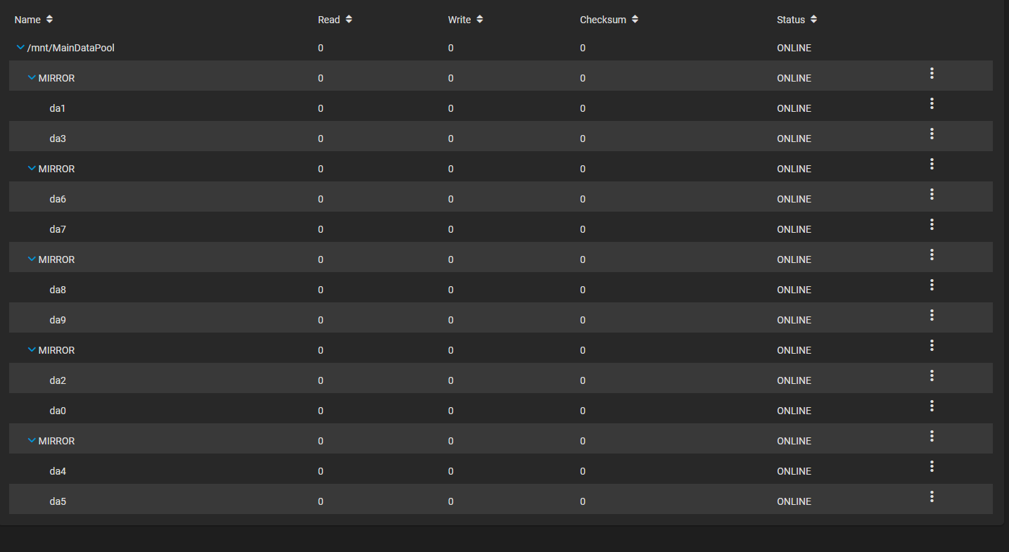

I have a pool configured the following. Disk1 failed and has been replaced. The pool is now healthy again. My question is, can any of the data that was written to Disk1 be recovered without access to the other disks? The drive is under warranty and I would like to send it in for replacement, but the pool contains sensitive data I do not want shared. Thank you.
Vdev1 (mirror)
disk1
disk2
Vdev2 (mirror)
disk3
disk4
Vdev3 (mirror)
disk5
disk6
Vdev4 (mirror)
disk7
disk8
Vdev5 (mirror)
disk9
disk10
Maybe. At least, there is no guarantee that nothing can be recovered. Certainly any file which is below your record size (after compression) can be recovered (in its entirety) if it happens to be stored on that disk. Also, starts of files can be recovered and maybe identified.
What about from a failed disk from a RAID Z2 vdev, is that harder to recover data from vs the mirrored example?
Harder, yes. Mostly because the size limit goes down from record size to sector size (ashift). But still, if you have a file which is smaller than your sector size (after compression), it is possible that the entire file can be recovered. Also, some starting parts of files can be recovered, up to the length of your sector size (after compression).
Usefulness of the above depends on what type of data you are concerned about.

You could always use the evaluation version of Klennet (free to view, costs money to actually restore files) to see if it is able to reconstitute anything if you're concerned.
It will not be able to produce anything usable, but it is because it is for a different task. The recovery of whatever is on that mirror disk is probably not achievable with any commercially available recovery software. However, a tool custom-developed for a determined attacker can recover enough for some purposes (depending on what the sensitive data is, or, more specifically, what is the format of the data).
