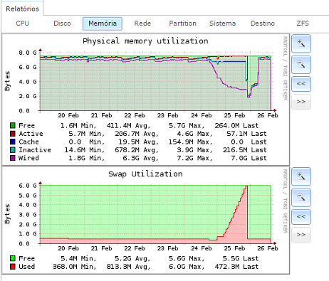

Hi, I have an Lenovo TS140 with only 8Gb of ram.
But is a very small office, with just 3 users and small files.
Only one person deal with some photoshop, corel, etc... but is occasionally.
Attached is the moment that the problem happens.
I rebooted the server now, checked remotelly and the Vbox is working with windows inside, all the files are affordable by the network.

Yes, you did run out of SWAP Space as indicated in the image you captured. I can't tell you what was being swapped, just that your system was trying to free up RAM for something to happen and couldn't do it. What I didn't like was how long it took to use up the SWAP space, maybe you have a memory leak going on in the VBox or some other program you are running. Do you know exactly what was happening during those hours on that day? I would recommend that you double your RAM to 16GB. I am not personally familiar with the TS140 but if it can take 32GB RAM, since you are in an office then it could be a smart move. But first ensure what your computer could be upgraded to.
If it turns out to be a memory leak, you will need to reboot the system periodically to keep the issue at bay. Yes, servers do periodically get reboot just because of memory leaks since they may not always be found quickly.
