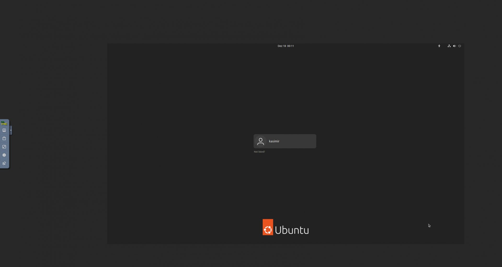

Hey,
i finally got everything setup for VMs on my TrueNAS Core installation and went ahead and installed a ubuntu desktop image on a standard settings vm.
1 cpu, 1 core 1 thread 8gb memory 200gb hdd space ubuntu desktop image.
All installs fine BUT when it boots up I can not move the cursor or click anything.
I can log-in via keyboard but actually the keyboard layout that I have setup in the install seems not to be right.
And the cursor is not working at all.
What am I missing? What is wrong? Is it a noVNC issue?
Is there an alternative to noVNC?
Where may i change the keyboard mapping to at least work right?

Hey, after a night of trying to fix this i am not any further. Here is what I tried:
  1. According to a couple of posts in this forum the issue rests on the amount of cpu/cores. So I tried a lot of combinations, even and odd from up to 8 CPU, Cores and Threads. (not all possible combinations but a wide range to test)
  2. Changed nic, network devices etc. to virtual and back
  3. Updated and upgraded everything (TrueNAS, new Ubuntu Image, ubuntu inside the vm)
  4. replaced the image to an older one
  5. reboot trueNas and the workstation/server running it
  6. rezised vnc and tried all options I could
issues remain:
1. keymapping is completely wrong
2. curser is not working on the vm
What could possibly be the cause? The next try would be different distros from linux but that defies the purpose of setting up the VM exactly how it runs on other machines from me.
Any help or ideas is greatly appreciated. I am out of my depth with it.

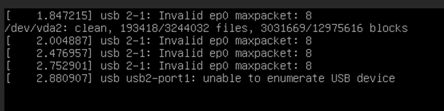

Same problem after runnin update in the Ubuntu VM.
I am running truenas 13.0-U6.1 and Ubuntu 22.04.02 for the last six months without problem.
Yesterday I updated Ubuntu (from within the VM) after the obligatory restart the mouse stopped working.
Power off/on the VM made no difference so I decided to recreate the VM with Ubuntu 22.04.03, no luck but an
error message at startup:
Reinstalled with Ubuntu 22.04.02, no change same error message and mouse working halways i.e. cursor moves
but no effect of clicking any button.
Tried to read any post related to the problem but alas... The only possible clue is that all this happened after upgrade
to 13.0-U6 or to 13.0-U6.1
Anty ideas would be most welcome

Hey @Geigo, thanks for your post. Jupp, I got the same error message and I researched it for hours but could not really get to the bottom of it. I also did that update but did not have an VM installed beforehand, thus can not compare.
BUT I thought maybe it has to do something with the usb port settings. On the workstation it is a USB 3.1 port but it enumerates USB2? Maybe?
Does anyeone know if I would change the VNC settings maybe?

I get the same error message at startup. Started thinking it's emulating a USB mouse and the virtual USB port isn't working.
I tried booting under U6 but that didn't fix it. Mouse works fine in the Ubuntu installer but not after it's installed.

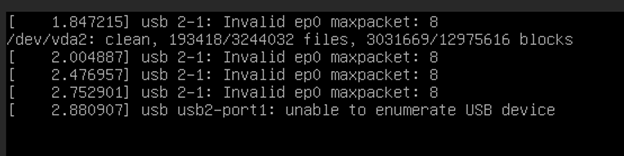

Same issue here. Began after my 20.04.6 VM's updated to linux-image-5.4.0-169-generic. Tried the latest 5.15 and 5.19 with the same result. Booting back to linux-image-5.4.0-167-generic fixed this.
I had not updated my NAS in a longtime due to a plugin my wife and I still used but I decided at the start of my vacation to remove the old legacy jail and get current. This happens with the same VM's and mentioned kernels on 11.2-U8 -> 11.3-U5 -> 12.0-U8.1 -> 13.0-U6.1. That said this isn't a FreeNAS/TrueNAS problem.
I think this is tied to the fix for CVE-2023-37453:
It was discovered that the USB subsystem in the Linux kernel contained a
race condition while handling device descriptors in certain situations,
leading to a out-of-bounds read vulnerability. A local attacker could
possibly use this to cause a denial of service (system crash).
linux-image-5.4.0-169-generic dmesg log:
[ 0.269304] usbcore: registered new interface driver usbfs
[ 0.269304] usbcore: registered new interface driver hub
[ 0.269304] usbcore: registered new device driver usb
[ 0.779575] usb usb1: New USB device found, idVendor=1d6b, idProduct=0002, bcdDevice= 5.04
[ 0.779576] usb usb1: New USB device strings: Mfr=3, Product=2, SerialNumber=1
[ 0.779578] usb usb1: Product: xHCI Host Controller
[ 0.779578] usb usb1: Manufacturer: Linux 5.4.0-169-generic xhci-hcd
[ 0.779579] usb usb1: SerialNumber: 0000:00:1e.0
[ 0.779939] usb usb2: We don't know the algorithms for LPM for this host, disabling LPM.
[ 0.779957] usb usb2: New USB device found, idVendor=1d6b, idProduct=0003, bcdDevice= 5.04
[ 0.779957] usb usb2: New USB device strings: Mfr=3, Product=2, SerialNumber=1
[ 0.779958] usb usb2: Product: xHCI Host Controller
[ 0.779959] usb usb2: Manufacturer: Linux 5.4.0-169-generic xhci-hcd
[ 0.779960] usb usb2: SerialNumber: 0000:00:1e.0
[ 1.009814] usb 2-1: new SuperSpeed Gen 1 USB device number 2 using xhci_hcd
[ 1.029057] usb 2-1: Invalid ep0 maxpacket: 8
[ 1.165543] usb 2-1: new SuperSpeed Gen 1 USB device number 3 using xhci_hcd
[ 1.186222] usb 2-1: Invalid ep0 maxpacket: 8
[ 1.195194] usb usb2-port1: attempt power cycle
[ 1.652043] usb 2-1: new SuperSpeed Gen 1 USB device number 4 using xhci_hcd
[ 1.670275] usb 2-1: Invalid ep0 maxpacket: 8
[ 1.936838] usb 2-1: new SuperSpeed Gen 1 USB device number 5 using xhci_hcd
[ 1.958853] usb 2-1: Invalid ep0 maxpacket: 8
[ 2.100176] usb usb2-port1: unable to enumerate USB device
[ 5.242333] audit: type=1400 audit(1702746231.940:9): apparmor="STATUS" operation="profile_load" profile="unconfined" name="ippusbxd" pid=453 comm="apparmor_parser"
linux-image-5.4.0-167-generic dmesg log:
[ 0.264226] usbcore: registered new interface driver usbfs
[ 0.264231] usbcore: registered new interface driver hub
[ 0.264238] usbcore: registered new device driver usb
[ 0.779474] usb usb1: New USB device found, idVendor=1d6b, idProduct=0002, bcdDevice= 5.04
[ 0.779475] usb usb1: New USB device strings: Mfr=3, Product=2, SerialNumber=1
[ 0.779475] usb usb1: Product: xHCI Host Controller
[ 0.779476] usb usb1: Manufacturer: Linux 5.4.0-167-generic xhci-hcd
[ 0.779477] usb usb1: SerialNumber: 0000:00:1e.0
[ 0.779820] usb usb2: We don't know the algorithms for LPM for this host, disabling LPM.
[ 0.779836] usb usb2: New USB device found, idVendor=1d6b, idProduct=0003, bcdDevice= 5.04
[ 0.779837] usb usb2: New USB device strings: Mfr=3, Product=2, SerialNumber=1
[ 0.779838] usb usb2: Product: xHCI Host Controller
[ 0.779838] usb usb2: Manufacturer: Linux 5.4.0-167-generic xhci-hcd
[ 0.779839] usb usb2: SerialNumber: 0000:00:1e.0
[ 1.010184] usb 2-1: new SuperSpeed Gen 1 USB device number 2 using xhci_hcd
[ 1.029693] usb 2-1: New USB device found, idVendor=fb5d, idProduct=0001, bcdDevice= 0.00
[ 1.029695] usb 2-1: New USB device strings: Mfr=1, Product=2, SerialNumber=3
[ 1.029696] usb 2-1: Product: HID Tablet
[ 1.029697] usb 2-1: Manufacturer: BHYVE
[ 1.029697] usb 2-1: SerialNumber: 01
[ 1.035659] usbcore: registered new interface driver usbhid
[ 1.035659] usbhid: USB HID core driver
[ 1.038036] input: BHYVE HID Tablet as /devices/pci0000:00/0000:00:1e.0/usb2/2-1/2-1:1.0/0003:FB5D:0001.0001/input/input4
[ 1.038402] hid-generic 0003:FB5D:0001.0001: input,hidraw0: USB HID v10.01 Mouse [BHYVE HID Tablet] on usb-0000:00:1e.0-1/input0
