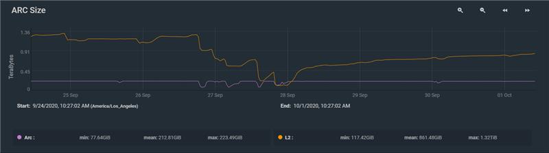

I am finding an issue where I migrate virtual machine storage off of the platform and onto another (presented via iSCSI on 10 Gbps w/ Jumbo Frames end-to-end) where the device significantly drops both ARC/L2ARC cache data including neighboring data in-storage.) What is more curious is that this occurs at the end of the "copy" operation and on the final delete of the source VM files. Read latency increases significantly here for all virtual machines running on this pool as the common cache data is flushed. Sync writes are enabled. Total pool size is around 60% used and presented to the hypervisor via iSCSI.
My pool is configured with the following:
17x mirrored vDevs containing 2x 4TB in each
2x 780GB cache SSD's geared towards read-intensivity
2x ZeusRam devices configured as SLOG
Detailed below -- the dips all correspond with a virtual machine being migrated off of the storage platform and occurs immediately after the delete operation after the storage migration is completed.
Thoughts or ideas here? I haven't had throughput issues, but the latency here is killer when the ARC/L2ARC take these hits, it appears that more data than I am familiar with in Oracle ZFS is released when something is deleted.

Noteworthy I had another occurrence migrating a 1 TB disk off of this platform and saw the cache drop:
What's curious is that other virtual machines that were not exhibiting symptoms of disk latency experience severe disk latency while the cahce is being flushed, but are resolved once the system "levels off."

Additional post coming with the during scenario.
ridyre
Oct 1, 2020
12
During scenario:
During the event after the delete:
root@zfsloaner[~]# arc_summary.py
System Memory:
        0.00%   7.80    MiB Active,     0.65%   1.62    GiB Inact
        96.64%  241.12  GiB Wired,      0.00%   0       Bytes Cache
        2.30%   5.74    GiB Free,       0.41%   1.01    GiB Gap
        Real Installed:                         256.00  GiB
        Real Available:                 99.97%  255.91  GiB
        Real Managed:                   97.49%  249.50  GiB
        Logical Total:                          256.00  GiB
        Logical Used:                   97.13%  248.64  GiB
        Logical Free:                   2.87%   7.36    GiB
Kernel Memory:                                  3.39    GiB
        Data:                           98.68%  3.34    GiB
        Text:                           1.32%   45.93   MiB
Kernel Memory Map:                              249.50  GiB
        Size:                           4.91%   12.25   GiB
        Free:                           95.09%  237.25  GiB
                                                                Page:  1
ARC Summary: (HEALTHY)
        Storage pool Version:                   5000
        Filesystem Version:                     5
        Memory Throttle Count:                  0
ARC Misc:
        Deleted:                                4.07b
        Mutex Misses:                           2.56m
        Evict Skips:                            2.56m
ARC Size:                               74.83%  185.95  GiB
        Target Size: (Adaptive)         88.06%  218.82  GiB
        Min Size (Hard Limit):          12.50%  31.06   GiB
        Max Size (High Water):          8:1     248.50  GiB
ARC Size Breakdown:
        Recently Used Cache Size:       42.28%  92.52   GiB
        Frequently Used Cache Size:     57.72%  126.30  GiB
ARC Hash Breakdown:
        Elements Max:                           118.47m
        Elements Current:               36.69%  43.46m
        Collisions:                             8.03b
        Chain Max:                              19
        Chains:                                 12.47m
                                                                Page:  2
ARC Total accesses:                                     19.98b
        Cache Hit Ratio:                84.08%  16.80b
        Cache Miss Ratio:               15.92%  3.18b
        Actual Hit Ratio:               83.44%  16.67b
        Data Demand Efficiency:         77.84%  7.97b
        Data Prefetch Efficiency:       18.53%  1.67b
        CACHE HITS BY CACHE LIST:
          Most Recently Used:           14.40%  2.42b
          Most Frequently Used:         84.84%  14.25b
          Most Recently Used Ghost:     1.99%   334.10m
          Most Frequently Used Ghost:   1.62%   272.50m
        CACHE HITS BY DATA TYPE:
          Demand Data:                  36.95%  6.21b
          Prefetch Data:                1.85%   310.16m
          Demand Metadata:              61.12%  10.27b
          Prefetch Metadata:            0.08%   13.98m
        CACHE MISSES BY DATA TYPE:
          Demand Data:                  55.59%  1.77b
          Prefetch Data:                42.90%  1.36b
          Demand Metadata:              1.30%   41.21m
          Prefetch Metadata:            0.22%   7.02m
                                                                Page:  3
L2 ARC Summary: (HEALTHY)
        Passed Headroom:                        16.49m
        Tried Lock Failures:                    19.80m
        IO In Progress:                         871
        Low Memory Aborts:                      2
        Free on Write:                          7.42m
        Writes While Full:                      3.78m
        R/W Clashes:                            0
        Bad Checksums:                          0
        IO Errors:                              0
        SPA Mismatch:                           117.45m
L2 ARC Size: (Adaptive)                         506.63  GiB
        Compressed:                     99.16%  502.37  GiB
        Header Size:                    0.31%   1.55    GiB
L2 ARC Evicts:
        Lock Retries:                           292.14k
        Upon Reading:                           70
L2 ARC Breakdown:                               3.18b
        Hit Ratio:                      23.18%  737.12m
        Miss Ratio:                     76.82%  2.44b
        Feeds:                                  5.58m
L2 ARC Buffer:
        Bytes Scanned:                          582.70  TiB
        Buffer Iterations:                      5.58m
        List Iterations:                        21.66m
        NULL List Iterations:                   60.19k
L2 ARC Writes:
        Writes Sent:                    100.00% 4.67m
                                                                Page:  4
DMU Prefetch Efficiency:                        2.38b
        Hit Ratio:                      8.25%   196.37m
        Miss Ratio:                     91.75%  2.18b
                                                                Page:  5
                                                                Page:  6

Attached is the disk results summary from gstat -dBp (this contains healthy disk activity later in the file as it was a smaller migration (around 80 GB.)

Thanks for the data dumps. I'm not seeing the big drop in L2ARC size (it actually grew, from 495.83 -> 506.63) but your ARC itself claims to have dumped (219.66 -> 185.95) pretty heavily.
I wonder if your L2ARC devices are getting TRIMs at all. Can you run sysctl kstat.zfs.misc.zio_trim? If the success counter is zero, then tuning TRIM won't do anything, but if it's nonzero then we might apply a TRIM throttle to see if it's a poorly-implemented or non-queued operation there.
I'm seeing the expected burst of writes to the filesystem to update the discarded blocks there. I think what's happening is simply that the big deletes after the migration (1TB or so) are simply hogging all of the space/time of the transaction groups. I'd suggest we apply some of the following tunables in order to stretch out the deletions over a longer period of time, or "flatten the curve" as we've all heard so many times of late. (Cue the groans.)
The ones I'm looking at here are:
vfs.zfs.per_txg_dirty_frees_percent: Percentage of dirtied blocks from frees in one txg (default 30)
vfs.zfs.free_min_time_ms: Min millisecs to free per txg (default 1000)
Specifically with an eye on that last one. If you're trying to spend a minimum of 1000ms per transaction doing FREEs on your vdevs, that doesn't leave a lot of time for fast response of other writes. Cut that in half and see if you get a correlating drop in latency; but bear in mind that you can't reduce too far or you'll never complete the deletions.
Your prefetch hit rate is also pretty low (Data Prefetch Efficiency: 18.53% 1.67b) which is expected here, virtual environments tend to have effectively random access patterns. If this unit is only serving the iSCSI ZVOL for your CSV LUN, you might consider disabling it entirely so that your disks aren't potentially trying to prefetch when a request for a read comes in.

Thanks for the review there HoneyBadger, this was definitely a smaller drop for this particular disk being removed and it's interesting to see the L2ARC grow, and the ARC to drop. But, I would say I'm usually seeing at least one (if not both) drop on larger deletions.
Please see trim output below -- looks like a number of operations are performed successfully and also a larger number unsupported:

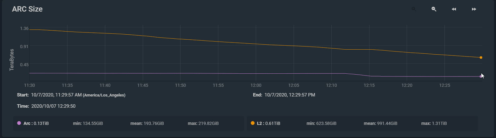

kstat.zfs.misc.zio_trim.bytes: 3200663879680
This is 2.91T of data that was TRIMmed since your last boot; if that's your L2ARCs doing that, this could be hurting things.
Can you issue camcontrol identify daX against your Toshiba SSDs and ZeusRAM devices, and post the lines related to/around:
Data Set Management (DSM/TRIM) no
If it's only your L2ARC that reports that it's handling TRIMs, let's drop the value of vfs.zfs.vdev.trim_max_active from the default 64 - I'd start with an aggressive drop to like 16 or lower.
This could also be impacted by how aggressively Hyper-V is trying to reclaim the space. VMware throttles the deletions via the VMFS space reclamation rate - if there's no equivalent throttle in Hyper-V, it could actually be the hypervisor itself where the bottleneck is being hit. From the perspective of the hypervisor, the iSCSI LUN is a SCSI device with a fixed queue depth - and if the hypervisor has no throttle, it might be clumsily stuffing that queue with deletes.

Thanks again for the insight HoneyBadger I did do the following -
I ran this, but it appears that the command doesn't work against these SAS devices and with the "semi-equivalent" inquiry command I'm not finding anything that seems to be relevant around TRIM, even in verbose mode:
Discussing with the team we believe that you are 100% on the right track with the Hypervisor layer being responsible. Microsoft doesn't appear to have any related documents to tuning space reclamation and it would appear that it just goes as fast is at it can without any sort of throttle.
I'd still be happy to do some tuning here and report back.

Let's do a quick and dirty test here - issue this command on one of your lab Hyper-V hosts to disable TRIM/UNMAP entirely, migrate a machine off of it, and see if things choke again.
fsutil behaviour set DisableDeleteNotify 1

Thanks again HoneyBadger, you keep on nailing these problems right on the head. I disabled TRIM and migrated off and VOILA! there was no latency spike or issue there. I have opened a case with Microsoft support to discuss this "feature" and will report back on whether or not there is a tunable buried somewhere in the operating system to throttle.

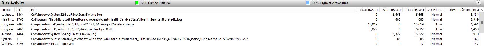

Afternoon all, sorry to be a thread necro, but there is some traction from Microsoft on this. I'm going to be building up this environment again to provide relevant/necessary data and anticipating encountering the same issue.
Thanks for the update. I'm curious to try reproducing this myself (since I spend very little time with Hyper-V) to see if there's a way to throttle the deletes on the FreeNAS side of thing.
ReFS/NTFS deletes are likely where we're leaning here for the throttling mechanism.
(And having the variable present in Hyper-V/Windows itself to tune is also valuable, so let's not discourage Microsoft from doing something to benefit the end-user for a change. ;) )
Look forward to seeing what they come back with, experts engaged.
