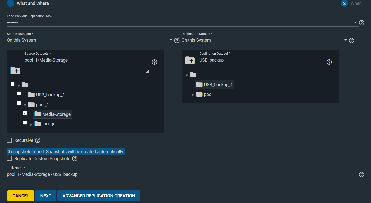

I believe I got the USB drive setup correctly. I realized the striping or raidz# options were not something the GUI wound up asking you to make a selection about probably because it was only a single disk. The guide I was following was old. I now have a pool on the usb drive called usb_backup_1.

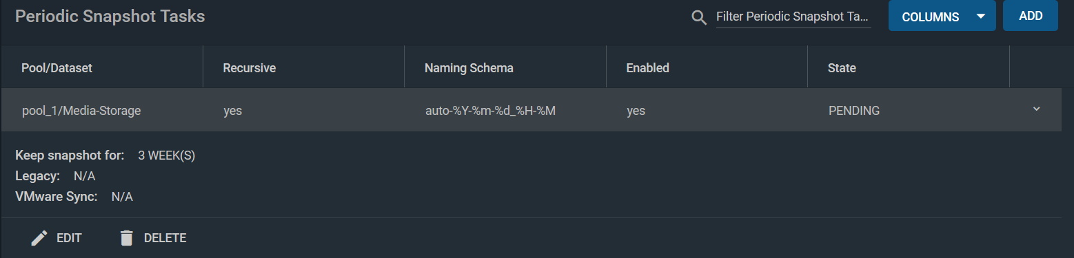

I also setup a periodic snapshot task of the pool (media-storage) I want to backup. The status of it seems to be staying as "pending". I have the begin and end times of the snapshot set as the defaults which is 00:00 to 24:59. Does freenas run tasks every few hours? I need that periodic snapshot task to run because I noticed if I try to now setup the replication task, it says there are no snapshots of media-storage and that a snapshot will be created. I already made a snapshot tasks (the one that is stuck pending) so I don't want to setup the replication task and have it create snapshots if my periodic task is already set to run.
Is there a rule of thumb for how long to set the snapshot lifetime for? The data in this pool is all historical and doesn't change much. Small additions are made from changing word doc files or new photo uploads occasionally. I saw the default was 2 weeks. I made it 3 weeks. Will I need to manually delete snapshots from the usb drive eventually to avoid it filling up? The freenas sounds like it will take care of old snapshots by deleting them due to that 3 week lifetime limit.

The "Snapshot retention policy" in your replication definition will allow you to set the job to harvest old snapshots same as the source pool, or to have a custom one. If the data delta is small, no reason not to set it to longer on the USB.
There's no rule of thumb, it's how long *you* want to keep the snapshots for *your* potential recover purposes. Generally more is better for an archive destination which this basically is. If you expect to sometime have to recover a deletion made a few weeks ago, set it to long enough to do that. You can worry about hitting the 8TB HDD limit when you get there.
