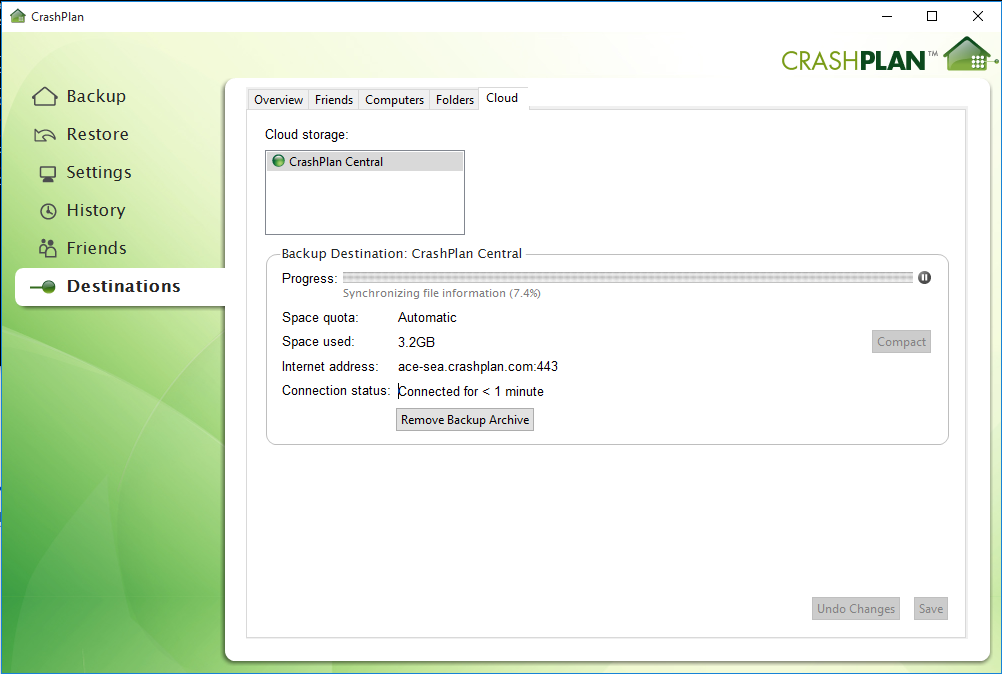

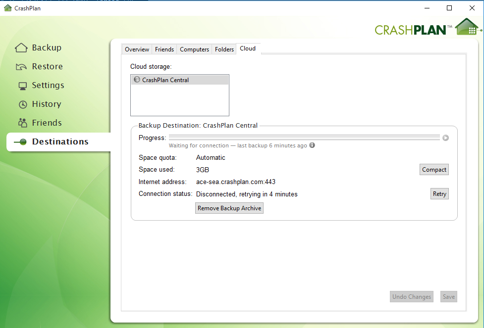

Hi All... I've managed to get the Crashplan plugin installed and over the course of the past day or so, it upgraded to 4.4.1, which is in sync with my CrashPlan Client. I've gone through the steps to connect to the backup service via a remote client, which is working great. The issue I'm seeing is that the service continues to get disconnected from CrashPlan Central. I've tweaked the run.conf memory allocation, cleared the cache, and verified I can access CrashPlan Central via telnet on port 443.
The History log shows lots of "... The backup destination was disconnected"... errors.
The attached images show that the client connection is working and that the engine is able to connect and start the file synchronization. That process never completes, however as the connect is reset.
