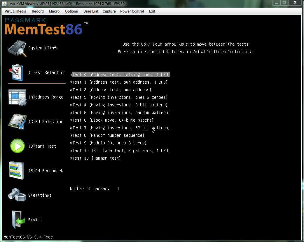

joeschmuck
Old Man
May 28, 2011
10,996
V6 by default I think is set for 4 passes and then stop. I configured mine to test using all CPU cores and 50 tests which will feel like it will run forever but after a few days I just manually stop it. I wish there was a selection to test for xx hours as well.

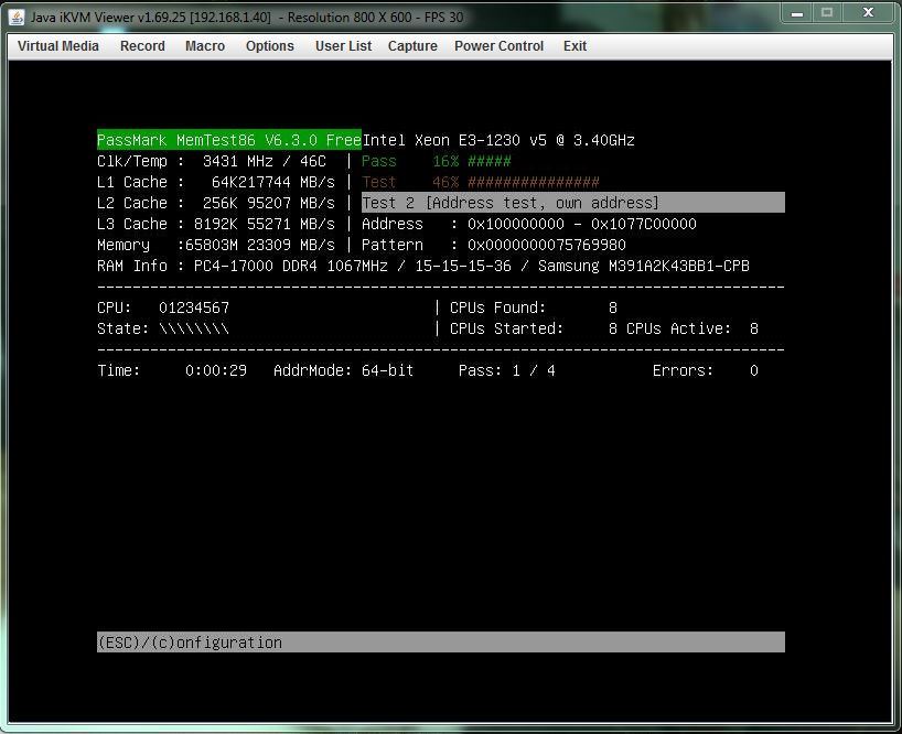

Nov 11, 2014
1,174
Honestly I am not sure that I understand the benefits of changing the defaults ?! Is it using only 0ne core if you don't change it , which way is better ?!

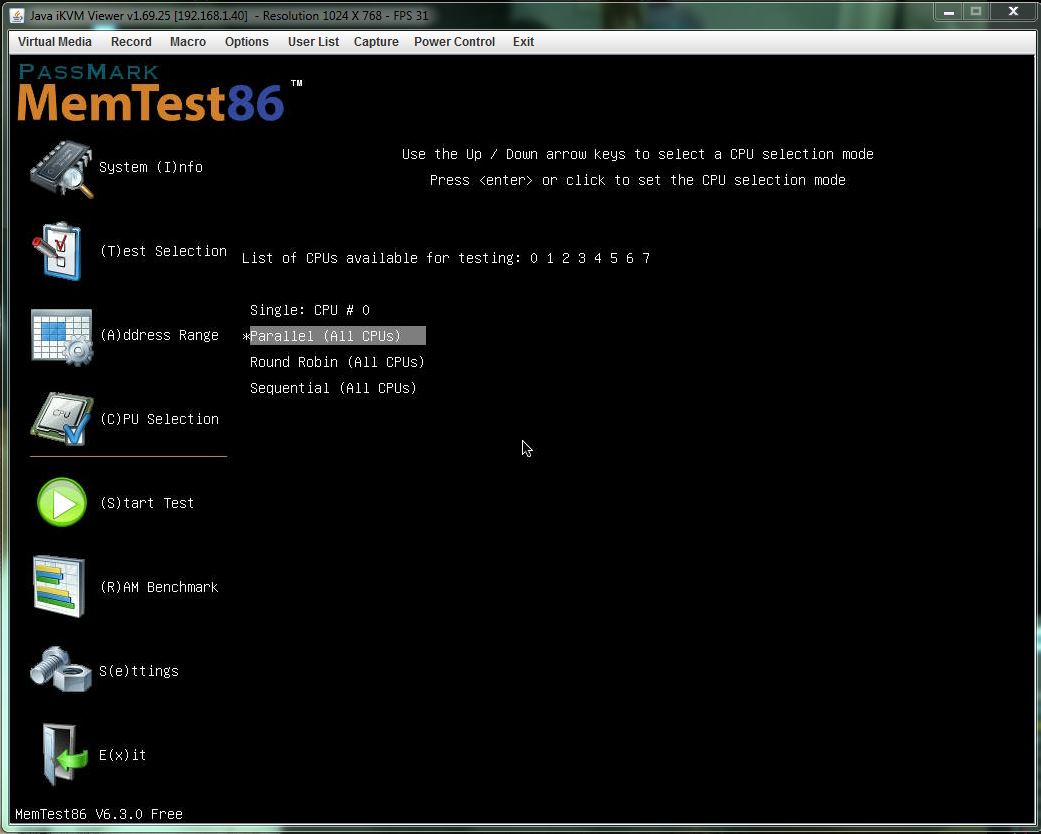

joeschmuck
Old Man
May 28, 2011
10,996
When you use more cores, you are actually using more bandwidth, well for my system at least. This puts the RAM and CPU through more stress than a single core and completes a full test cycle much quicker. There is a specific test (10 I think) which specifically checks timing for how long a memory cell retains data, or something like that which is counted in seconds, but everything else runs very fast.
Honestly, I'm not sure if there is any real benefit other than just maxing out the bandwidth but it's an option that can be used. There is more info about this on the internet somewhere.

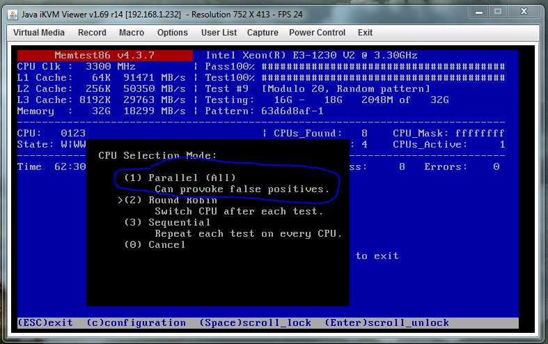

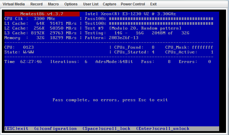

Nov 11, 2014
1,174
Maybe is not beneficial at all, it could be even negative to use all cores in parallel. Look the pic.

joeschmuck
Old Man
May 28, 2011
10,996
Here are some of the screenshots from my system. Note that there are no warnings about false positives and I believe that is due to the updated code.

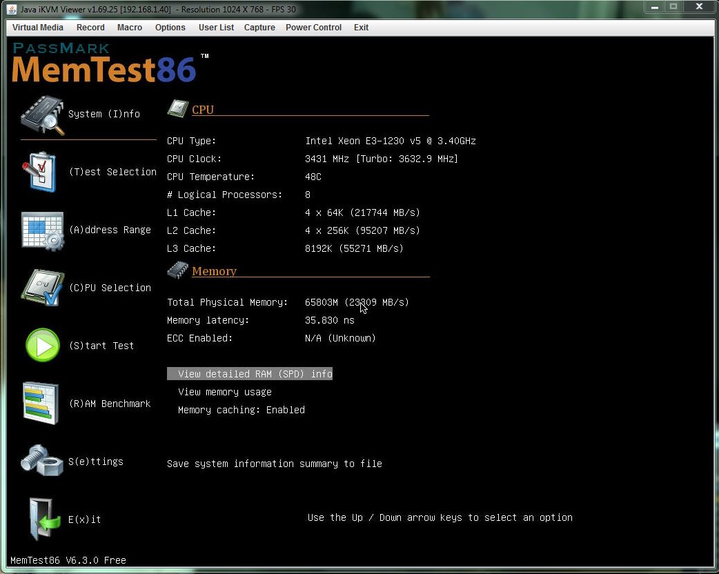

Nov 11, 2014
1,174
I guess new V6 dosn't have that warning. I'll do the same this like you setting it up on all cores.
P.S. Boy you L1, L2 cache is much faster than mine. But I have "ECC Enabled: YES (ECC)" not unknown !?
joeschmuck
Old Man
May 28, 2011
10,996
Because you have the paid version. Wish I knew which part of the exe file to alter to trick it to thinking its the paid version. I only want to test it out completely but like I said, I'm a tight wad, I don't need this tool for that much money. Maybe I'll contact the developer to see if they wouldn't mind selling me a home use version for less money.
