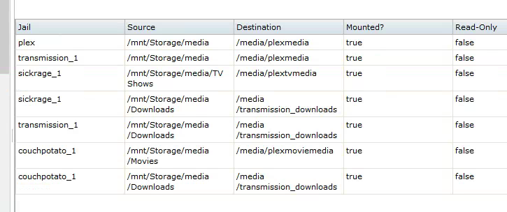

Couchpotato, even though it's set up the same, can't. My problem is this:
If I set the download directory within couchpotato to anything other than the default location (which I have no idea where that is because it doesn't tell you) I get permission denied errors in transmission.
Am I correct to assume the permission denied is coming from the couchpotato jail, and not the transmission jail?
On couchpotato I mount 2 folders in /media. 1 of them is where I want my download to end up, the other is where I "cache" the download (for seeding):
I've used this guide to permit write access to the storage:
https://forums.freenas.org/index.ph...plugins-write-permissions-to-your-data.27273/
My user ID is in the jail and owns the folder mount points:
Here is my user ID in freeNAS, to show that the user ID's are the same:
Here's the jail's rc.conf:
Here is showing you that my user owns the /var/db/ folder for couchpotato:
No matter what I seem to do I get errors writing to my dataset from this plugin only. What could I possibly be missing?

Well I'm not sure what I did but I got it working.
I did a couple things after doing the above:
I changed the mount point /media/download_cache to /media/transmission_downloads (which is what it's called in SR and transmission)
It didn't work after doign this either, because inside CP I needed to change the transmission download location from /media/transmission_downloads/couchpotato to /media/transmission_downloads.
Now it's working fine.

Sounds like there path transmission was reporting to couch potato was different that the path couch potato was using
ninjai
Apr 6, 2015
98
Yup, that's what it sounds like.
I'm still having trouble grasping how paths work with jail mountpoints. I mean transmission is a client. Like transmission on a linux OS, you open the torrent with the client, and choose the destination.
With the web front end, I wasn't sure if SR/CP were leveraging transmission for the torrent portion of the task, and using the SR/CP mountpoints as the destination paths (because that's what the front ends of CP/SR would let me navigate to).
Does that make sense?
In reality though, transmission needed the same mountpoints as SR and CP.

they need the same paths because transmission is told to write it to a certain location from CP, then CP looks in that location. if that location are different depending on which jail you're in the files won't be where they're expected.
it's pretty complicated. I prefer the way I do it, and have documented on my blog. all related plugins (sabnzbd/transmission/SR/CP) run in the same jail, run as the same user. makes things simpilier in my opinion.
