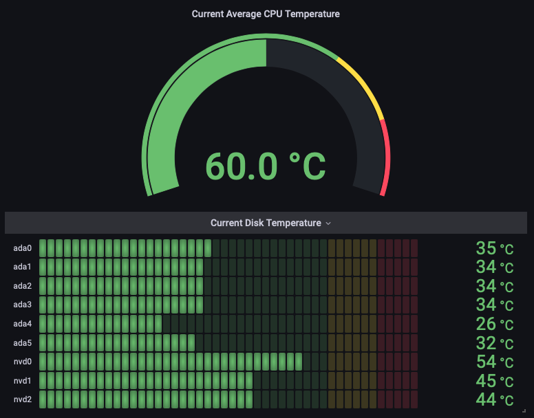

If you use the builtin reporting feature of TrueNAS which is essentially a (enhanced by iX) collectd, you can pipe that data into InfluxDB and Grafana running in a jail. Including CPU and disk temperatures. Sadly this feature is missing from the stock FreeBSD port, iX did not upstream their changes, and the port maintainer does not answer emails ... :frown: But in the TrueNAS context, it's the way to go, IMHO.
In my case this is a mini tower enclosure (see my signature for details). ada0-3 are the spinning disks for the "storage" pool, ada4-5 the 32 G boot devices (2.5" SATA SSDs). nvd0 is the Optane on the mainboard (M.2) serving as an SLOG for VMware --> NFS. And nvd1/2 are two Samsung SSD 970 EVO Plus on the same PCIe card you are using, serving as my VM and jail pool.
Temperatures are a bit higher than I would like them in my data centre, but this system is literally sitting in a cupboard at home, so that's good enough. No way to get it cooler without introducing a noise level I am not going to tolerate.
