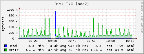

I am trying to understand why my freenas 9.3 continously writes to the 5 disks in the RAIDZ array of my freenas instance:
The writing takes place at ~150kB/s. The break between 21:00 and 21:15 was an update of freenas to the latest version.
I've already tried to shutdown the plex plugin or rsyncd both which had no effect.
System dataset Syslog and Reporting Database is both configured off.
Any idea what is writing to the disks?
Regards, Andreas

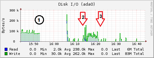

I spend some time today trying to identify the reason:
  • top -m io was inconclusive
  • stopping collectd didn't make a difference.
1. I checked and unchecked System dataset|Syslog and observed an error message: Unable to open new log file '/var/log/samba4/log.smbd': No such file or directory
so I created the log directory
[root@freenas] /var# mkdir /var/log/samba4
and unchecked System dataset|Syslog again. After a reboot the background writes were gone. Now I could see log files in the samba4 directory.
2. Trying to reproduce I checked System dataset|Syslog. What I could observe was a recycling of the log directory:
drwxr-xr-x 2 root wheel 160 Jan 12 16:53 log/
drwxr-xr-x 5 root wheel 800 Jan 12 16:12 log.20150112161525/
and some background writes again.
3. Unchecked System dataset|Syslog again. No more background writes but again the samba4 log directory missing. I had hoped the missing samba4 directory would cause endless writes on the system data pool.
Jan 12 16:21:08 freenas syslog-ng[9991]: syslog-ng starting up; version='3.5.6'
Jan 12 16:32:02 freenas smbd[10718]: STATUS=daemon 'smbd' finished starting up and ready to serve connectionsUnable to open new log file '/var/log/samba4/log.smbd': No such file or directory
Jan 12 16:32:02 freenas smbd[10718]: [2015/01/12 16:32:02.476970, 0] ../lib/util/debug.c:595(reopen_logs_internal)
Jan 12 16:32:02 freenas smbd[10718]: Unable to open new log file '/var/log/samba4/log.smbd': No such file or directory
Jan 12 16:32:02 freenas smbd[10718]: [2015/01/12 16:32:02.477207, 0] ../lib/util/debug.c:595(reopen_logs_internal)
Jan 12 16:32:02 freenas smbd[10718]: [2015/01/12 16:32:02.477505, 0] ../lib/util/debug.c:595(reopen_logs_internal)
Jan 12 16:32:02 freenas smbd[10718]: [2015/01/12 16:32:02.531418, 0] ../lib/util/debug.c:595(reopen_logs_internal)
Jan 12 16:32:02 freenas smbd[10718]: [2015/01/12 16:32:02.548134, 0] ../lib/util/debug.c:595(reopen_logs_internal)
My server shuts down during the night. Will keep you posted whether the background writes come back after a restart.

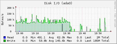

The continuous writing returned. Tonight it stopped when I turned off plex.
Some previous occasions the writes would only stop after shutting down the jail as well.
That seems pretty reproducable.

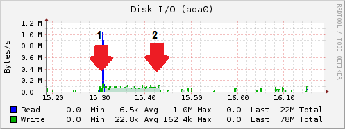

I changed plex to be off by default. So when I turn on plex at (1) I can observe continous writes to start and when I turn it off at (2) they stop.
This only happens since I upgraded plex to the latest version during my freenas upgrade from 9.2* to 9.3. Any idea how to configure freenas to turn the continous writing off?

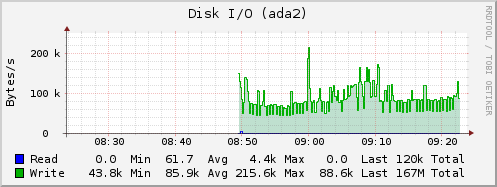

I often see this behaviour on 9.3. It seems to change whenever the server is rebooted. It's calmed down a bit today, but this is still a lot of writes for a server doing basically nothing.
No plugins here at all.

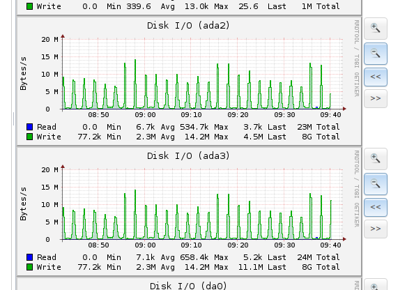

Fraoch
Aug 14, 2014
395
It never really changed, even now. The spikes have gotten higher. I wonder if this is because my Linux machine has the drive mounted permanently (through NFS)? It mounts it on boot and keeps it attached through fstab. There isn't constant access but perhaps the Linux machine "pings" it continuously.
I would have thought that would be reads though, not writes.

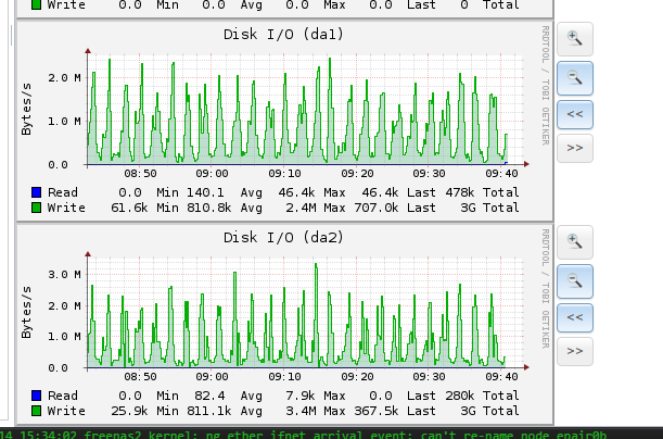

depasseg
FreeNAS Replicant
Sep 16, 2014
2,874
Disable the share and plugins and see if the activity goes away. I have a 12 drive backup pool, with no shares and is only used for ZFS replication. It's pretty much at 0 when replication isn't running.
Although, those spikes look a lot like the pools that have my system datasets.
.system:
My other .system:
Dataset only used for Replication:
Fraoch
Aug 14, 2014
395
There's been no change. By the way, I applied an update here. But you can see a small read where the share gets unmounted.
Aha, I think you're on to something here! Yes, my system dataset is indeed on my share pool, not my boot pool.
It's been a while since I've really worked with FreeNAS so I'm rusty on this, but should I move my system dataset to my boot pool? There must have been a reason I kept it on my main pool, I'm wondering what the recommendation was at the time (and now). Perhaps I was trying to avoid writes on my boot pool, which consists of two cheap SSDs, mirrored. They have more write endurance than USB sticks for sure, but it would still be best to avoid continuous writes. However they'd be cheaper to replace than the mechanical drives.
Should I move the system dataset to my boot pool?
Thanks for the advice, by the way, and thanks to kyp for resurrecting this.
