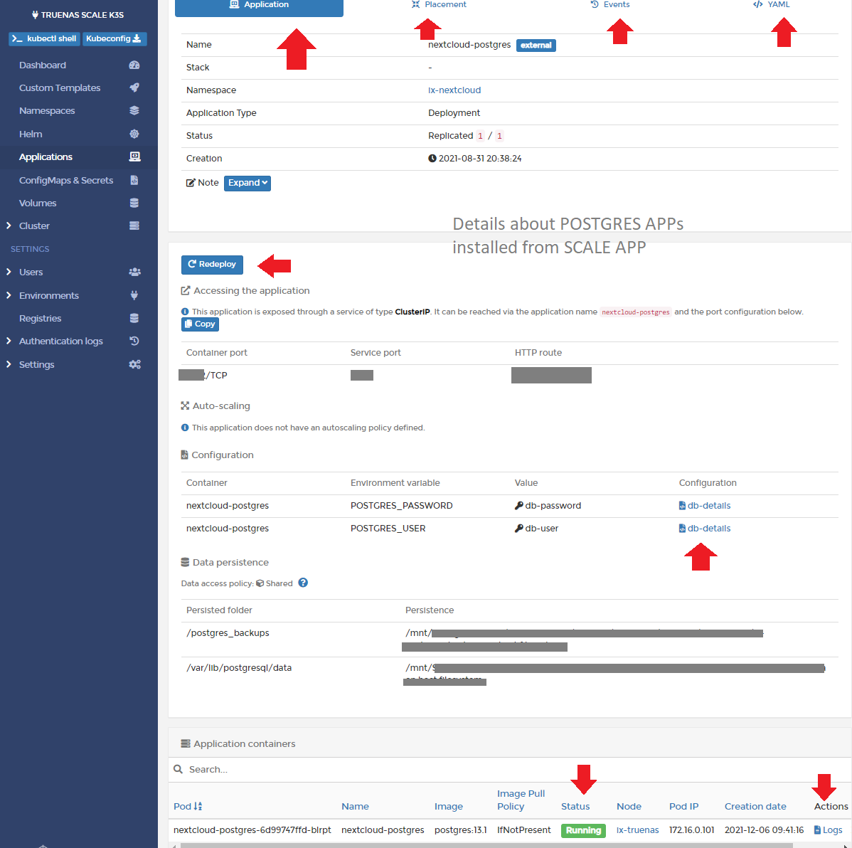

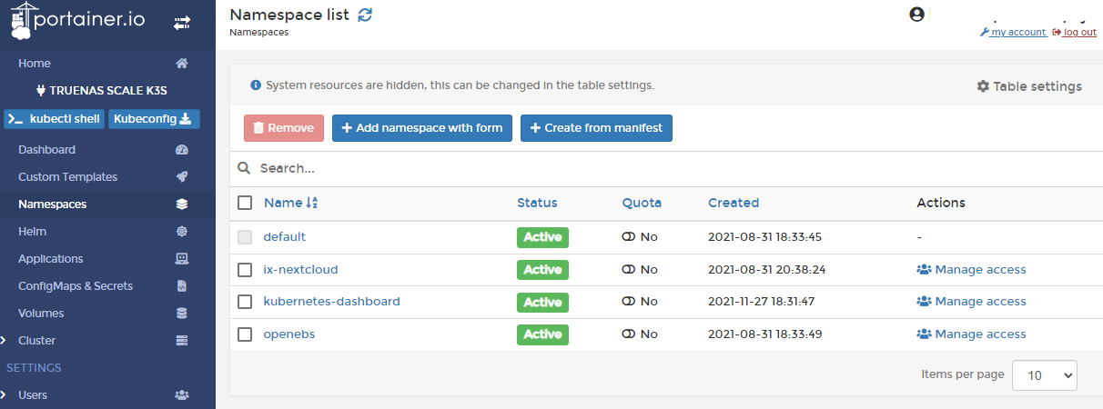

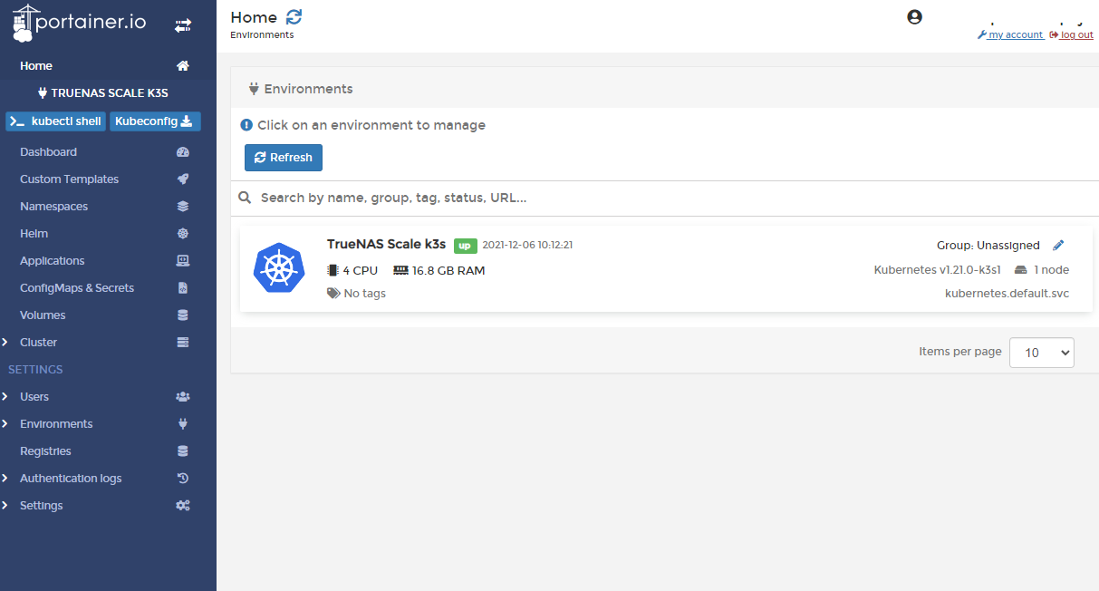

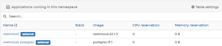

Some screenshots:
take it just a taster.
