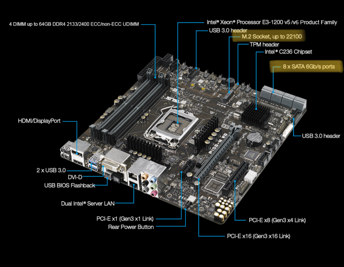

Hi Dave, thank you for your reply - It’s just what I’m getting from the spec’s sheet. Am I right in thinking there’s 8 or are 2 inactive / placeholder?

My BAD!
I looked up P10S-M but left off the WS from my search:oops: a completely different board.
You are of course right with your findings of the specs for you friend's board.
Having seen the correct specs, I'm now agreeing with @Chris Moore
(not the best choice of Mobo for a server). Sorry
To use all eight SATA ports with an M.2 SSD, you'll need a PCIe SSD, not a SATA SSD.
