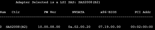

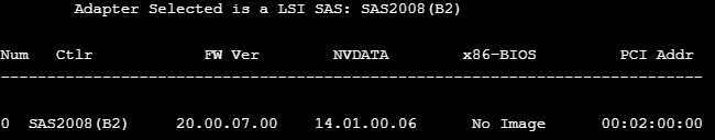

My 9210-8i appeared to be in IT mode already, but I thought I'd update it anyway, as the firmware seemed old.
This took me quite a while to sort out. I tried following this guide, but the link to Shell_Full.efi was stale and I couldn't find the right version (the newer versions don't work). I tried the FreeDOS route, but couldn't get my machine to boot from the stick I was using for some reason. I then discovered you could flash from the FreeNAS shell, and that worked nicely. However, I wanted to clear the firmware first so I could remove the bios, and for some reason you can't execute the clear command under FreeNAS. Eventually I found an old copy of Shell_Full.efi somewhere and was able to do the clear/flash from the EFI shell. There was much rejoicing.

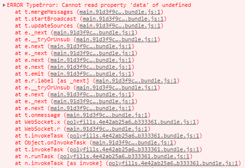

Only issue I've run into is the new FreeNAS dashboard seems to have a problem... the memory/cpu/load graphs don't work, and there's a javascript error or two in the console.
I saw the same thing when I was initially testing under VirtualBox. The problem went away when I installed direct-to-hardware, but now it's back under ESXi. Hopefully something they fix, but if it's related to being virtualised I guess they probably don't support it.
