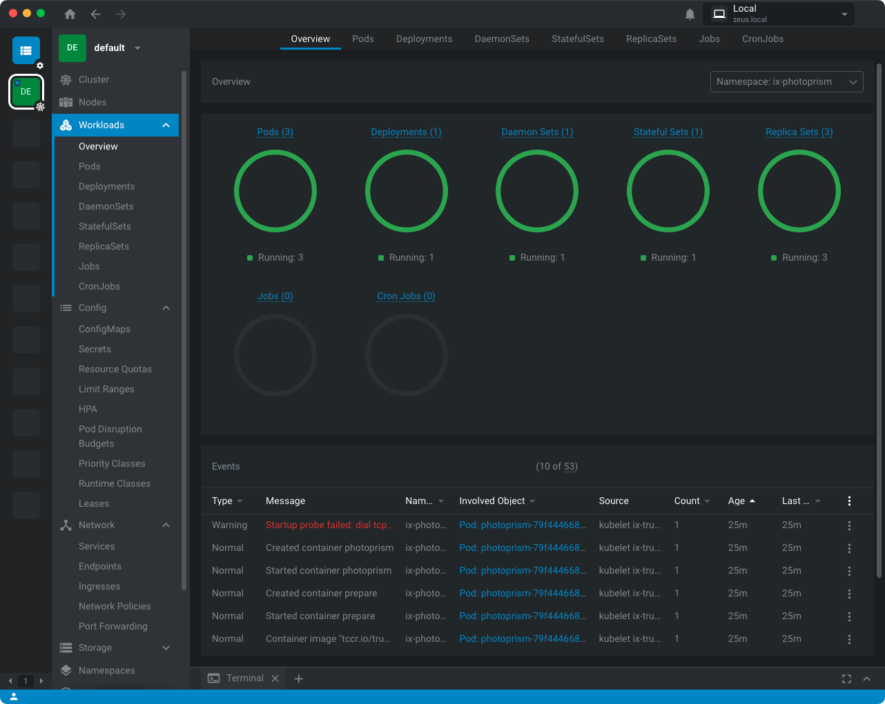

I would like to connect to Kubernetes running on Scale, with Lens. Output from my Mac,
k8 ports on Scale:
How do I generate the
I see port 179 and 50051, I presume one of these ports should be used for forwarding?
uranus.lan is the Scale server:Code:
$ host uranus
uranus.lan has address 192.168.1.8
$ kubectl version -o json
"clientVersion": {
"major": "1",
"minor": "25",
"gitVersion": "v1.25.3",
"gitCommit": "434bfd82814af038ad94d62ebe59b133fcb50506",
"gitTreeState": "clean",
"buildDate": "2022-10-12T10:47:25Z",
"goVersion": "go1.19.2",
"compiler": "gc",
"platform": "darwin/amd64"
"kustomizeVersion": "v4.5.7"
The connection to the server localhost:8080 was refused - did you specify the right host or port?
k8 ports on Scale:
# netstat -tulpn | egrep 'kube|k3s' tcp 0 0 127.0.0.1:10248 0.0.0.0:* LISTEN 16127/k3s server tcp 0 0 127.0.0.1:6444 0.0.0.0:* LISTEN 16127/k3s server tcp 0 0 127.0.0.1:10257 0.0.0.0:* LISTEN 16127/k3s server tcp 0 0 192.168.1.8:179 0.0.0.0:* LISTEN 18655/kube-router tcp 0 0 127.0.0.1:10259 0.0.0.0:* LISTEN 16127/k3s server tcp 0 0 127.0.0.1:43797 0.0.0.0:* LISTEN 16127/k3s server tcp 0 0 127.0.0.1:50051 0.0.0.0:* LISTEN 18655/kube-router tcp 0 0 192.168.1.8:50051 0.0.0.0:* LISTEN 18655/kube-router tcp6 0 0 :::10250 :::* LISTEN 16127/k3s server tcp6 0 0 :::6443 :::* LISTEN 16127/k3s server tcp6 0 0 ::1:179 :::* LISTEN 18655/kube-router tcp6 0 0 :::20244 :::* LISTEN 18655/kube-router
.kube/config file on my Mac? This way I don't have to port forward anything.I see port 179 and 50051, I presume one of these ports should be used for forwarding?
