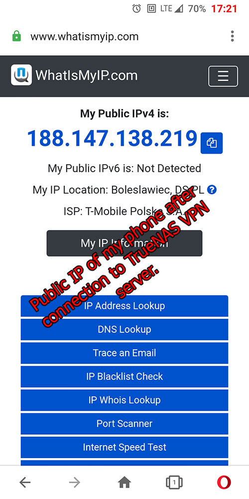

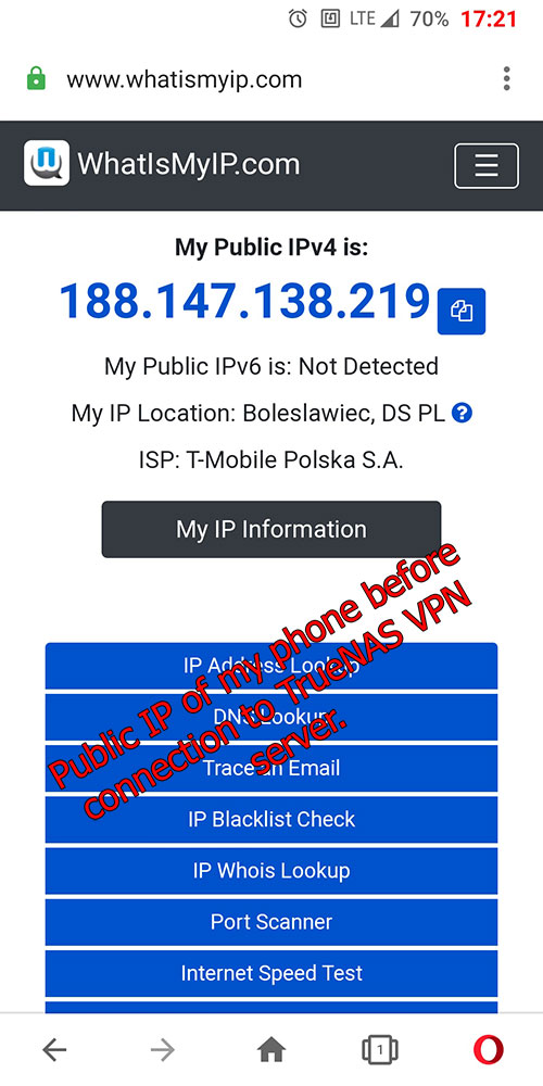

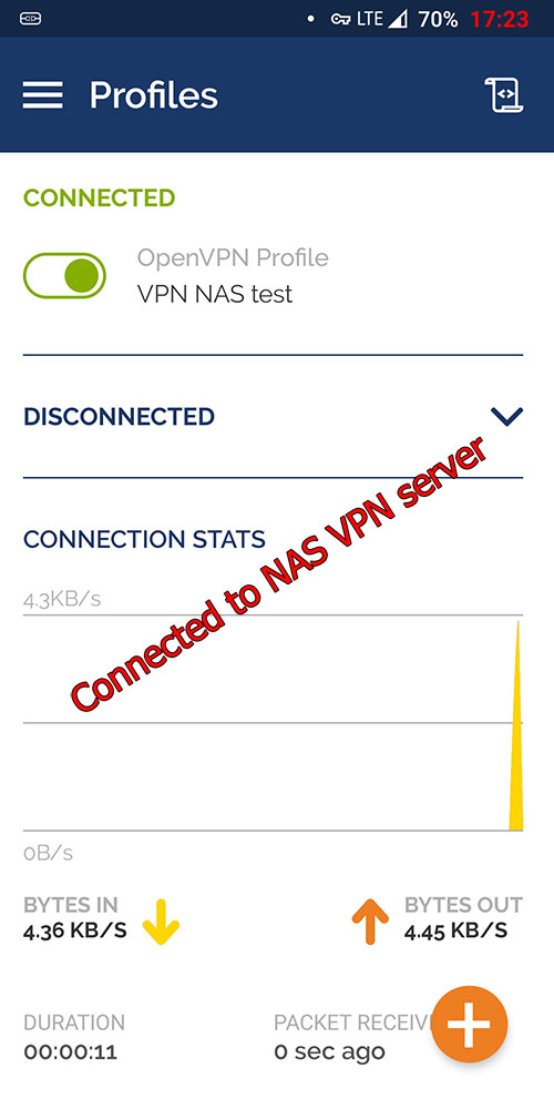

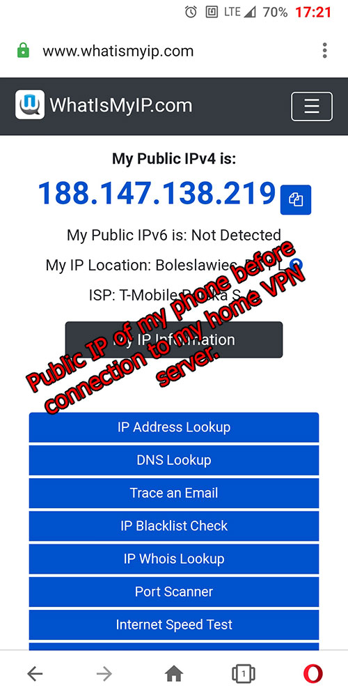

Unfortunately, I have a problem with the connection. Using the phone as a test client, I can connect to a running VPN server, but the phone's public IP remains unchanged. It looks like it has connected to a VPN service but no tunnel has been created. In such a situation, I cannot access any data.

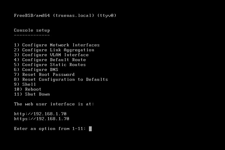

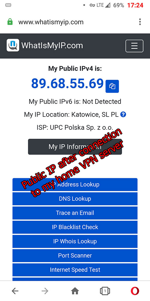

My home router's public IP is 89.68.55.69. Connecting to OpenVPN with TrueNAS looks like this:

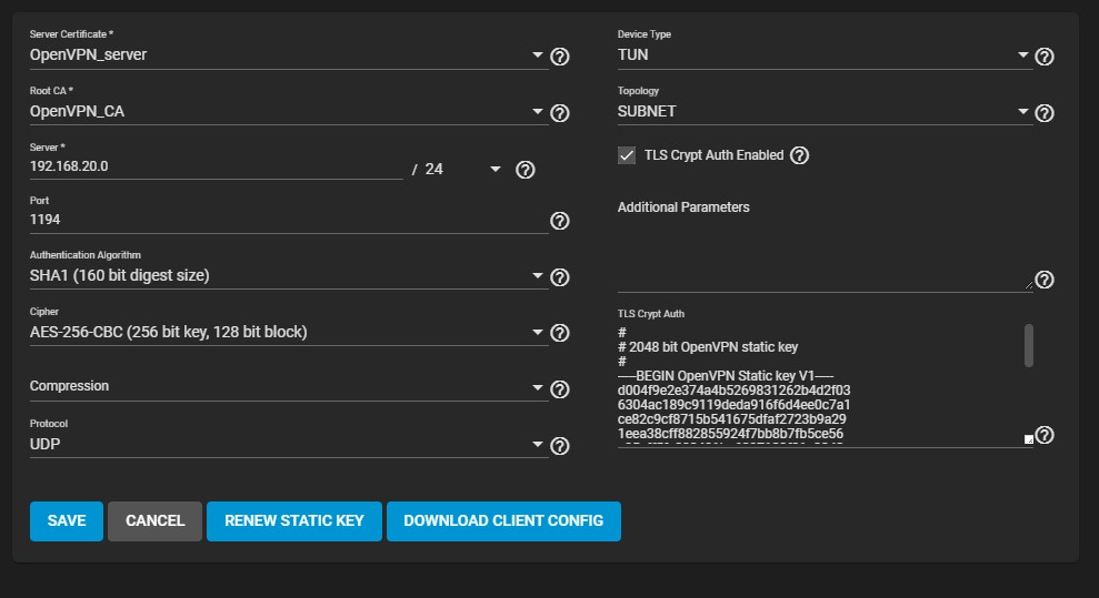

And here is the NAS IP and server configuration:

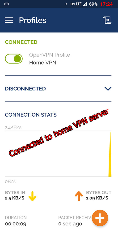

I think that my home router is correctly configured because I also use a private VPN running on Win10 and there is no problem there. With each connection, the client's public IP changes to the IP of the home router and I can easily access the shared data.
Could someone please help me find a configuration bug?
