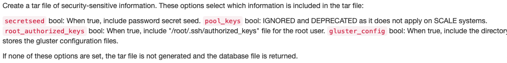

there is a bug in truenas scale API, if you call without any parameters, you will get a backup, but with add any parameter you will get an error
works:
curl -X 'POST' \
  'http://192.168.1.200/api/v2.0/config/save' \
  -H 'accept: */*' \
  -H 'Authorization: Basic AUTH' \
  -H 'Content-Type: application/json' \
  -d '{}' --output file
does not work:
curl -X 'POST' \
  -H 'accept: */*' \
  -d '{"secretseed": "true" }' --output file
there is an issue with evaluating values, as they are not converted to boolean

@Daisuke, the correct syntax for the API-driven configuration save is midclt call core.download "config.save" '[ {} ]' "config.tar". This will result in output
[<job id>, "/_download/<job id>?auth_token=<auth token string>"]
You can then curl --output "config.tar" https://<TrueNAS server IP>/_download/<job id>?auth_token=<auth token string> to retrieve the saved config.
