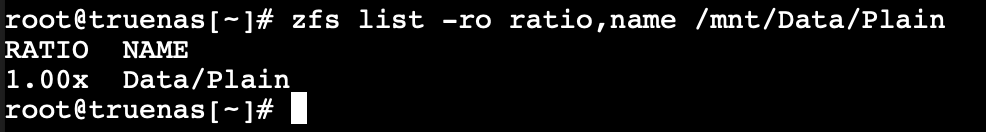

What does the web UI say under Storage -> Pools? It has a Compression Ratio field for every dataset. Is it a number above 1.0? Alternatively, you could also do zfs list -ro name,ratio <dataset_name>. That will probably be a more authoritative source than the du command, which was never built with ZFS in mind.

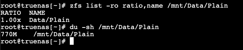

The ratio always says 1.0
And the size with du is 770M
but i am still confused if the shell says M for MB or M for MiB
The GUI says 770,77 MiB
It makes a huge difference when I compare those facts on bigger files :-(
The general rule is, OS's generally always use MiB, while hardware manufacturers (HDD) use MB. Your ratio says 1.0, which means no compression is currently taking place.
