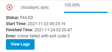

I have been trying to send my data to Backlaze b2 (encrypted) and every time i tied, it fails
This is the end of the log file
2021/11/24 01:55:18 INFO  :
Transferred:           1.634G / 1.634 GBytes, 100%, 409.473 kBytes/s, ETA 0s
Errors:                26 (retrying may help)
Checks:           6032727 / 6032727, 100%
Transferred:         9204 / 9204, 100%
Elapsed time:   16h30m2.2s
2021/11/24 02:00:18 INFO  :
Transferred:           1.634G / 1.634 GBytes, 100%, 409.465 kBytes/s, ETA 0s
Checks:           6045615 / 6045615, 100%
Elapsed time:   16h35m2.2s
2021/11/24 02:00:47 ERROR : Encrypted drive 'encrypted:/': not deleting files as there were IO errors
2021/11/24 02:00:47 ERROR : Encrypted drive 'encrypted:/': not deleting directories as there were IO errors
2021/11/24 02:00:47 ERROR : Attempt 3/3 failed with 27 errors and: march failed with 24 error(s): first error: directory not found
2021/11/24 02:00:47 Failed to sync with 27 errors: last error was: march failed with 24 error(s): first error: directory not found

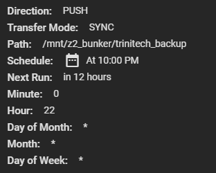

The task is set to push/sync
Could anyone please advise on how to resolve this? The dataset is 375GB, could it be too big?
