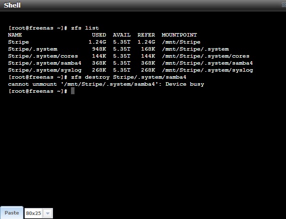

I am also facing the exact problem. I m on 9.2.1.2. Few days ago, I was able to copy and write data into my system and suddenly the next morning when I booted my system and everythings works fine but I am not able to connect to my share through map network drive. I am also not able to see FREENAS in My network places. When I login to the admin, and in services I found CIFS off..I tried to start, but got the message " Service could not be started". Reinstalled the pendrive, autoimported the volume, created users and groups again as before, but no success, CIFS not working.
I have not done any changes, and how suddenly that has happened I am not able to figure it out. Please guide what to do..as i have valuable data on my system.
rahul
Jul 9, 2013
25

Per the bug report - the issue in #4194 was fixed in 9.2.1.1. Honestly, you can't begin fixing a problem till successfully diagnosing it. A part of this involves reviewing log files. If you skip this process then you are likely to create new problems and make it that much harder to diagnose an fix the original issue.
Rahul, you should start a new thread since your problem may not be related to the problem reported here.
anodos
Sambassador
Mar 6, 2014
9,553
Rahul,
Please start a new thread in the forums for this problem.
In it post the following:
- a detailed summary of hardware in your computer.
- output of 'testparm'
- information from log files (/var/log/messages /var/log/samba4/log.smbd /var/log/samba4/log.nmbd. In your case, try to start CIFS then immediately view the logs.
- detailed description on your problem including windows version and freenas version
- list all troubleshooting tasks and changes you've made since the problem appeared.
One method of accessing log files is to SSH into your server and type ‘cat /var/log/messages'. Repeat for other logs. Copy and paste info out of it.
