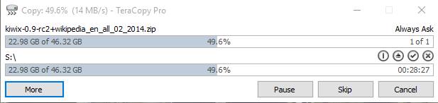

I am getting ~17-20MB/s writes to the array over CIFS but can get ~90MB/s per interface from the local SSD on my PC over the 10GB NIC or about the same over 1Gb to one NIC on the array. It is just CIFS reads that seem to suck. Maybe that's my fault, I might need an adult, or cyberjock to point out what I am doing wrong. Let me know anything I can give you guys, or provide clarity on, anything, just let me know.
Chassis: CSE-846BE2C-R1K28B
RAM: 64GB of MEM-DR432L-SL01-ER21
CPU: Intel 2.20GHz Xeon E5-2630 v4 Deca-Core
Hard Drives: [12 in 6+6raidz] HGST Hard Drive 8TB SAS (HUH728080AL5200)
Motherboard: Supermicro X10DRi-T4+
S:\ is a SSD scratch drive, R:\ is a 3 port LACP and T:\ is a single gig port in the images.

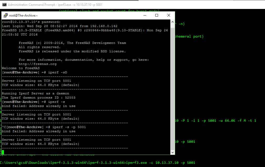

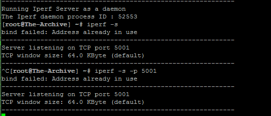

Might need an adult, I can not get data back from iperf.
client side : iperf3.exe -c 10.13.37.10 -P 1 -i 1 -p 5001 -w 64.0K -f M -t 1
Serverside : iperf -sD
SweetAndLow
Sweet'NASty
Nov 6, 2013
6,421
Try iperf3.exe -c 10.13.37.10 -p 5001 skip all this other flags. And in the server use iperf -s -p 5001
gcs8
Feb 14, 2014
39

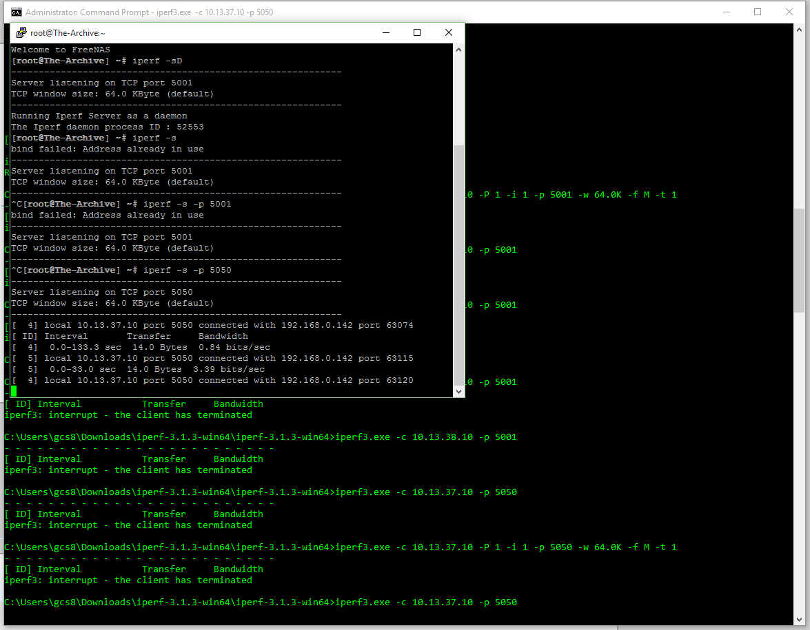

I don't think it like me.
SweetAndLow
Sweet'NASty
Nov 6, 2013
6,421

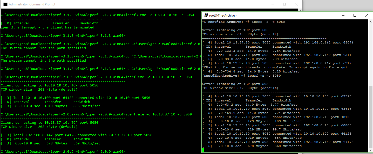

Pick a different port, try 80800
gcs8
Feb 14, 2014
39
I think it still hates me, is this one of those issues with iperf3?
SweetAndLow
Sweet'NASty
Nov 6, 2013
6,421
Looks like your network is not sending packets correctly. Try plugging your server into your client and configure static IPs. This will eliminate all possibilities of switch failure. Also check or replace your Ethernet cable.

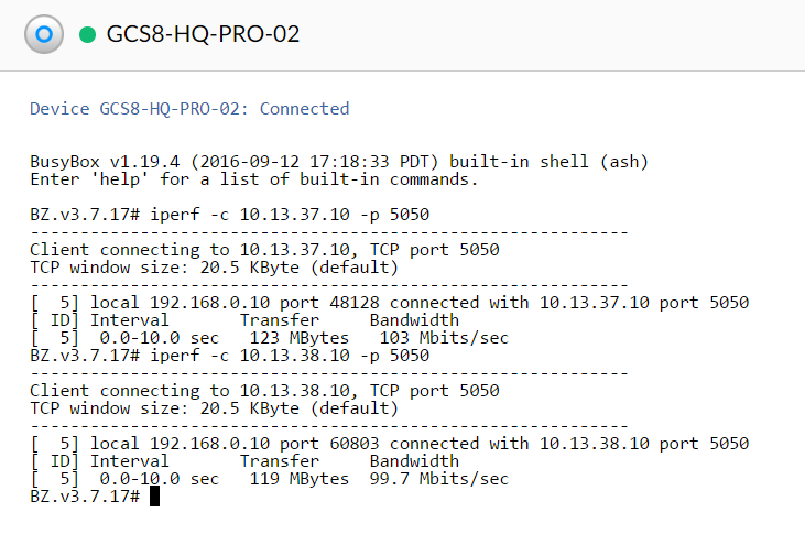

might be iperf3, it works from my AP.

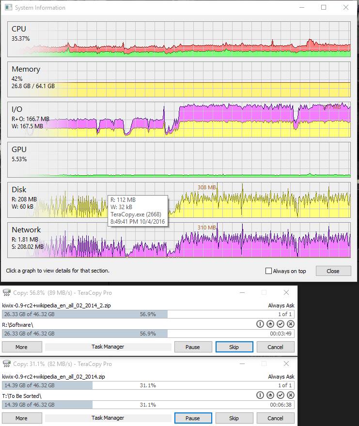

Also did the lagg just for fun
SweetAndLow
Sweet'NASty
Nov 6, 2013
6,421
Not really working, you are only getting 10% of your maximum speed.

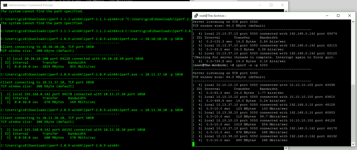

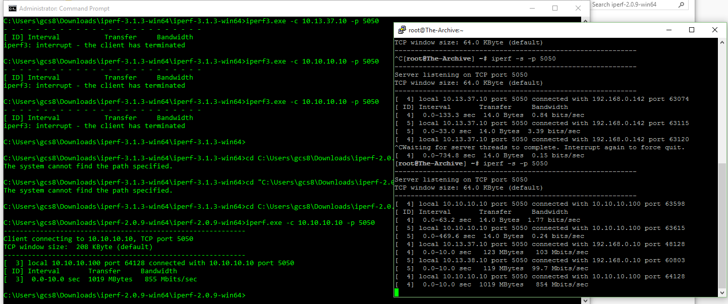

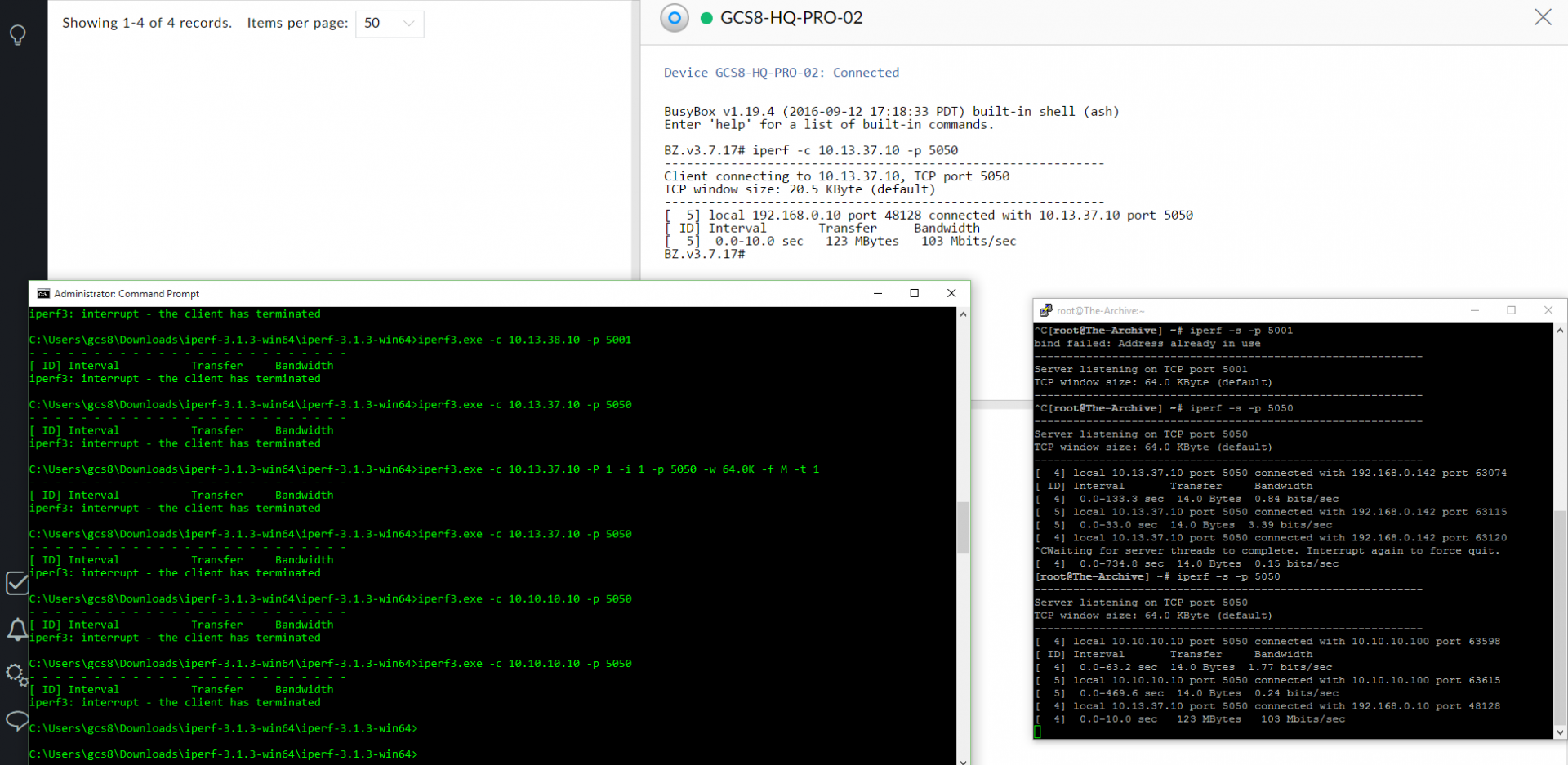

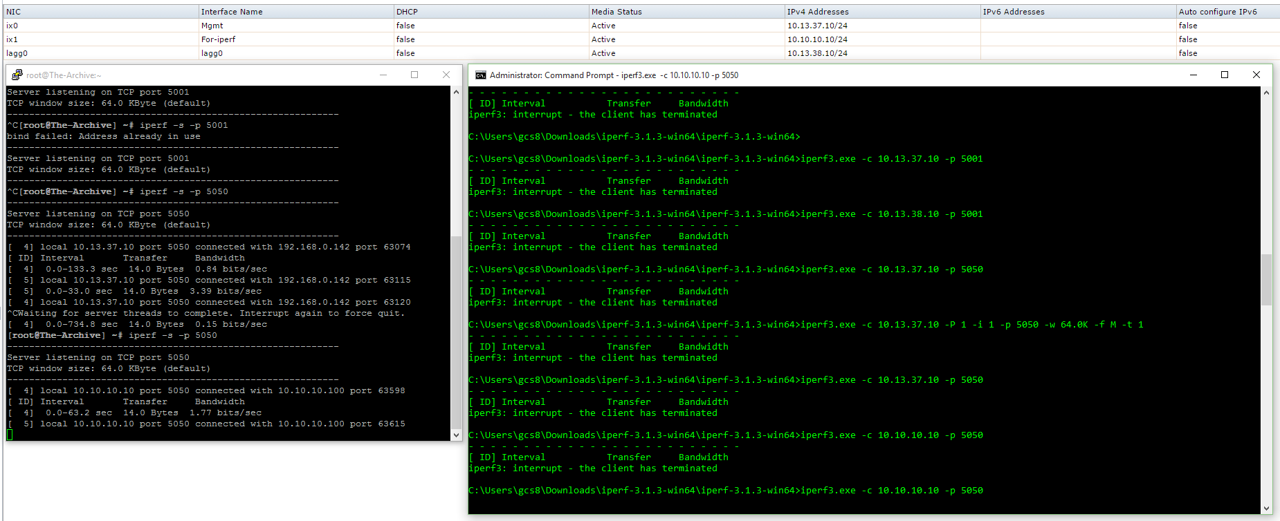

ok, it was an issue with iperf3, went back to iperf 2.0.9
eth to eth
10G to 1g
10G to lagg
gcs8
Feb 14, 2014
39
Yeah, the access points are not high on CPU power, it showed me that iperf was working FreeNAS side, and got me away from iperf3 desktop side.

Well it looks like your 10gig doesn't work. Your 1gig is working for the most part.
