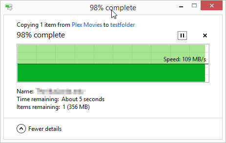

  2. Sequential writes to the shares can ALWAYS max out my GBE, hovering around 109-112 MB/s. This is an example 20 gig file transfer, to show you how solid it is. When it finishes, hard drive activity stops immediately. The drives do not have to catch up to the RAM cache or anything. Picture of the write transfer:

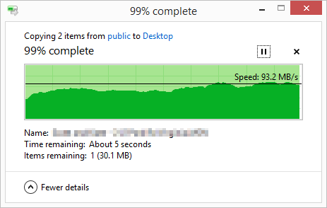

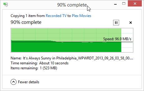

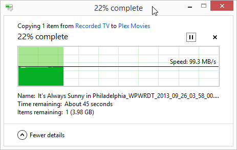

  3. When I first sequentially read a file from a share, it hovers around 90-100 MB/s. If I cancel the transfer mid-way through...(shortly after this point:
    2014-04-01 18_03_24-22% complete.png )
    ...and then read the same file again, it will peg around 110 MB/s until it gets to the point where I cancelled before. Then it will slow back down to the 90-100 MB/s speeds I was originally getting. You can see this effect here:

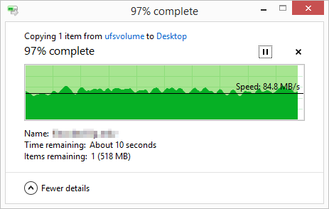

OK. But my disks are multiple times faster than my network. Seems like that should be fast enough if the buffer between Samba and ZFS is being managed well. If Samba is starving for data to send, shouldn't it be requesting data off the disk that is "further ahead" of the transfer.
Going UFS is crazy stupid. UFS is basically discontinued in FreeNAS. It has no real cache at all, has limited RAID formats it supports, has no protection from data corruption that makes people want ZFS, need I say more?

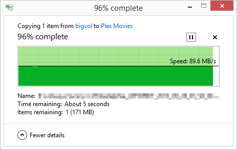

I meant just to test my crazy self-tuning theory. I tried testing it today but could not make a UFS stripe out of any of my spare disks that would go above 140 MB/s, which left me thinking that I cannot trust the results. But when I did a test from UFS cache, I was seeing a solid 96 MB/s. I am discarding this result because I don't know enough for it to tell me anything. Although it might be suggesting that this is a Samba issue because Samba is not even serving files out of cache at max GBE (if you assume max is 110 MB/s). I'll admit I'm working on a lot of assumptions here which is why I'm not very sure of anything until I find a smoking gun.

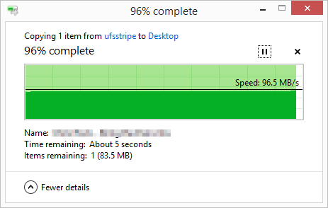

Without digging into all of cyberjock's concerns yet, I did a quick test. My intent was to do a quick test that had a possibility of eliminating disk performance as a root cause. I changed my 6 disk RAIDZ2 to a 6 disk stripe. I turned off compression and then wrote my test files to it, in a manner that appears sequential (but which may not be per cyberjock). They again wrote at around 110 MB/s via CIFS and would only read at around 90 MB/s. So I feel like I can rule out disk performance as the root cause in this case. Something else is happening, there is an inefficiency somewhere.
Out of curiosity I went to test on my other computer which has an SSD. That machine had some high peak reads over the network when the transfer first started. Maybe related to bursts coming from the NIC buffer which never bursted so high over the network. But then it settled down to around the same as the original machine.
I'm not sure if I want to give up on this or keep after it. Maybe I will buy an intel NIC for the clients just so that I can sleep at night having eliminated another possible root cause.
