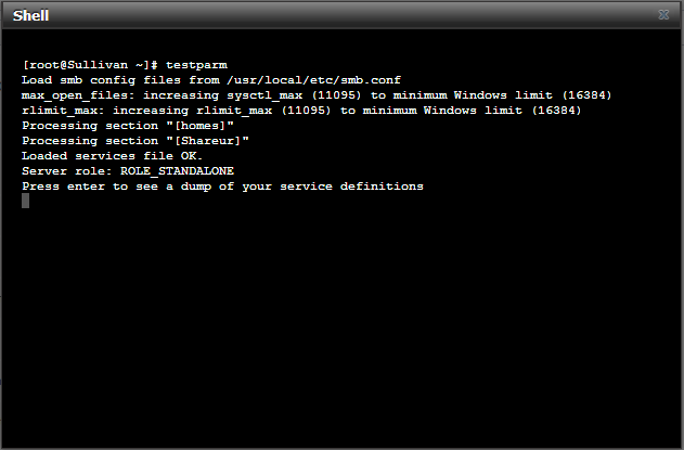

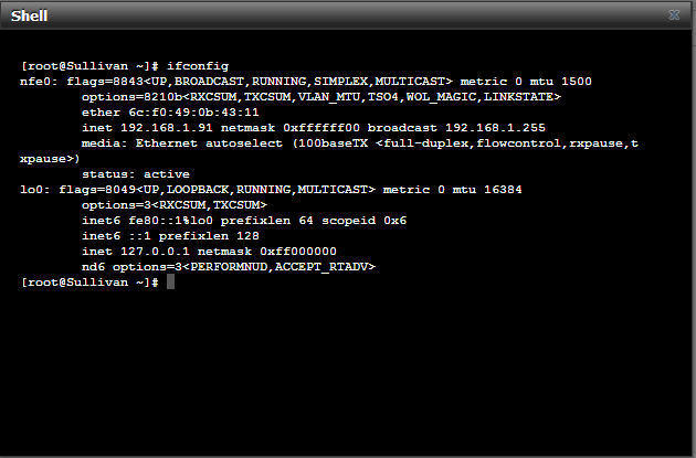

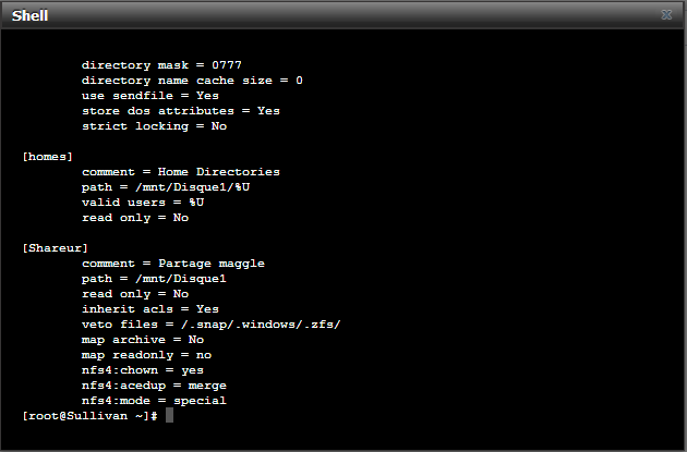

Your problem could be hardware, software, or network-related [in short - it could be almost anything]. Giving more information will help diagnose the problem.
Please give list of the following:
  • hardware in your computer
  • version of FreeNAS and operating system from which you are attempting to access share
  • brief description of your network
Review and upload the following:
  • console messages [/var/log/messages]
  • smbd logs [/var/log/samba4/log.smbd]
  • nmbd logs [/var/log/samba4/log.nmbd]
  • ifconfig output
Running "testparm" from console will also give some indication of if you have misconfigured CIFS.
While testing it may be a good idea to disable antivirus, firewall, and other security related software on the client computer.

  • Idon't use samba, so i've no logs. I got into the folder "Samba" but i didn't found logs.
  • Ifconfig in attached files.
  • TestParm in attached files.
Sorry if I didn't answer every questions.
Moebius :)
