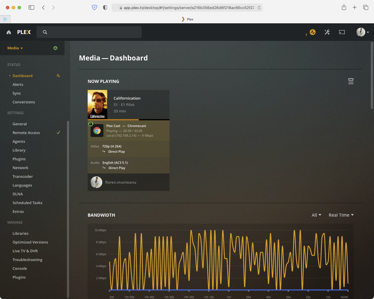

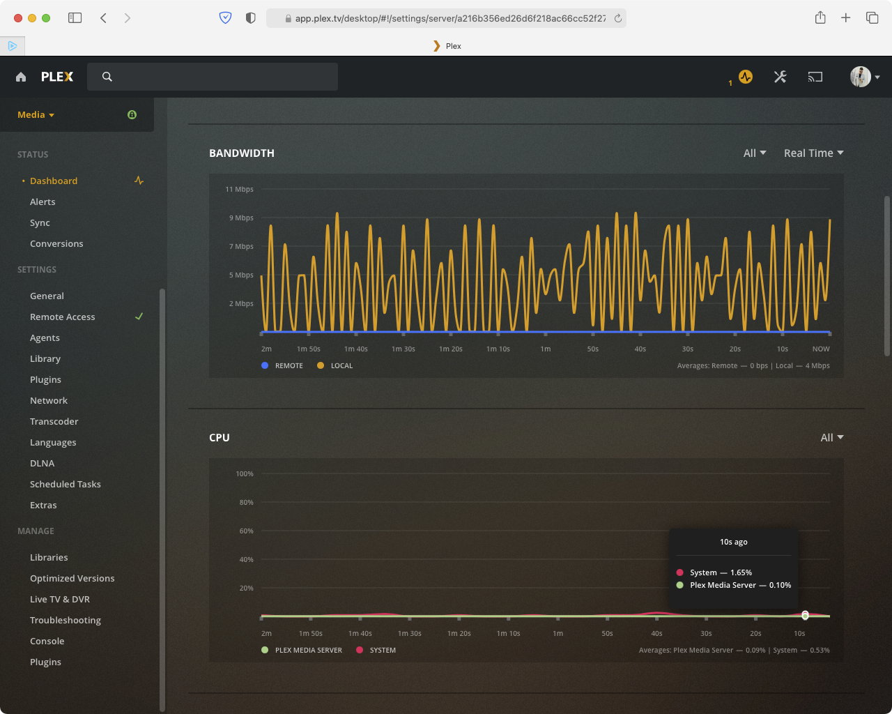

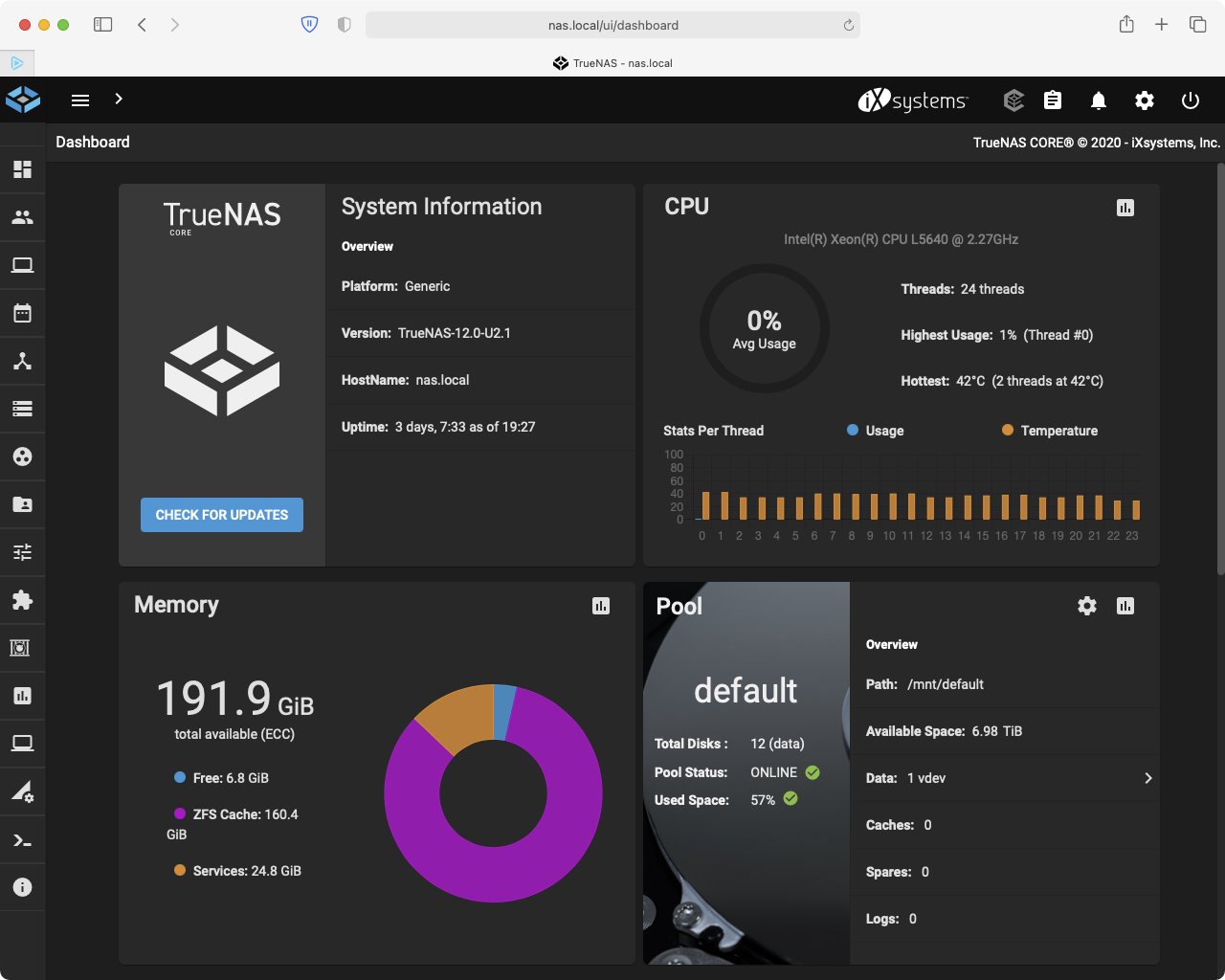

Running TrueNAS-12.0-U2.1 with Plex media server and Chromecast Ultra connected to a wired 1Gbit Cat6 connection. There is no transcoding and I'm streaming a low 10Mbps (1MB/s), yet the video played on my TV is jittery, is like every few seconds there are few frames missing. The audio plays properly in sync. Playing the file directly from NAS on my Mac is perfect, no jittering,
Any idea how to fix this? It is extremely annoying and quite unwatchable.

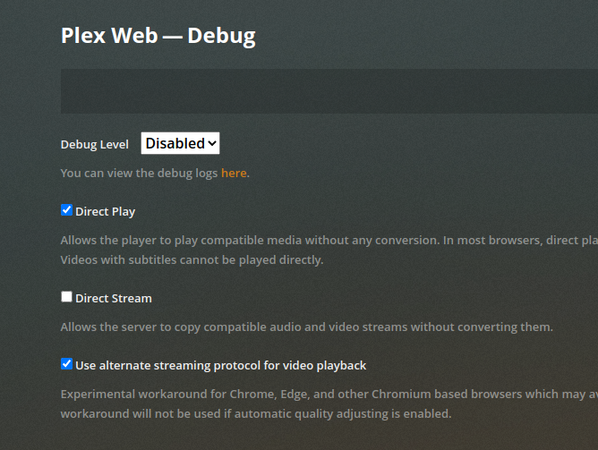

Did you try disabling "Direct Stream" from the Web > Debug options of the Plex Server?

What about trying the alternative stream method under Debug?
Maybe the following combination will help, and make sure to restart the Plex Server / jail after applying the options.
(It goes without saying, try also disabling Direct Play if the above method doesn't help.)

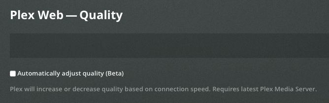

Some update, for a moment I thought this is related to automatic quality adjustment, but is not. I attached the video filmed from my Mac (played with IINA from SMB share) and my TV (Plex) as comparison. I no jittering also when I play the movie directly on app.plex.tv site, in my Safari browser. The funny part is that occurs only in the beginning of stream, on TV or maybe my eyes are getting used to? But is always at the exact same sequence, as you can see. I encode all my videos with Handbrake, so all settings are identical for all movies.
Now that I payed close attention, the important part is the jittering does not occur always, some videos have it, some don't? Streaming from Google Chrome browser on my TV with Cast functionality has one small jitter. While playing from my Mac has no jitters at all.
