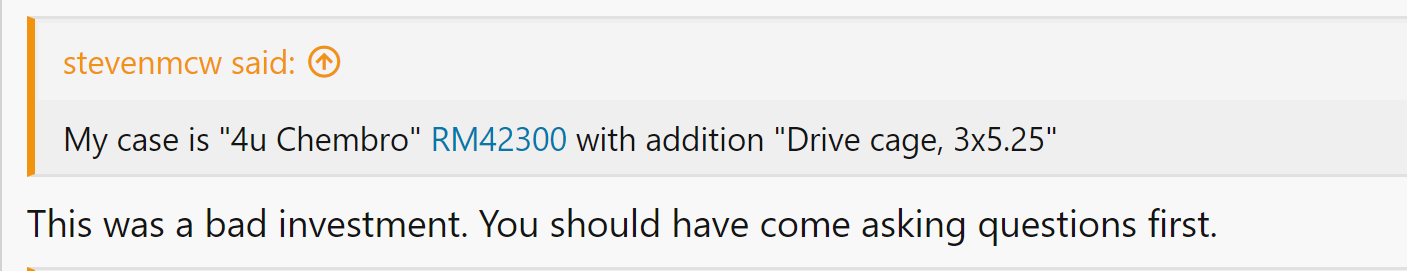

So, in looking around I see some reasonable reviews and no obvious problems with this 4U chassis. Then I read this from @Chris Moore...
So, here I am , Chris, asking that question :) You don't indicate why it is "a bad investment". Is this contextual to that specific post / scenario or is there some general problem with the case?
I have also looked at Rosewill but have read some reasonably strong opinions (not always good) about build quality, but still considering this,
By the way, I am back and forth between a rack mounted chassis and a regular PC case (looking at the Fractal Design Node 804). If I was only building a FreeNAS box I'd probably just go with the latter, but quite soon I plan to have another 24x7 box running Blue Iris. Therefore, I kind of like the idea of going with rack mounted solutions and putting them together in a rack.
As it was me he said this to i thought i would weigh in on this.
The build quality of the case is solid.
My Rack is only 600 mm deep so i needed something less than that .
I decided to build up the server gradually.
The amount of passable bays suited my needs
I decided on removable drive cage bays rather than builtin backplane so i can repurpose them at a later stage to one of my other rack mount cases.
since the original post i have not had a singe issue with the case.
It has the option to be used as regular PC using feet , so it would give you that flexibility if you decide on rack mounting later
Hope this help you out. if you have any additional question let me know and i try my best to help you out.
