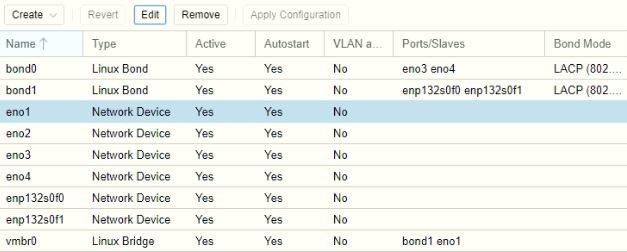

Bond1 is linked to TrueNAS, Kindly check if its correctly configured?

LACP is illusion, deception, of no benefit without switch redundancy, all of that at the cost of extra management, risks, problems, bugs, etc. As such, I never configured it in any of my TrueNAS server and I will never do. For that, I can not tell you if you did it right or not.
My only recommendation to you is that you should understand what LACP is (redundant layer 2 paths) and what it is not (not adding the bandwidth of multiple NIC). Once you properly understood that, you will realize that it is of no benefit to you and you will just discard it.
Should you have 2 switches, one NIC in each server plugged in each switch plus a link between these switches, then LACP would offer you network redundancy. For that to work, you will need STP to prevent network loops, 2 smart switches and not just switches for home network, and even more. It will then protect you against the failure of a single network component. Just know that these network components are the most reliable components in your global setup. It is non-sense to increase their already very high availability when you do not have server-level redundancy (single Proxmox server, single TrueNAS server), no data-level redundancy (perfect backups, multiple copies, ...) or application-level redundancy.
Just forget about LACP....

if not Please tell me how to link bond1 to TrueNAS. i am having a great trouble configuring this.
I would start with a single link. Once you are getting around 95% of the available hardware speed (950Mbps on a gigabit link), then you can feel good that the network config is solid. As several others have noted, you are never going to get more than the speed of a single link with a LAGG interfaces. It load balances to give you effective bandwidth of multiple physical links, but no one conversation will get more than the speed of a single link.
