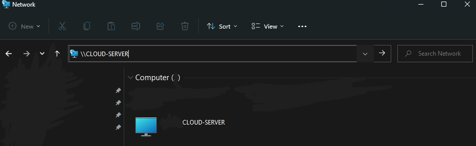

I fixed the problem, when you go to windows files explorer-network/network sharing then in the the bar left of the search bar you tybe in \\{Server Name} and hit enter than it will save your server as the server name you set it as in Global Configuration, so global configuration name is the server name you have to type after the 2 \\ and must be typed exactly like my example, my server host name is CLOUD-SERVER so i must type \\CLOUD-SERVER and hit enter and then the server will save as the name you want it, must do it at Network/Network sharing part of file explorer on windows only
I blurred out some stuff for safety reasons so that my name or parents names does not get leaked or go public
