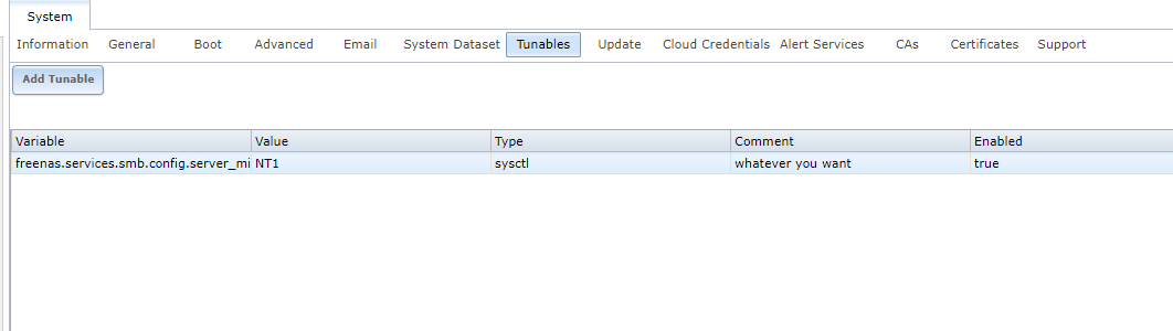

bald
Feb 21, 2018
4
this work on my nas and dune hd tv-301
