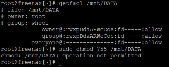

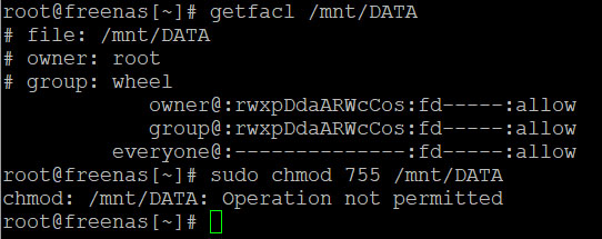

chmod 755 /mnt/nas01-pool01
Hey!
I have the same problem, but for me I get an error message (with or without sudo): Operation not permitted
Is there a solution for this?
Thanks for the answer!
KrisBee
Neophyte Sage
Mar 20, 2017
1,219
@snbence You don't need the "sudo" when you are already root, but that command will not fix your problem. It looks like you choose to share your entire pool rather than separate datasets within the pool and share one or more dataset. IIRC the last upgrade dis-allows changing the permissions and/or ACL on the top-level of the pool via the WEBUI, in your case mounted at /mnt/DATA. The chmod will not work at the CLI because by treating your entire pool as "windows type" share, the acltype property has been set to restricted.
Start a new thread and ask @anodos for the correct commands to sort this out. For future reference, this starter guide is still useful:https://www.truenas.com/community/threads/how-to-set-up-windows-smb-shares-on-freenas.83376/

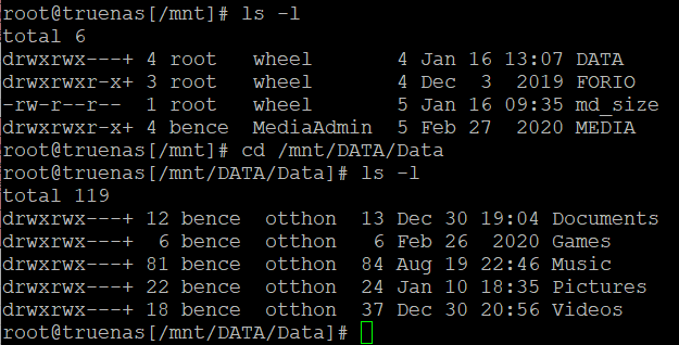

Hi, thanks for the answer!
Actually I do not share the root dataset, I have datasets inside it, but SMB still not works because (if I understand right) the root dataset "DATA" is not shared for Other or All, only for Owner, and Group. So no matter what permission I set in the child datasets it wont work with the username "bence". I solwed it with putting the user "bence" into the "wheel" group so now I am able to connect to the "Data" dataset with SMB.
But still the main goal would be to set all of my pools root datasets permissions the same because now all three are different.
