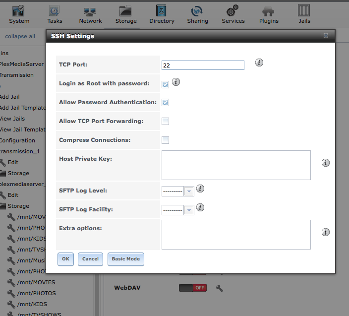

Following Jailer's advice, I've checked the SSH Settings, and all appropriate boxes were already checked. (see image)
This will allow you to log in using your root account to upload the file using an SFTP connection.
Could you provide stepped instructions to accomplish this?

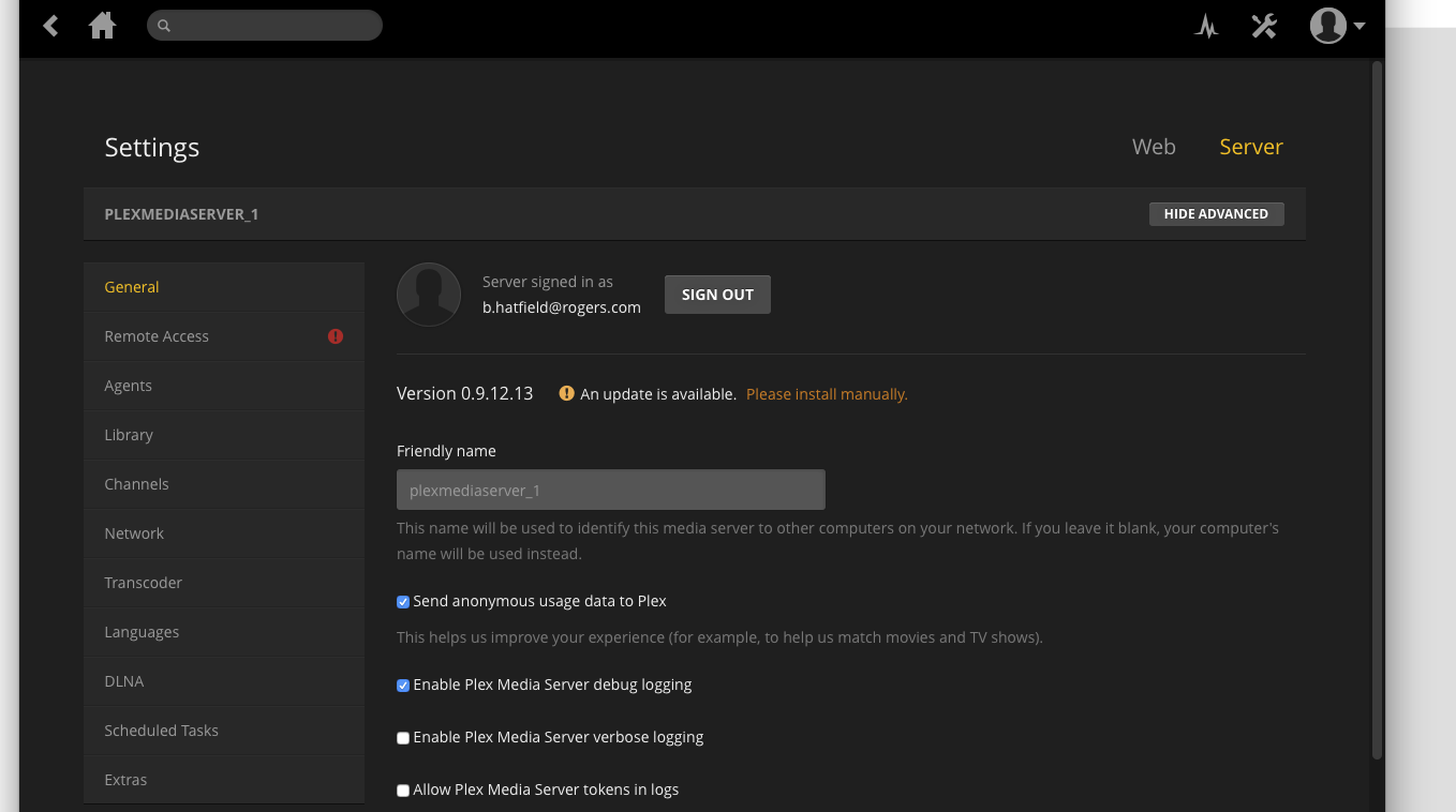

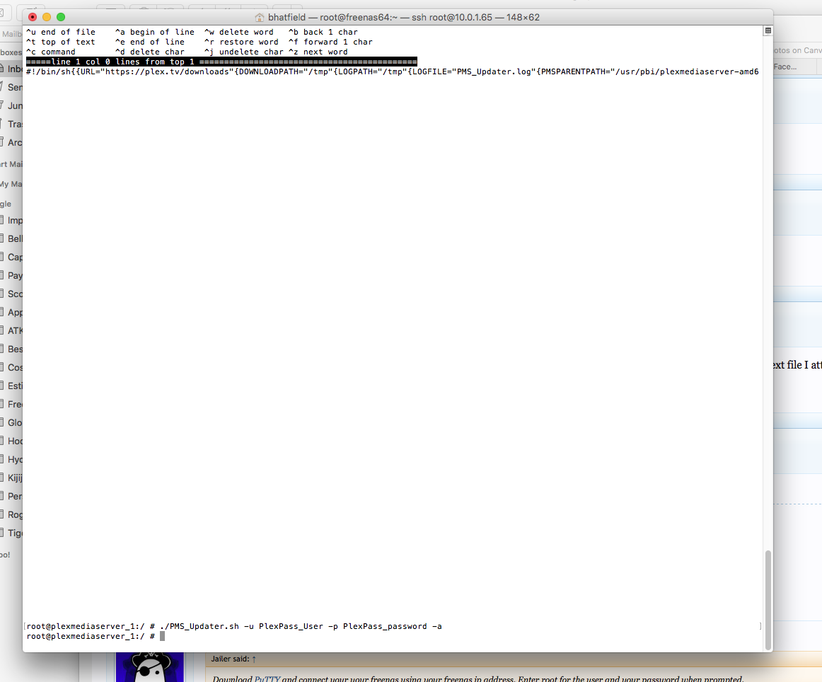

This is a screen of my terminal program, following the commands suggested. As soon as I entered the last command, the next command line came up. There was no evidence of anything working in the background, or your statement that I should see Done repeatedly. Also, the Server settings in the Plex GUI show update still available.

1. you might want to edit your email address out of your screenshots ;)

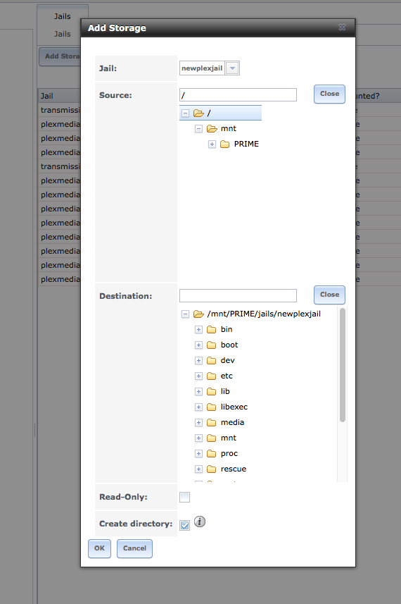

add your storage to point to your media files
I made it all the way to this point, but when I try to add storage (see image) and hit OK, it doesn't show up under jail storage.

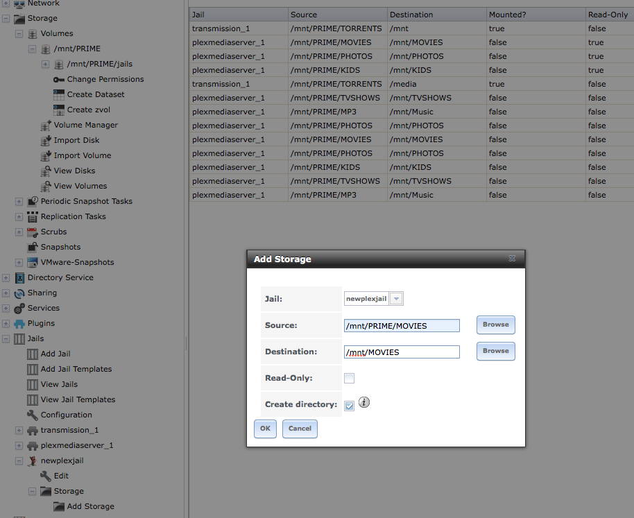

your screenshot shows a whole lot of duplicate storage mounts. I am not sure what you have going on there. does /mnt/MOVIES exist inside the jail? I usually mount to /media/<mediatype> inside my jails.
Plex data is the library, the watched status, etc. If you are not concerned about that, then you don't need to do anything.
One thing that looks odd is that you do not appear to have datasets for any of your media. Do you just run everything from folders within your main volume?

I have to admit that my son initially installed Freenas for me, as I'm pretty well a newbie to all this (as you no doubt can tell:))
Is there any screen shot I can attach which would answer your question?
I'm not sure what datasets are, but the existing Plex Plugin seems to work fine (except that it needs to be updated, which is where my whole problem started in the first place.
I assume I do. It seems to work.
If you could walk me thru the completion of the Add Storage box (refer image), I'd appreciate it.
